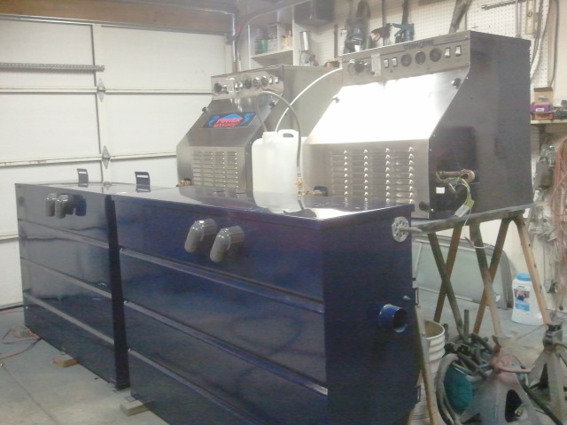

if you're gonna build a stainless one..
find a co with a large brake and make it all outta one piece.withe the strengthening breaks in the side like these...
