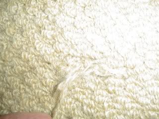

Came accross this problem today where the seam on a good quality wool looped pile was unravelling in places. Customer had tied the strands together to stop it moving further but beneath the loose threads is bare backing in some parts. What can be done with this - is it a case of what you call re-tufting? There are several large remnants/offcuts available for this 10 year old carpet.
This is happening in several places on two seams, the worst is the one in the pic.

If the carpeting has a primary and secondary backing...I would attempt the repair the same way that I would on a loop pile nylon or olefin...by pile grafting or a bonded insert. Seeing that this is a wool carpeting, I am imagining that it probably has a tertiary backing as well which would be even more suited to a pile grafting as opposed to the bonded insert.
The only difference is that with a
Pile Graft - you are bonding the insert to the secondary backing of the existing carpeting (In order to create this, you cut the same way that you would as if you were going to perform a bonded insert; however, very carefully only cut through the primary backing of the carpeting.)
Bonded Insert - You are bonding two seperate pieces of carpeting together

Thanks Mr Ksokalski. I think I'll keep this one until I have some more experience, they're a good customer I've picked up and will be doing a bit for them in future.
I'm almost ready to get out there and do bonded inserts with the tools I have and practice I've been doing but not at all experienced in grafting which I think would be the best bet on this one?

OK, I'm confident I can repair this - if I go for the bonded insert type repair, will I need to release the seam first? I've done this before using a steamer to soften the glue. Otherwise just cut out a small section including the seam on the backing? Or are you recommending grafting? The donor carpet available has been in use around the house and is almost as worn as the carpet itself.

Heath, definitely do a graft. With a really sharp stanley knife (nice sharp point) slice in and cut the yarn through the primary backing at each end clear of the pull so that you can pull the loose yarn out and leave a nice tight end on there. With a nice sharp pair of duck bills, cut out the remaining primary backing and scratch out any blobs of latex that will hold your donor up.
Determine the nap of both the carpet and the donor, and MARK IT on the back of your donor. Now cut along and cut off the necessary number of rows by slightly longer than the section to repair.
Attempt to lay it in there and see how high it sits. If it sits right height wise, leave it at that, if it's sitting high, attempt to pull the secondary backing off. It'll be stronger if you can leave it there but no use having it sitting high so if in doubt, I'll rip it off. Take care and you should be fine.
I then usually start at the end where the existing nap is laying over into your repair area and work away from that point. With your glue gun really HOT (don't be tempted to start till it's hot as the glue will cool too quickly before you can do the necessary manipulation of the donor.) Only glue a small section to start with, maybe up to an inch and then bed the donor in and make sure you're happy with the result before you carry on.
Depending on how long the donor piece is, I tend to wait till I'm within an inch of the end before I trim the total length. So just progress along at small sections at a time.
Having an awl is great too because it really helps in bedding those edges down into the glue.
See how you get on and let us know. With time on your side, simulate such a repair on an offcut and see how you go first.
Retufting is NOT an option where you don't have a complete backing in place or over jointing tape. Because the damage is along a seam, the original problem is that they've cut too close to the base of the tufts AND not seam sealed so you don't have enough material to tuft effectively into. (I'm sure there will be guys out there that do, so this is purely my observation)

I have to agree the grafting would be the logical repair, IMO, due to being at the seam as well. What great outlines of information! You should copy and save all of this. Once you do it you will feel great about your next one.
