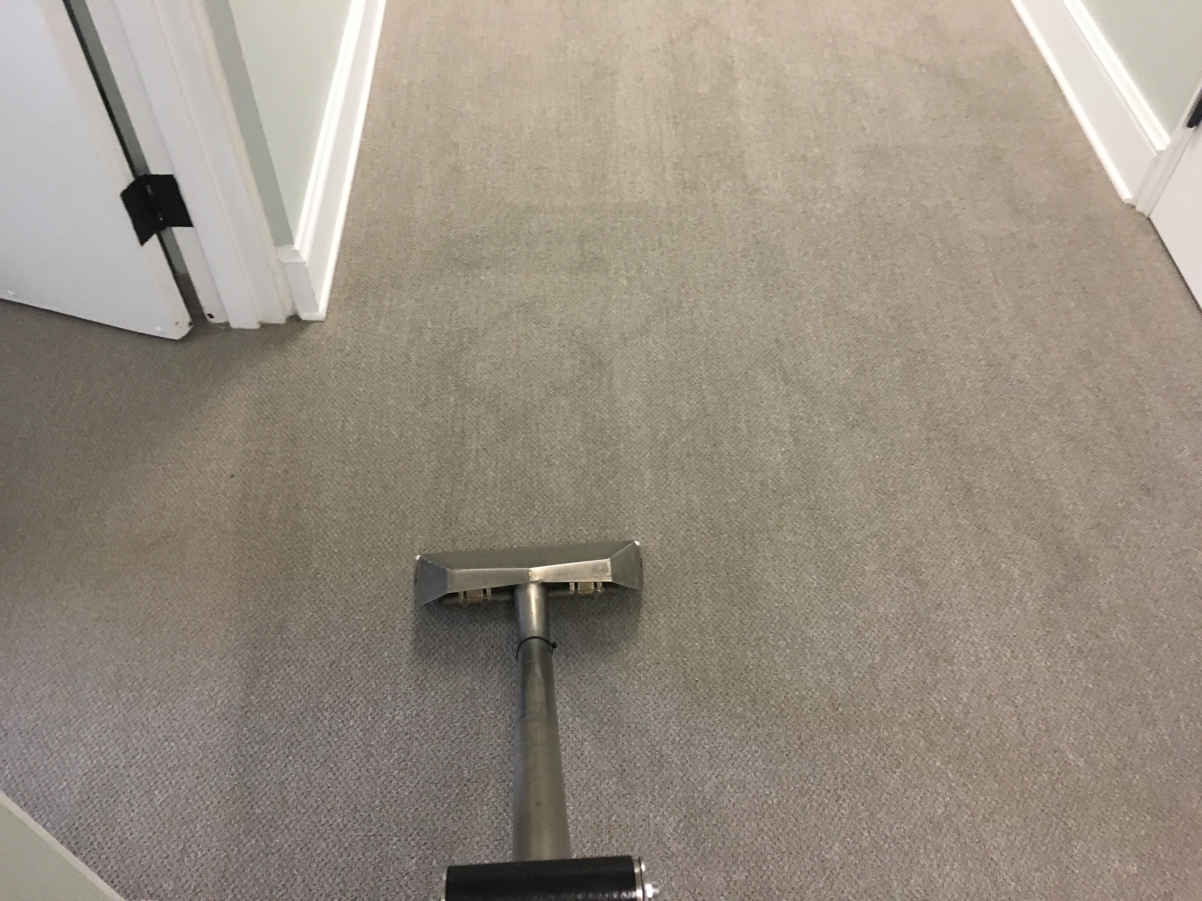

It was just some glue residue and improper cleaning by the staff. I'm back to do another building waiting to get in. Its on Notre Dame campus and security is tight here.
Haven't seen my results yet on the first building yet.
steve_64
Aug 11, 2012
13,372
Had some wick back issue on first building. Was told the carpet was cleaned 5 times alread. I had used code red in the 175 and a grey pad of ricks then wander it with p rochem all fiber rinse.
Today we wanded with just the rinse because I forgot a vacuum then used bonnets and the 175 with Releasit. Hit the first building again with the buffer and Releasit.
