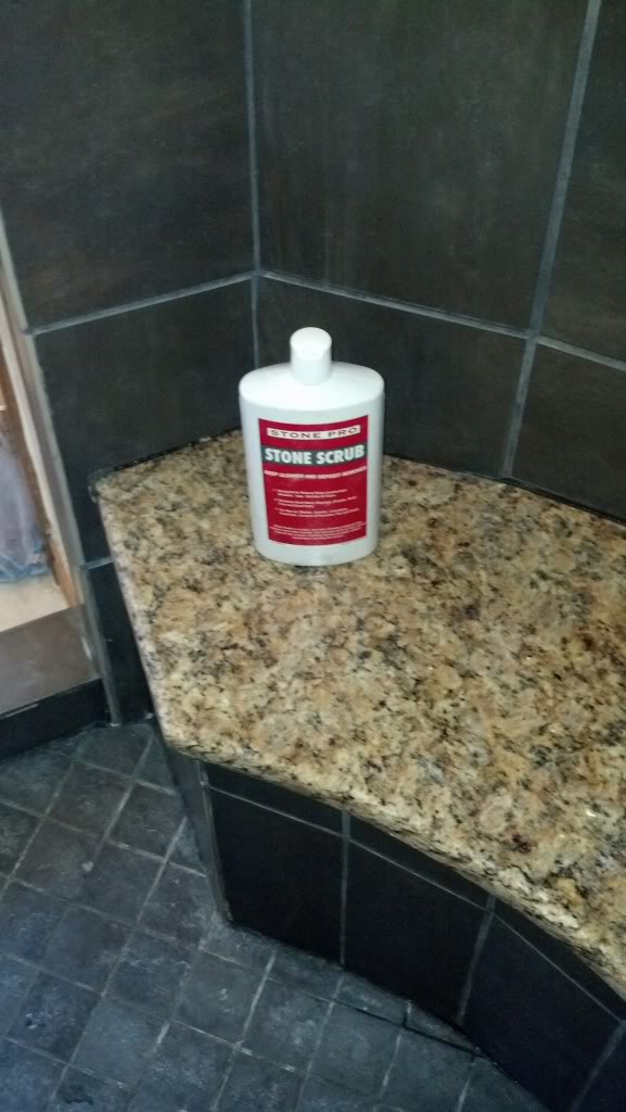

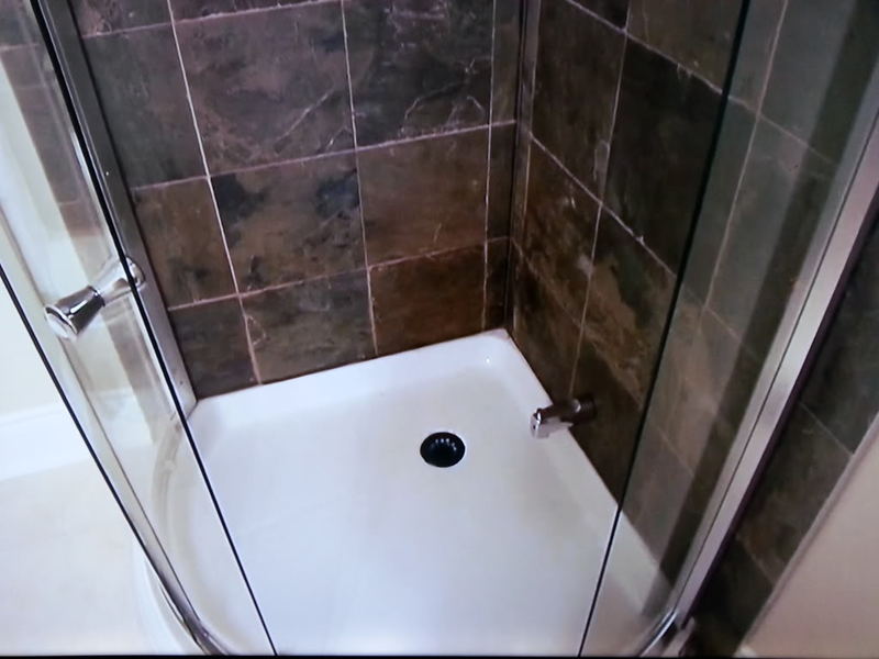

Has anyone used this on a slate shower? I would love to hear about it or see some pics. We don't get many of them - but that has one of few things that I have never had success on.

I like this Slate shower..

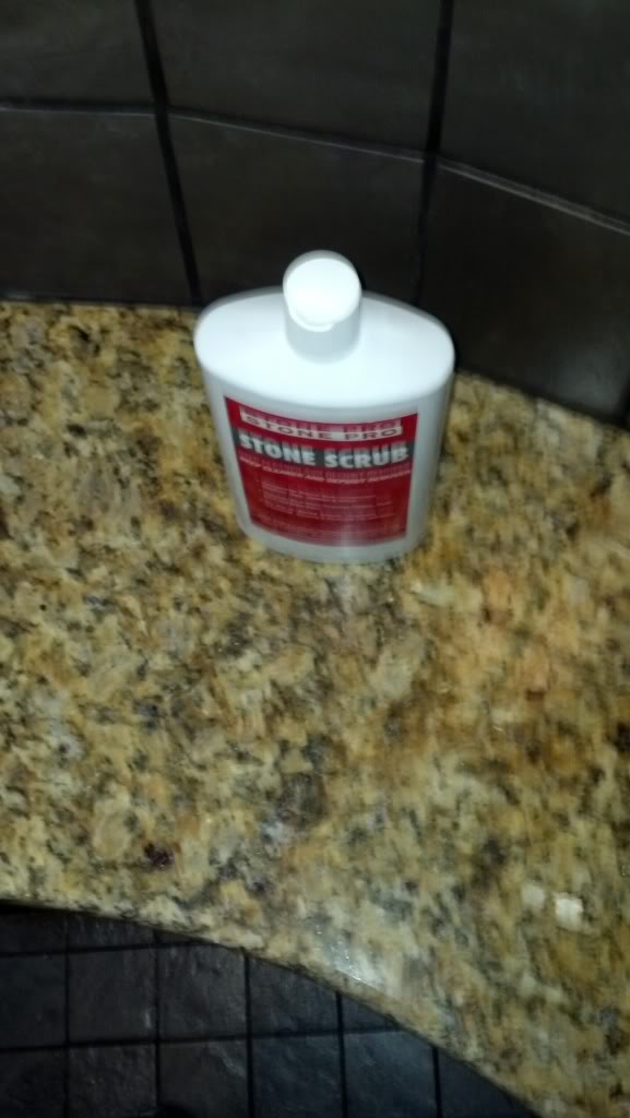

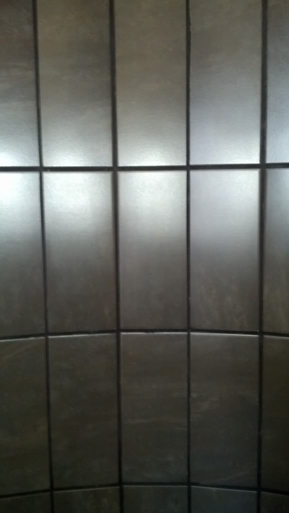

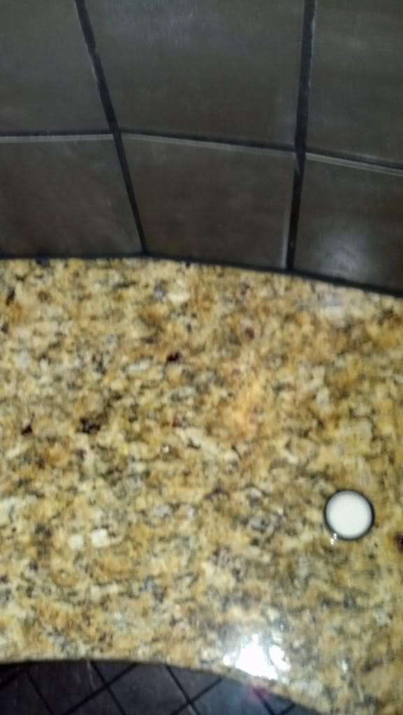

Stone pros stuff on the granite with the Mikita and a horse hair pad, a cream cleaner 403 from husky and the Mikita for the walls and some acid for the floor.
then a couple of different sealers. Call if you want more info.
