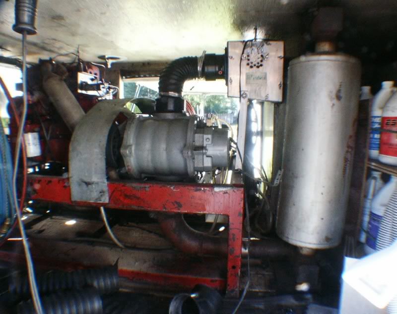

Jim,
My V had a similar install to the above picture. In other words, I attached an additional silencer to the included silencer from vortex. There was no measurable back pressure. As far as sound goes, it will be quieter in certain situations by a lot. Standing directly in front of it for example. In other areas it's not as effective - town homes.
If you are thinking of bypassing the silencer system in total - I don't think I would do it. I think it would be louder. In addition is nice. But alone, I think you would be disappointed.
