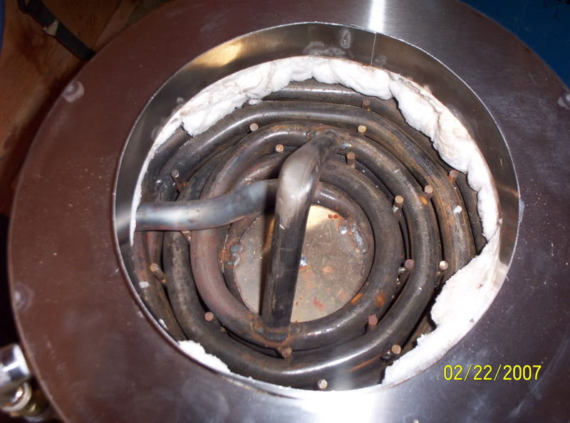

this is the top, it has that plate welded there cuz it can and does shoot some flame out the top..

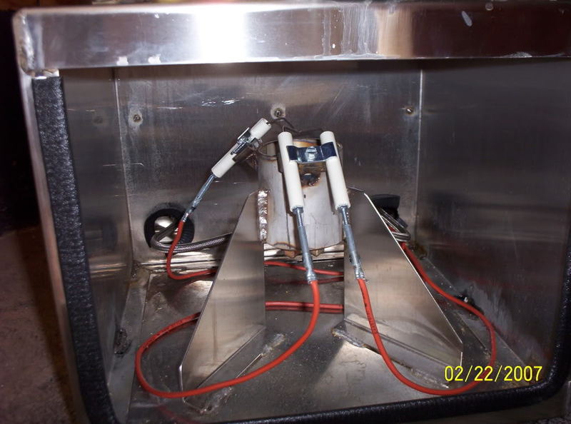

picture of the burner...unlike little giants with multiple little jets this has to larger in there 1 for 1st stage(180k BTU) 2nd for 2nd stage(360k BTU). it looks like a mini hot air balloon flame
picture of the 2 toggle switches, the flow sensor and inlet water, propane inlet on the bottom(wished it was else where, to easy to kick) also they send a regulator and a psi adjuster for the propane flow...

That is a trip how the burner jet is single for lower and dual for higher, is the flame pattern pretty even across the coil, or do you kinda depend on the little center plate to "hold back" the tower of fire?
Can you say heat reflective trailer roof material?
It looks like it requires a 110v circuit to fire?
Explain that "flow switch" doohicky?
My only concern with "black pipe" gas pipe coils is....can they degrade and rust or anything like that?
I noticed they charge a LOT more for a stainless coil, what size is that pipe? and how many feet of it wrapped there?

it appears to be fairly even, where i have it set while i was testing, i couldn't see in the back(wall)

it is schedule 80 black pipe, it'll take quiet some time to rust through...and yes YOU MUST PURGE before you clean..you could probably drain it after the days jobs and not have as much...
I think he told me 200' coiled in there..i don't remember that total number...i know when i first hooked it up, it took a little while to get flow out the other side. I think its either 3/8 or 1/2"

Steamway made formula A or Formula A for reason of guys running steel heating cores...and the corrosion factor.
It keeps them from rusting up..and no need to purge the system was another selling point too.
