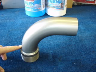

Here is a GG 2.5" Reducer:

One final note for Dale, you don't actually "need" any cuffs, the machined reducer I posted above can be inserted directly into the raw vacuum hose, this applies to both hose diameters, it would be a semi-permanent connection and very secure, it would also be very compact and hardly even visible.

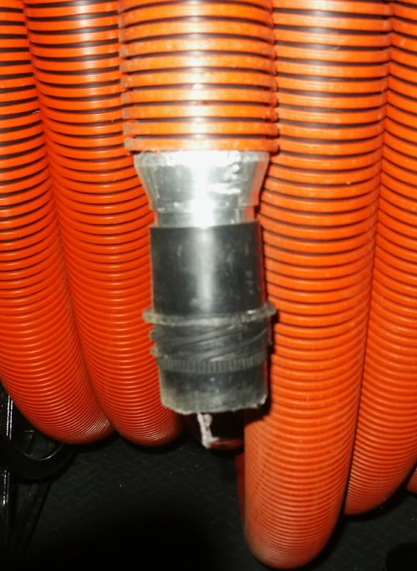

A simple reducer for 2.5 to 2, as per Greenie's instructions.
take Greenies aluminum reducer and jam it into the 2.5 hose
take the 2" coolcuff adaptor and jam it onto the reducer
It ain't coming off!!
Oh, when I say jam, I mean hammer! It took a fair bit of effort to fit it together. But it works great.

Or you can soak the hose end in a bowl of boiling water for a couple of minutes and simply slide the reducer into the plastic hose with little effort. Like the way we would put hose connectors into cuffs when it's 3 degrees outside. Praise Allah for coolcuffs.
