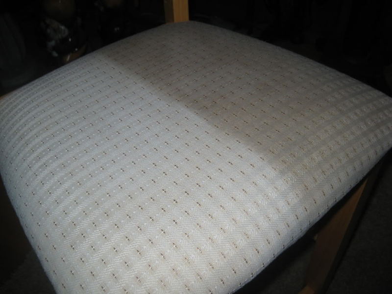

Here's one(actually 6 chairs) I did today.. At least ten years old never cleaned. :D

if all your furn is fabric like that chair, slurry won't hurt it.
As mentioned, its the finer fabrics where you'll run into challenges
