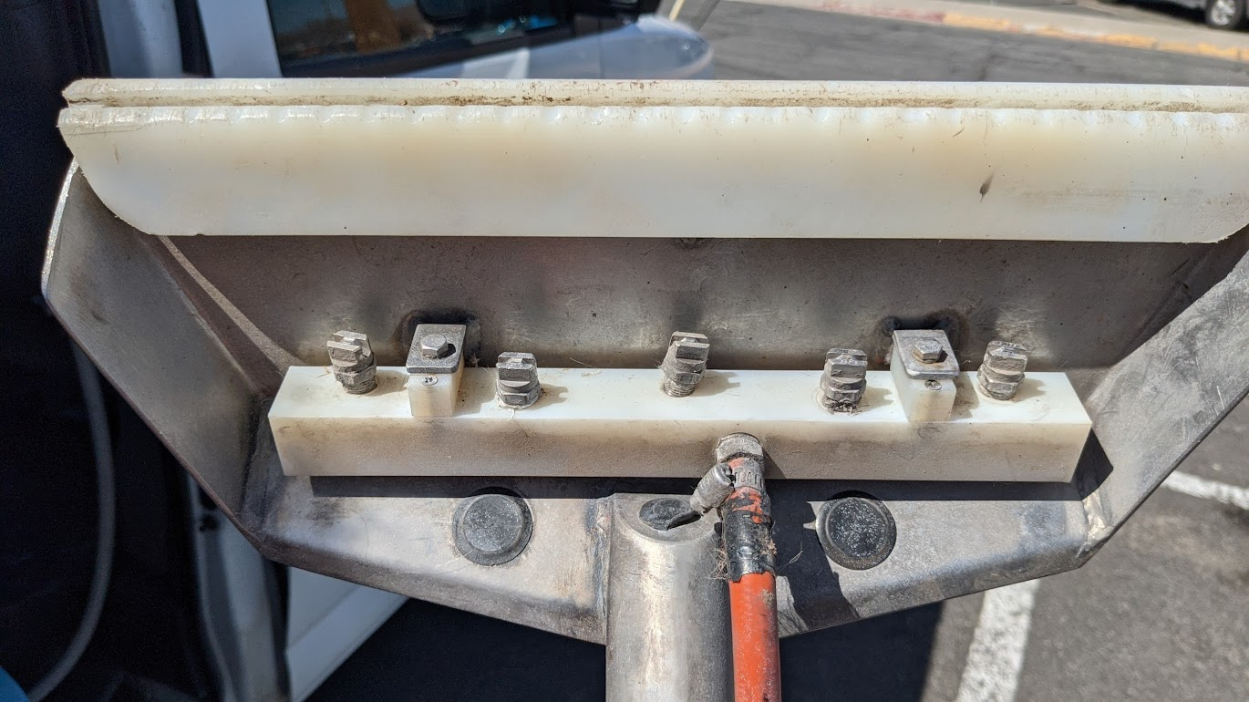

well howdie-doo
plastic manifold, center jet cross threaded and a band clamp on the manifold supply line.
nice....
117,225
the three attic access ports tells me there's some weld spittle going on in thar.
117,225
I had a tubeless head for a while to redesign the glide for, I should have kept it as a paperweight.
The inside vac manifold was so....perfect.

One of the worst versions of a wand ever..3 jet was by far the best of there versions...

The nylon blocks were a vast improvement over the original aluminum ones that would blow a hole out directly opposite where the supply line entered.
You did have to be careful to not cross thread a jet though.
