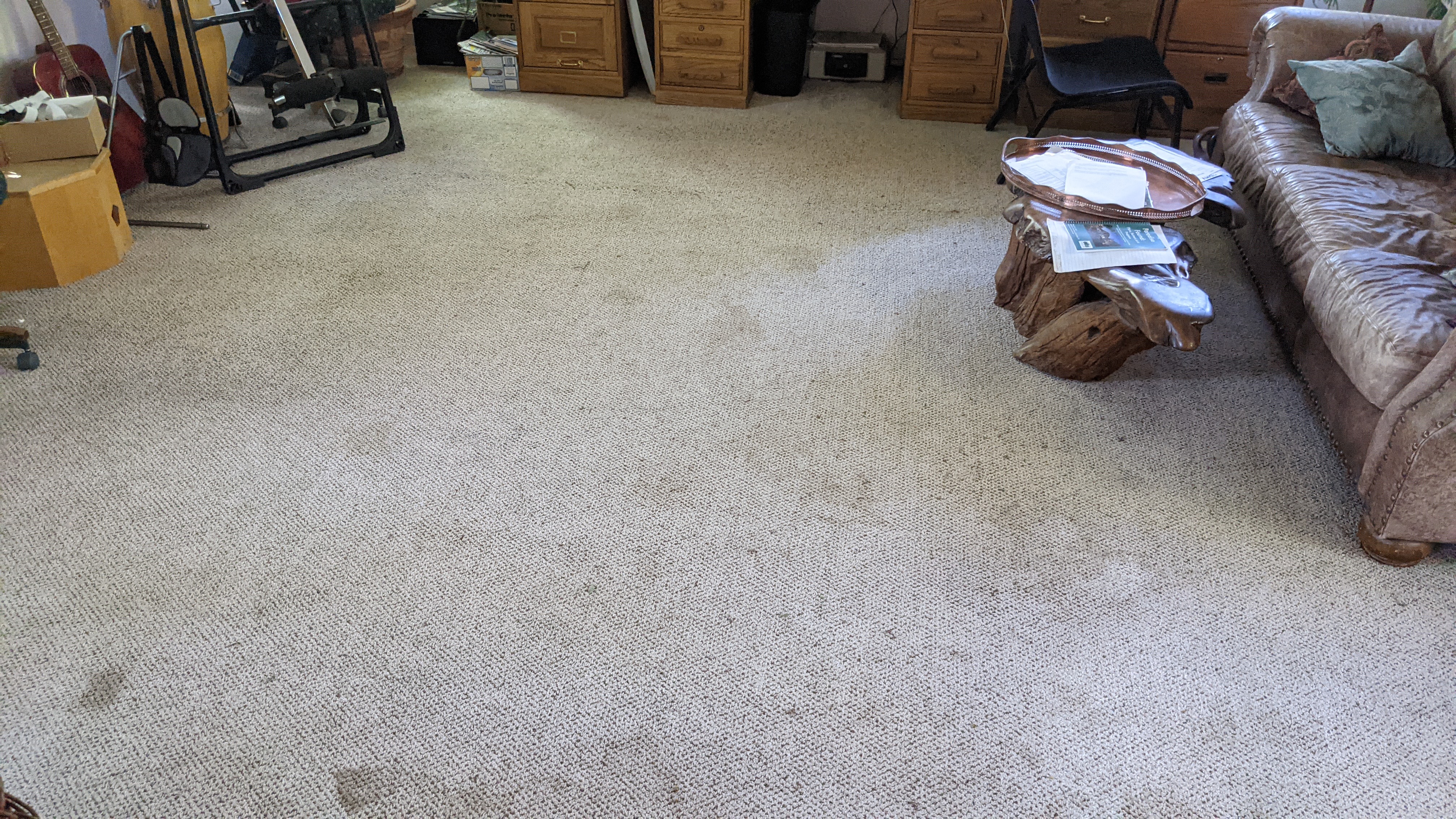

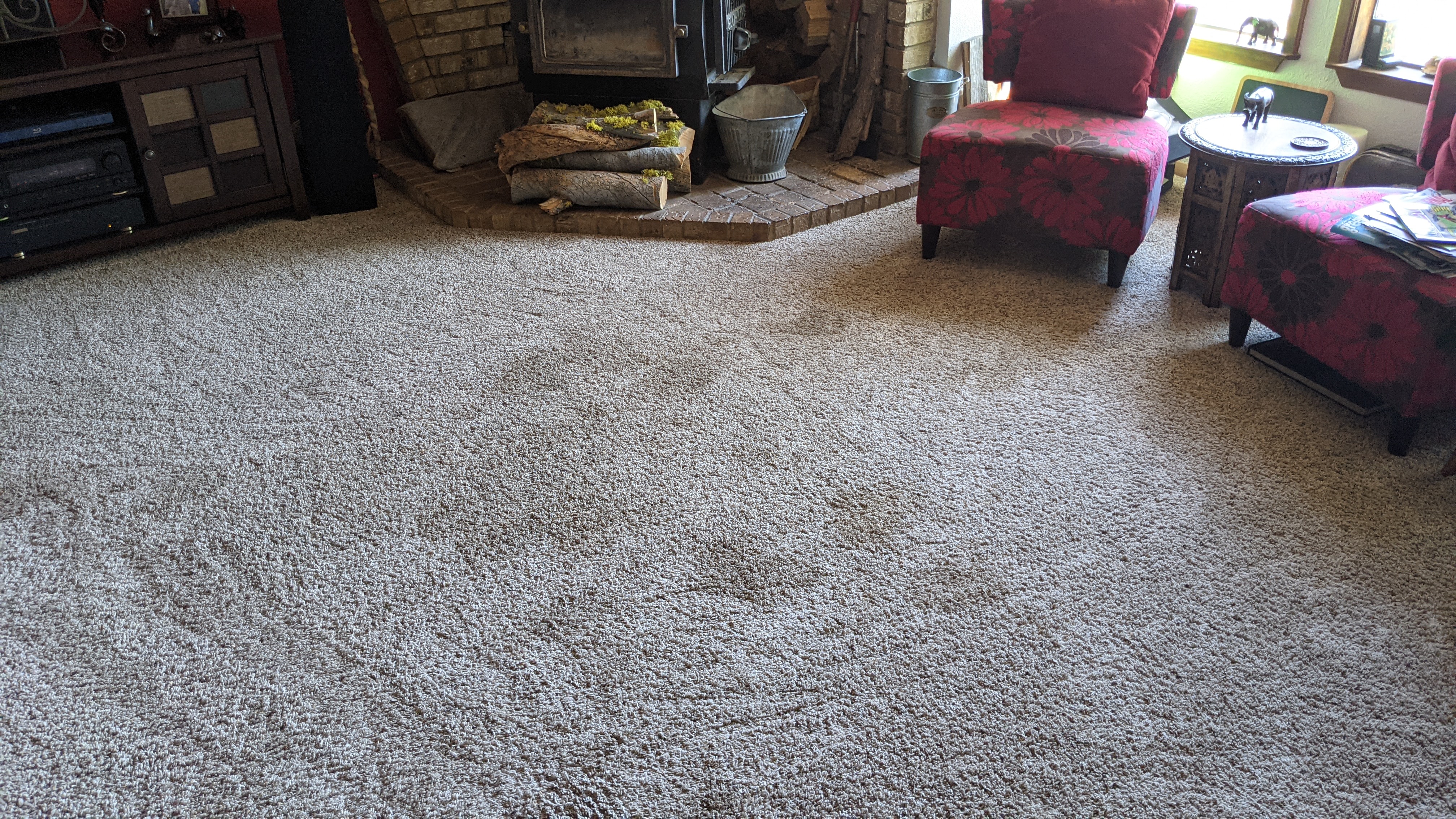

9 month old Saiger dog
Been cleaned three times now by local hot water extraction guy who makes all the spots go away but they reappear within 5 days so I am the fourth try upon recommendation by their daughter who's used me many times..
What are your expert eyes telling you what's really going on and what would be your fix for the problem
117,254
The first picture the carpet looks beat up and worn out. Possible replacement candidate.
The second picture looks like Jim mentioned, a resoiling issue. Something isn't rinsed or neutralized and is attracting soil.
Reactions: bob vawter
28,266
Prespray spots heavy with a non detergent acid such as Ultrachem Labs Neutralizer. Let dwell 10 minutes then rinse with a neutral pH extraction detergent. Vacuum extra well, maybe put a couple of dri-pods on it.

All I can tell you is what I would do if I happened upon that job and the only info I had was the dumbass info you gave us.
I’d pretreat with Soap Daddy’s Bio-8 and Rinse with my 360i.
Most likely it would fix the problem.
However, since this is most likely another shill thread to promote pad cleaning and Tops prespray products, I’ll leave you to your sales and expect you’ll indicate my approach is all wrong.

I presprayed with Silver Solution and rinsed with AFR.
the Dev window told me where to spend more time rinsing.
They're Jdubs so I'm sure ill hear about it if it wicks, again
whatever was spilled there isn't getting flushed out (or can't be flushed out normally due to beyond the backing)
sell 'em some poker chips .
so when the pre-spray makes them disapear, they'll know where more flush is needed
