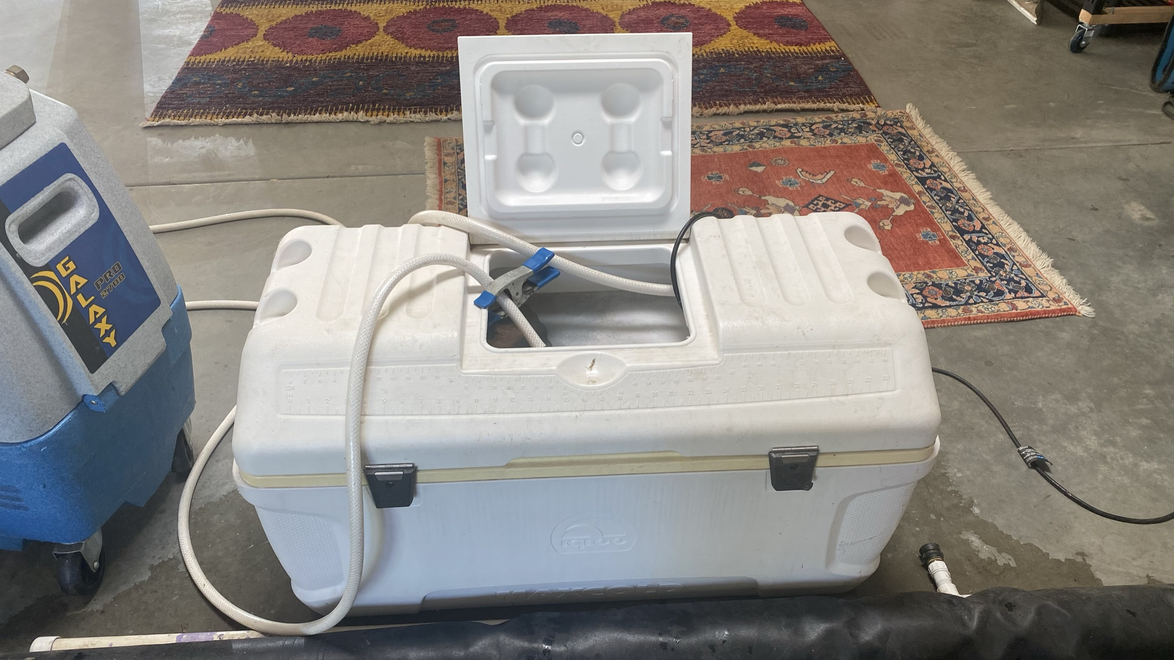

We'll, I'll admit. I'm working on a shoestring budget but I'm doing the best I can with what I have until I can afford better and bigger equipment. So don't bash me too much for my hillbilly methods. When I started my carpet cleaning business I started with my EDIC porty and a beat up AT&T van doing $99 whole house specials. I now have over 2k customers and the phone just keeps ringing. My rug business is slowly gaining traction. As I get more rugs, I'm meeting more and more people with nothing but hardwood floors and wool area rugs.
Anyway, I have a bunch of rugs in the shop and they are all urine soaked. Not sure how I'll do the bigger rugs but for now I'm using a large cooler to soak the smaller rugs in Rug Restorer for 8 hours. Inside the cooler I installed a submersible pump to recirculate the water. I need to do what @Joe Appleby does and make some large tanks out of some pipes. Joe, Any chance you can send me some pics of your soaking tanks and maybe let me know where you got those large pipes? I thought I took some pics when I was in your shop for @Jim Pemberton's class but I can't seem to find them. My cell is 530-355-3363. It would be much appreciated.
