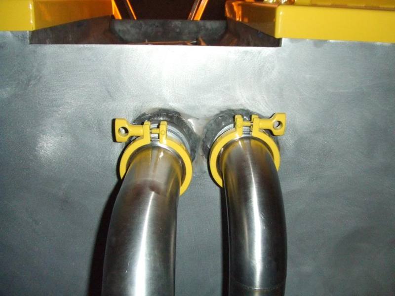

here is a pic. of the filter box plumbed into the waste tank.

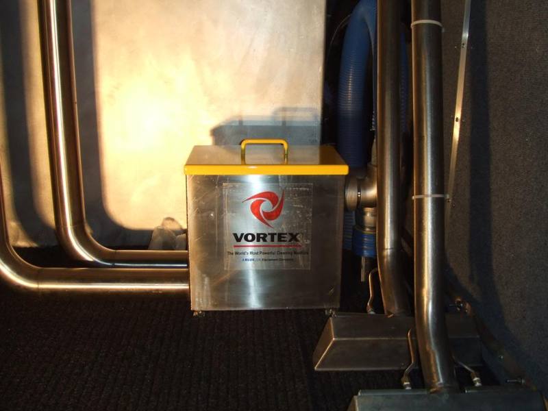

the filter box.
The QD to waste tank.
