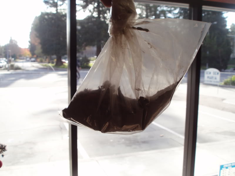

I used mine for the first time yesterday.
2 by 7 wool runner. Didn't really look that soiled at all.
We Sanitaired it front and back then ran the Rug Badger over it for about 3 minutes.
So much dry soil came out the first time that I swept it up and did it again...
In the end this came out of a "clean rug"..

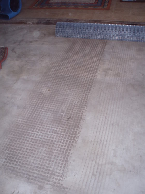

Yea it's pretty amazing.
When we first got our we pulled a few rugs off the clean rack and hit them with the badger and showed the guys how despite being cleaned by us there was still soil trapped in the rug.

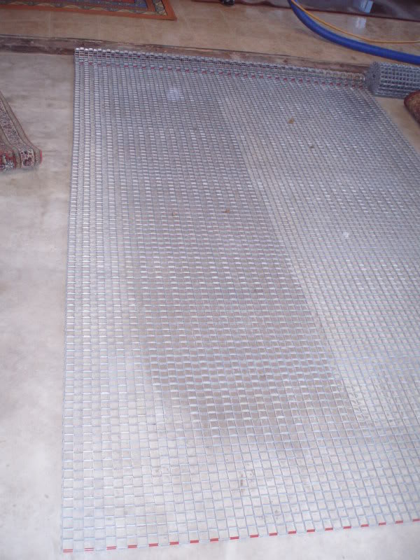

Right next to our cement pit we have a compressed air fitting, soft water, a drain for my Steam Way and the full sized Badger grids.
