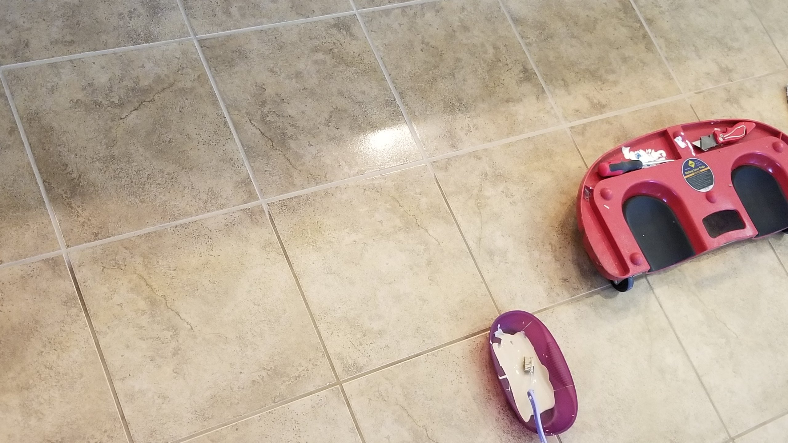

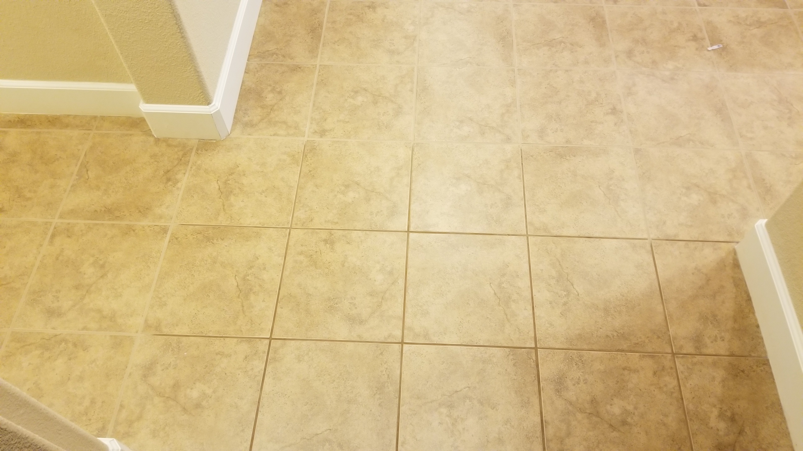

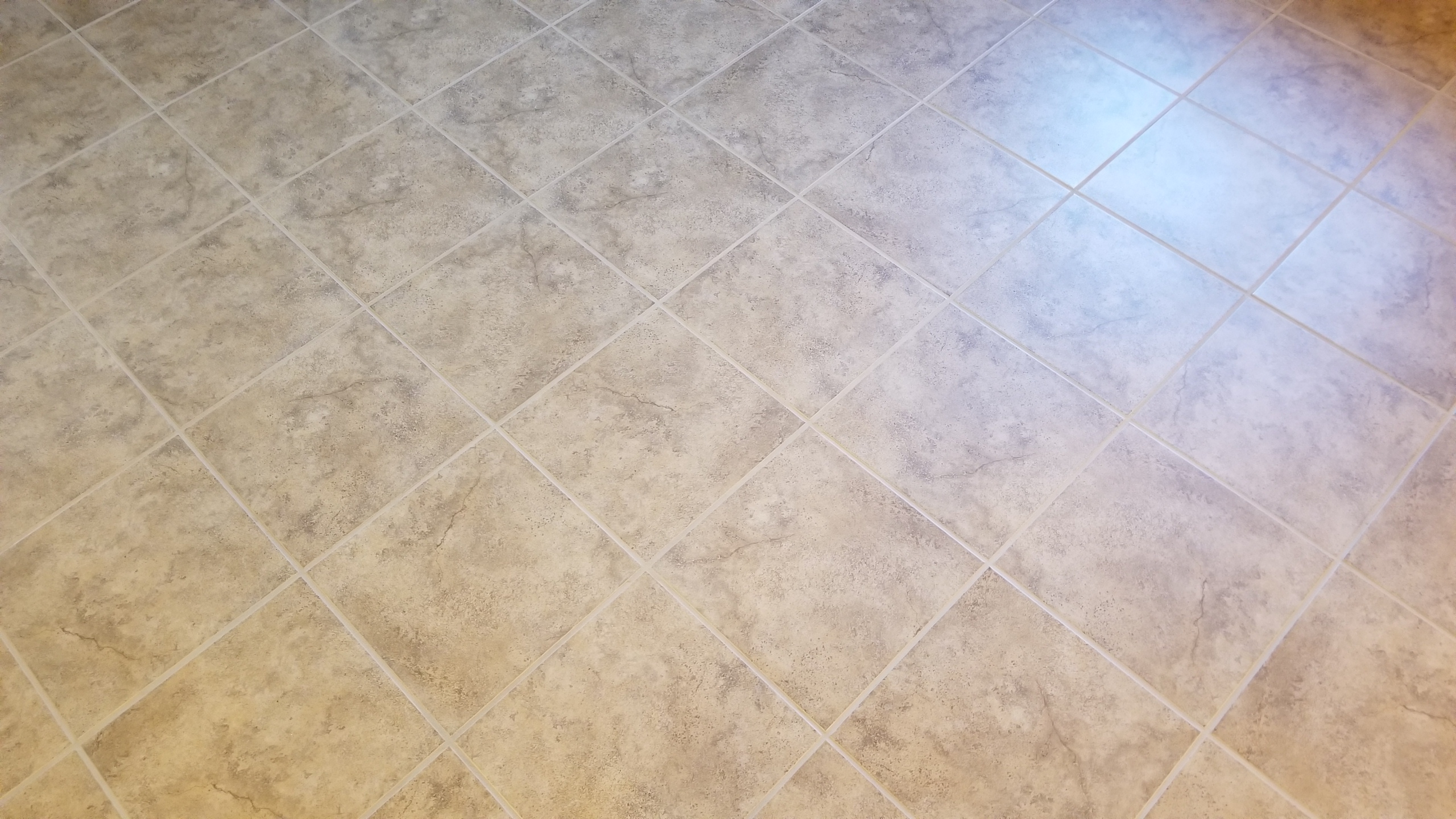

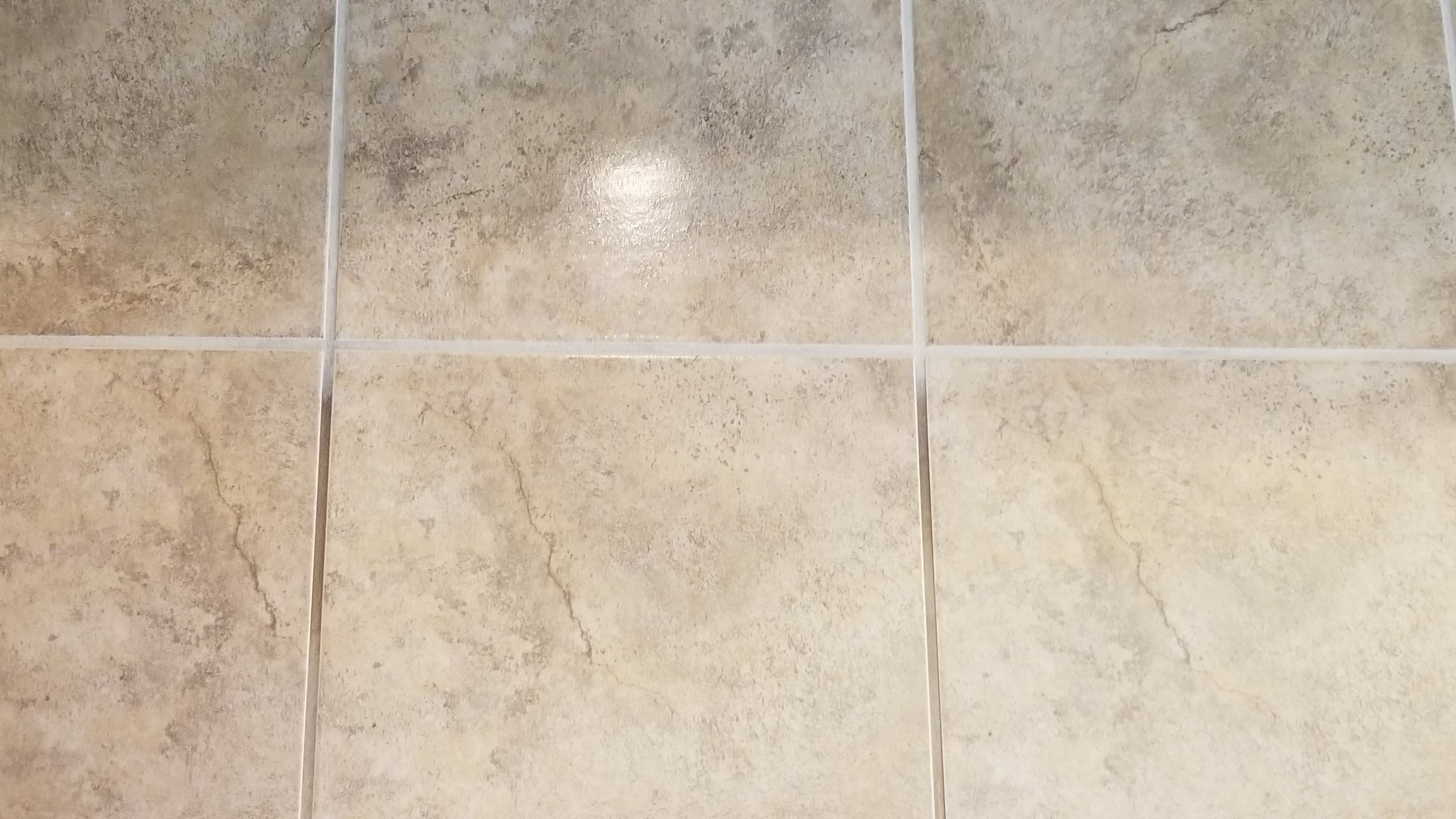

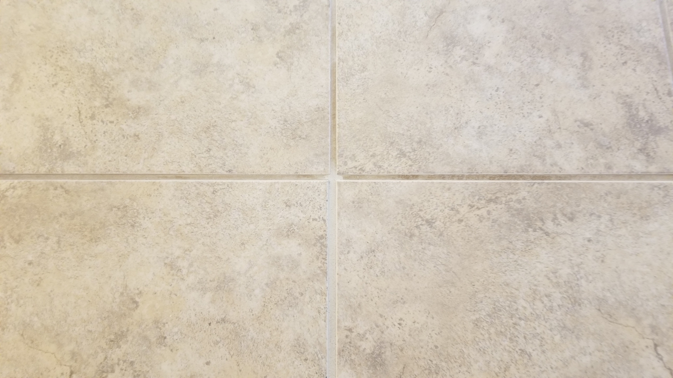

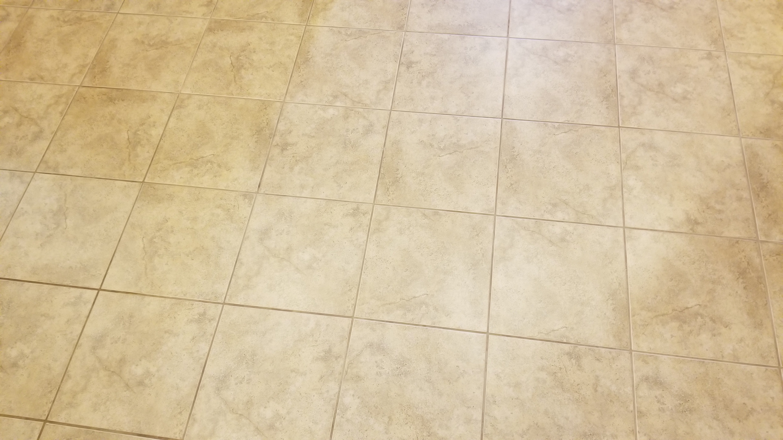

View attachment 78076 View attachment 78077 View attachment 78078 View attachment 78079 View attachment 78080 View attachment 78081

Looks killer. Surprised you entertained the thought of skim coating some acrylic stuff rather than just tackling with a grout stain from the beginning. In the end, it worked out for you because you built that relationship with the old man. He'll never call another floor cleaner again. I bet those 5 days really pays off for you.
117,376
I only wanted to skim coat over some hairline cracks..
I wonder who makes the Polyblend Colorseal. Its exactly like Grout Perfect
My son went to a job that we GP'd close to ten years ago lat week. He was impressed with how well it held up.
This repair caught me by surprise at the last minute... it was an old fix where the handyman didn't fortify the grout..
