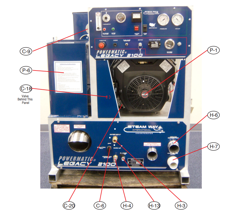

I have a steamway legacy 2100. I am having problems with no water pressure or very low. It use to have a little . The pressure gauge has no activity either don't know if broke or just no pressure. Any ideas? Please help.

Easiest way to check that is plug your fresh water garden hose directly into the plenum (the brass bar near the rear left side of unit with several hoses plugged into it)
Follow the hose from the water box to the plenum, Unplug it and direct connect your fresh water hose there.
Turn on the water and look for drips.
If none, you'll know no air leaks from that side of plenum to pump.
With hose still connected and water on, now fire up the unit and turn on the pump.
If pump pressurizes, you have an air leak upstream of plenum
those are a couple simple things to check first.

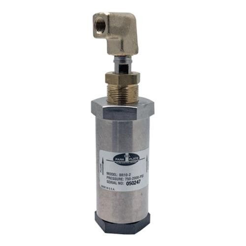

His TM has two Paraplate regulators.
One gets adjusted for med pressure the other for hi-pressure.
set them to the PSI you want for med and high, then twist a lever to divert to one or the other.
they're a very durable regulator
Two bad at the same time would be more rare than getting struck by lighting ..twice
