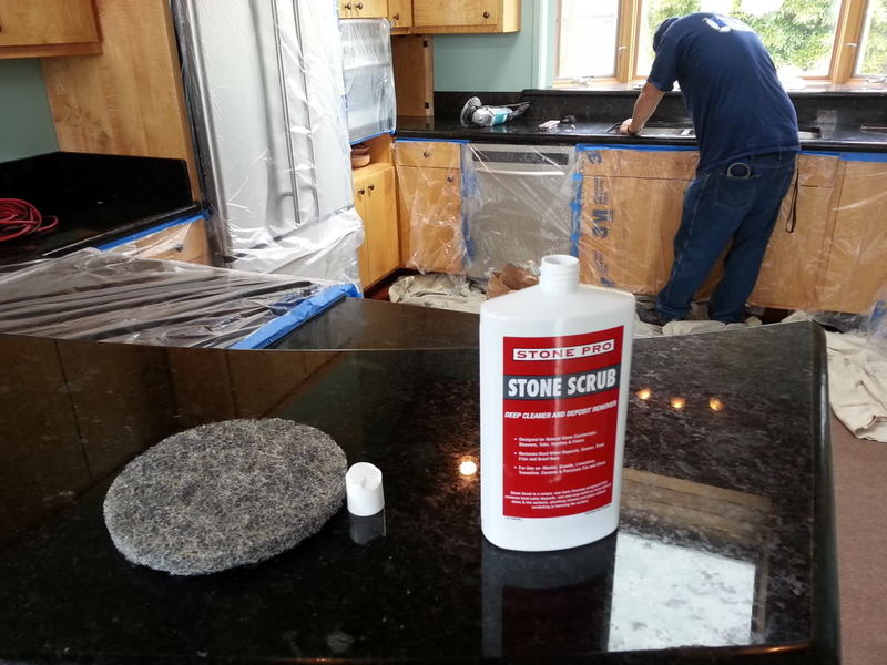

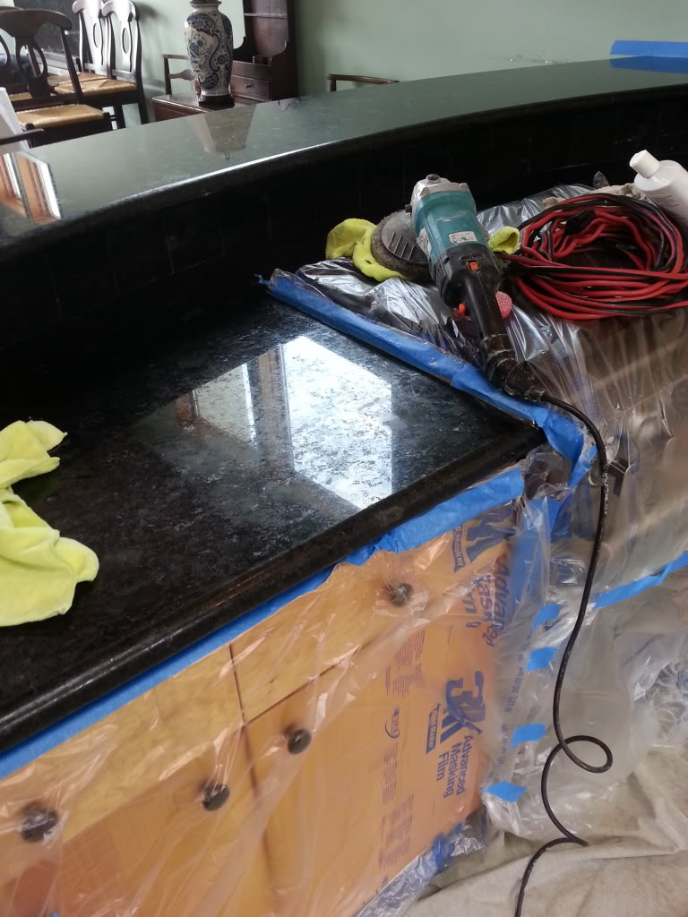

Really works as claimed on Granite in removing hard water build up, (crusty white stuff around the fixtures) detergent residues, soil, grease etc. No machine needed just a Hogs Hair pad and some elbow grease.
Unfortunately it would not get out the burn marks from hot pots and pans that you can see next to the range but the customer was thrilled nonetheless.
Get you some!
