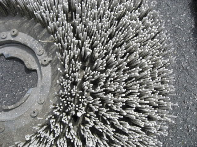

Fon Johnson
Yes, a regular black stripping pad will "gunk-up" and not strip as well. A thin high productivity pad will work much better. If the stripper makes too many "boogers" and is real gummy, you may need to dilute it a little more as well. It took me years to figure that one out. Stronger is not always better. We DO use a brush for stripping. The brush works better than anything, and it has lasted for YEARS (although the initial investment was high.)
This is the brush we use:
