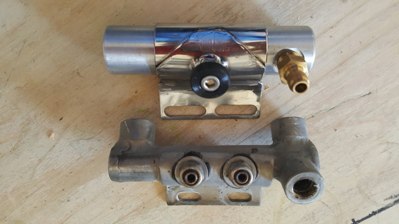

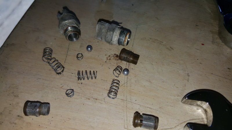

Ive never owned these before.
Didnt even realize they were in my older Devastator.
The springs were broken, ball bearings stuck.in some jets on the wrong side..
Yet the jets still worked so what's the point?
Dev is getting new manifolds..

We don't like them because they distort the jet spray pattern.
We put the check valve/filter at the valve, but it does allow some limited water to drip.
49,994
You can watch the spray pattern change and shift around if you pull the trigger and hold it. I always figured the springs were spinning inside the jet.
