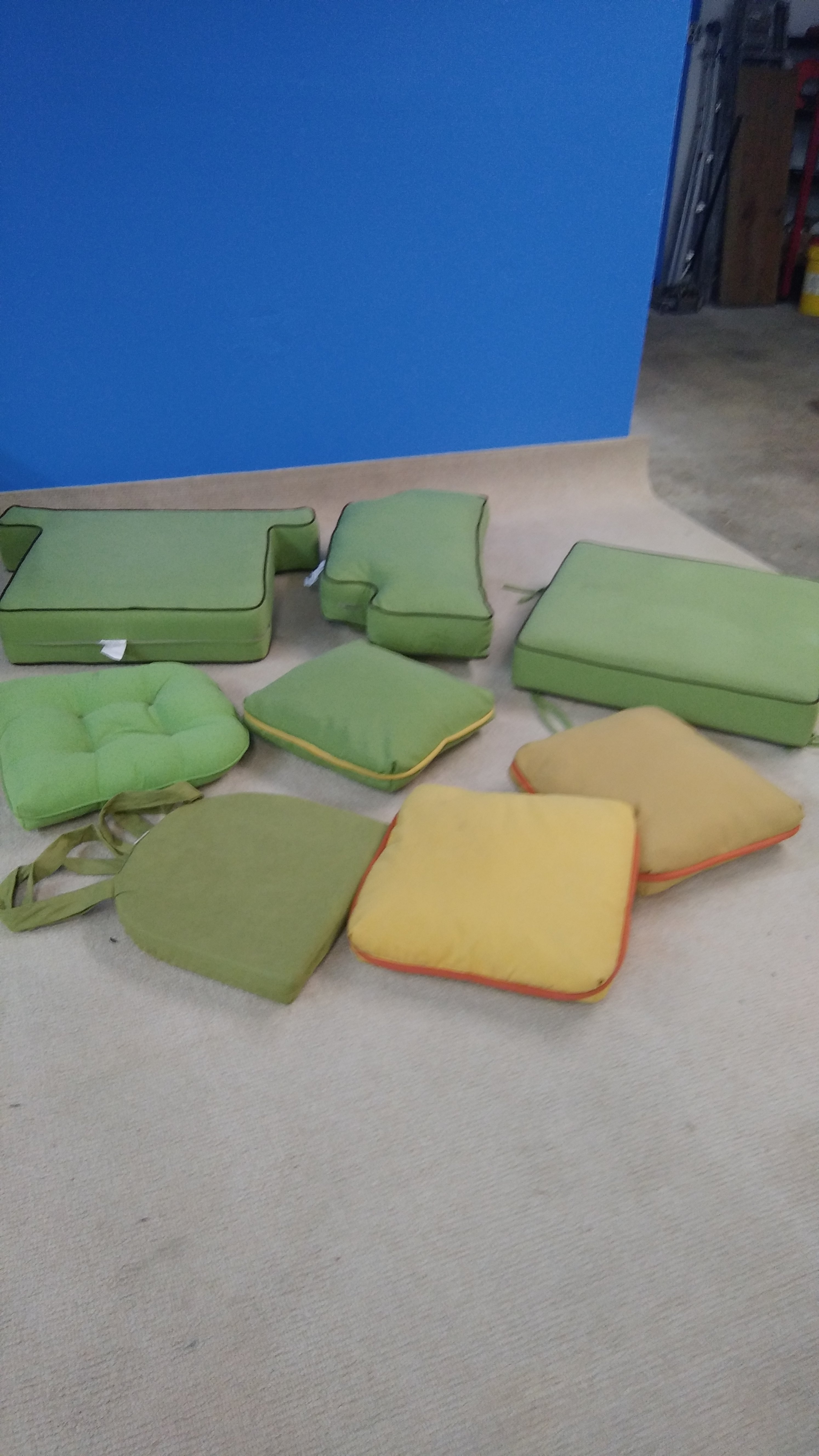

steve_64
Aug 11, 2012
13,372
I sprayer odorcide on these a couple days ago to deal with the mold issues first. Going to clean them now and see how they look when they dry. The 3 big ones are sunbrella I was told. 20190507_103540.jpg
