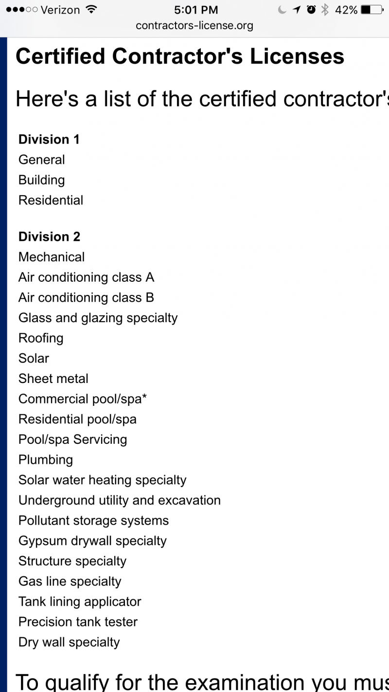

To answer your question. There is no such thing as a liscence for a tile contractor in FL.
So no.

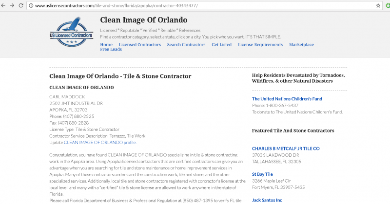

Why Florida doesn't require a license to install tile is beyond me. So does that mean any Joe off the street can simply open a tile installation business? That doesn't fly here over in California, anyone caught working without a contractor's license is fined, no warnings.
What's also interesting is how your business listing has you as "
Clean Image Of Orlando - Tile & Stone Contractor".
I would post a link but this is my 24thth post and apparently this board requires 25 before posting links. you can see the link in the pic.

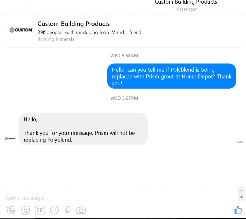

problem is that I know where this guy is going on this issue. I've dealt with it on other forums. He's posting information that is not true. Polyblend grout is available at Home Depots.
There's no intention of replacing it with Prism grout. I messaged Custom Building Product directly through facebook messenger where they confirmed what I have been saying.
I respect other individual opinions but have no problem expressing my views and will continue to do so if need be. Were all big boys here so a little heated debate is good.
The only threats I see are from you telling me I'm moving on if I don't shape up. I'll do that for you.

I don’t know about that website you posted.... I challenge their ā€œverifyingā€ as those phone numbers are pretty old, 1is dead other not been actively used by me in over 15 years.

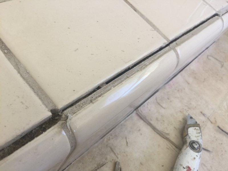

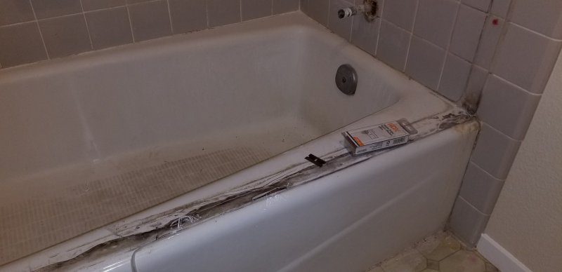

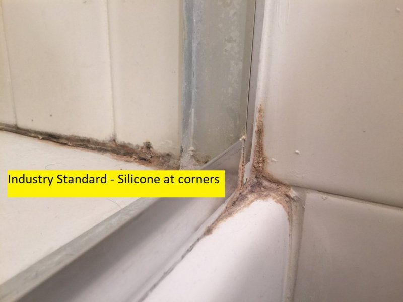

Here is the problem Jason, as a contractor, my concerns are your epoxy trapping water behind the tile. Or Any near waterproof ā€œsealantā€ for that matter.
Whether it due to Florida shower construction, Florida hard water or other factors, cutting to remove perimeter caulk and having water flow out, and often 30 minutes latter it still flowing, tells me there is water in the wall cavity. This is why caulk mildews in first place. Now we’re going to replace the water proof silicone with your waterproof epoxy grout.
Do you not see the potential problems?
Impregnating sealers work well and have there place, however like you said, your not going to water proof the wall structure in a shower.
I find it kind of ignorant on your part to assume every shower is build like you build it.
What is your warranty on your product?

In CA, it is required by code with a new installation to use a flexible joint material, such as siliconized acrylic caulk, silicone, or a urethane material where the plane changes. So where the floor meets the curb riser, seat, wall, etc., you must, by code, use a flexible material. Being on one of the largest fault lines on the planet, I see why this is the code.
HOWEVER, just because something is a standard, or a code, doesn't necessarily mean it is the strongest or best option.

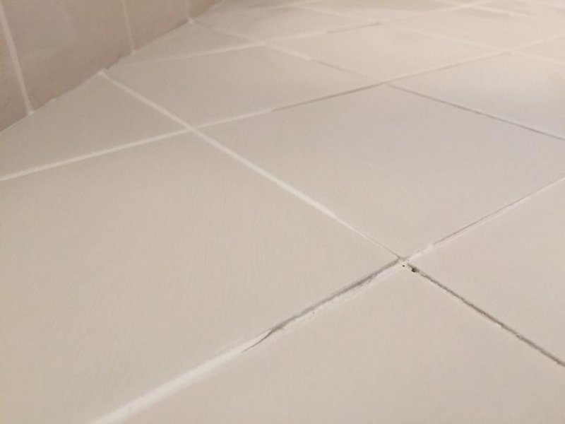

In my shower in my shop, the one that is used for training, was installed about 14 months ago. It cracked in the corners and around the floor after about 4-6 months. Non-sanded grout in the vertical joints, sanded grout around the floor perimeter. It was replaced with SGA and so far it has held up just fine. Obviously, this is a short amount of time to use as a gauge of durability and lifespan.

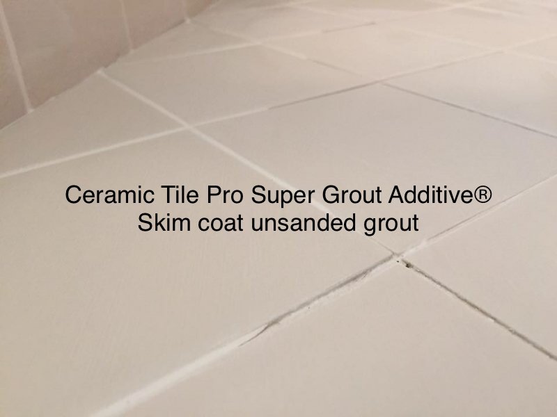

Let me know if you have any questions on the Ceramic Tile Pro Super Grout AdditiveĀ®. I am the inventor and distributor and can help answer any questions about the product. It's a 100% solids epoxy, nothing magical but it works really well as a silicone/caulk replacement. We have a number of grout cleaning/restoration companies using it nationwide including a few well known franchises that are also on board. I personally use it for my tile contractor business including new shower floors. Please visit my Youtube channel for a number of videos that show me mix and apply it. thank you - jason
