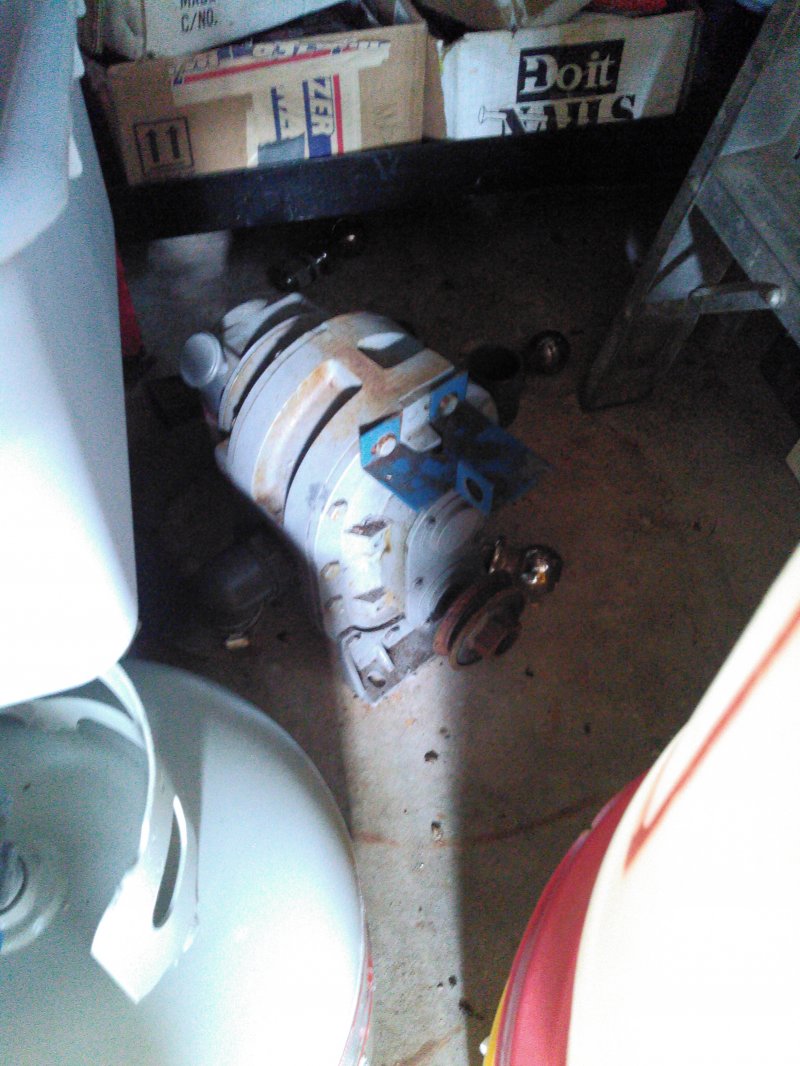

This guy has a couple of blowers for sale .. cleaning out his garage Jeff 1-315-589-7486
