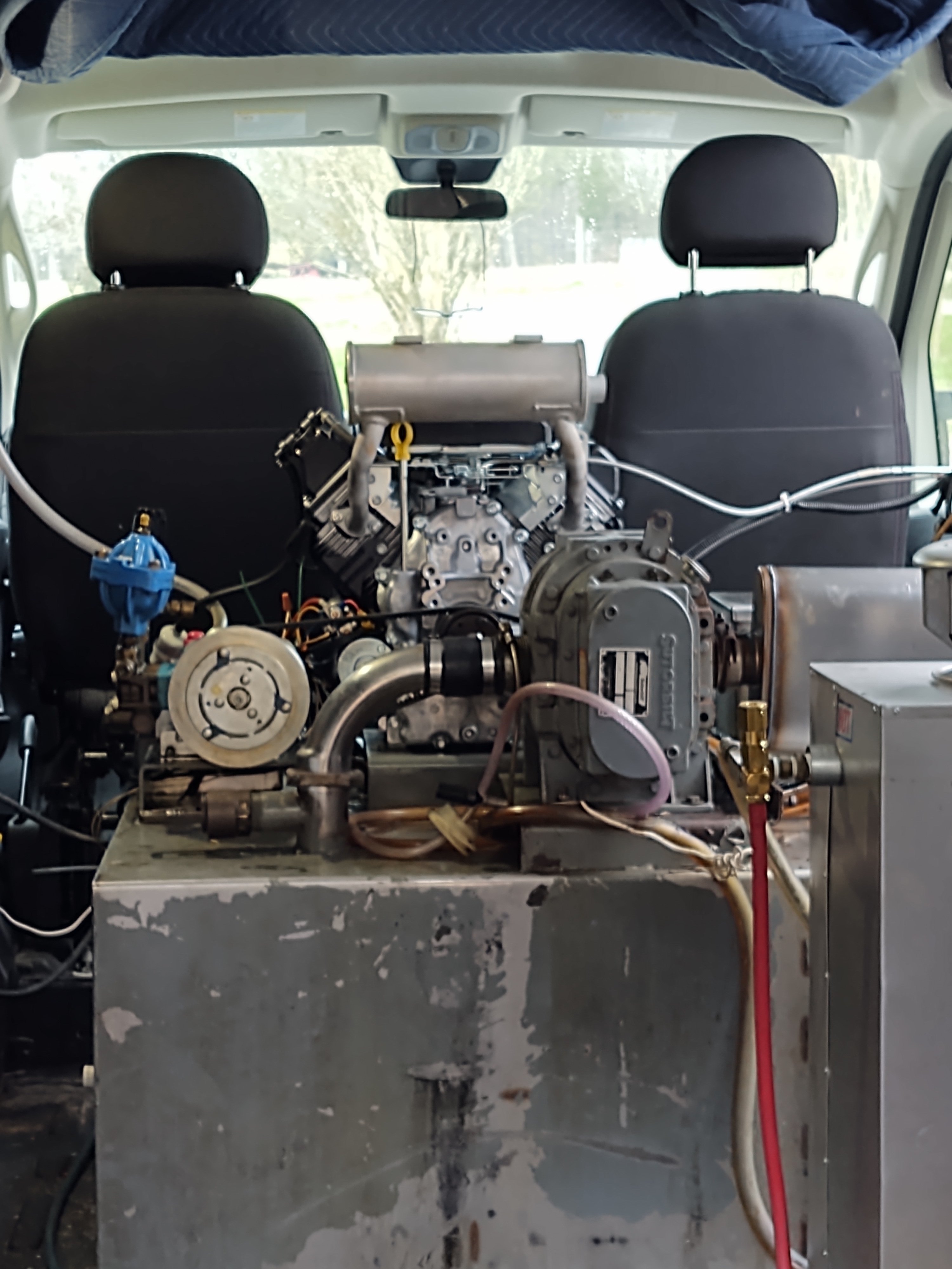

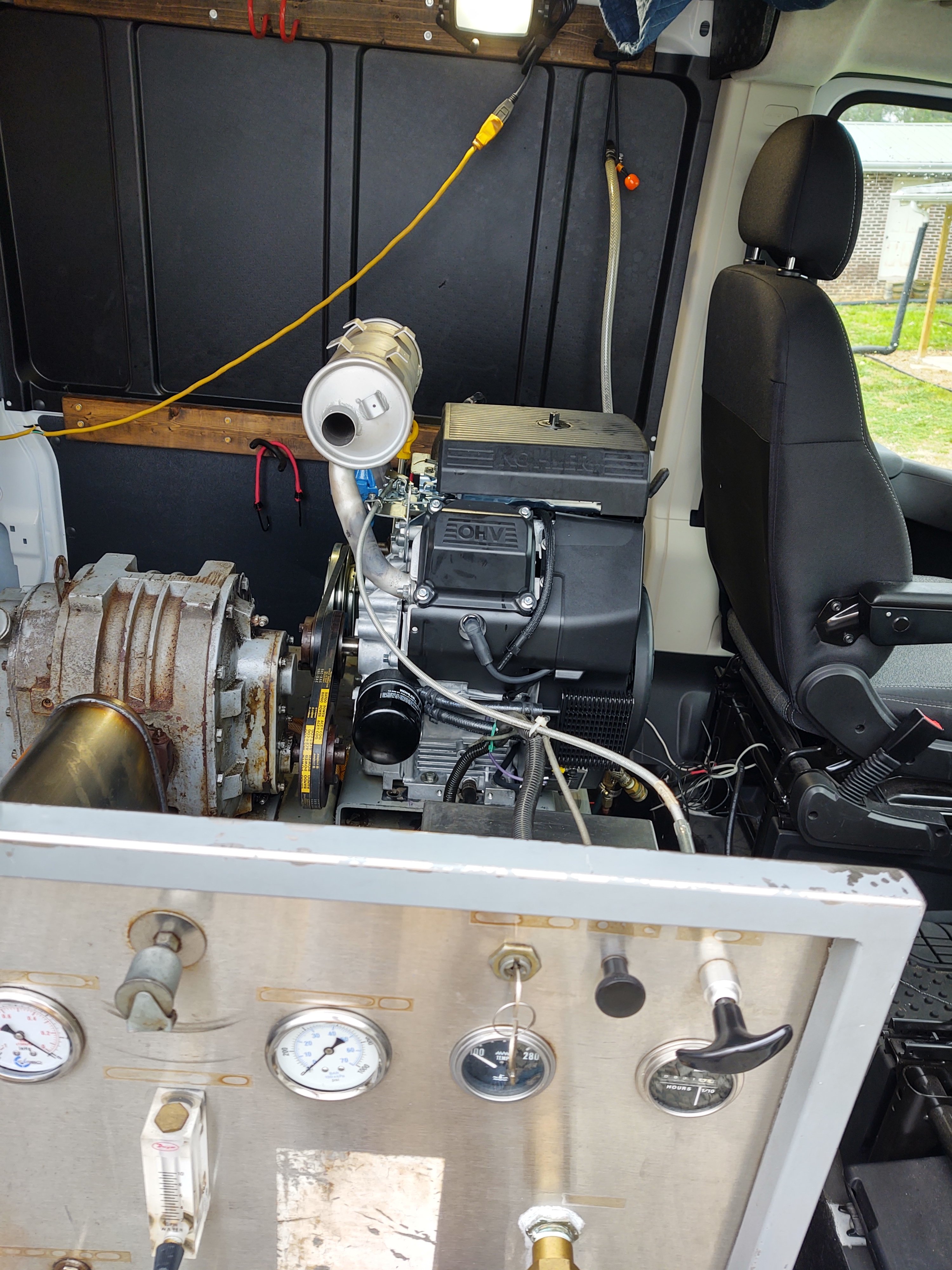

Swap went good. Needed new mounting holes so engine would sit back for pulley alignment.
Made a mistake on template placement so did 4 practice holes.
Need to source some 1 3/8 in flex pipe so exhaust doesn't mess up me hair.

I’m glad that’s not blower exhaust blowing crap air on you. Maybe turn it pointing to the left
14,126
Oh, I see the separate blower exhaust IS blowing crap air on you. Get another pipe for that also

You are going to smell like exhaust fumes every house you go in, in just the time it takes you to start it up and adjust your chem feed and such. I would look for a different route.
