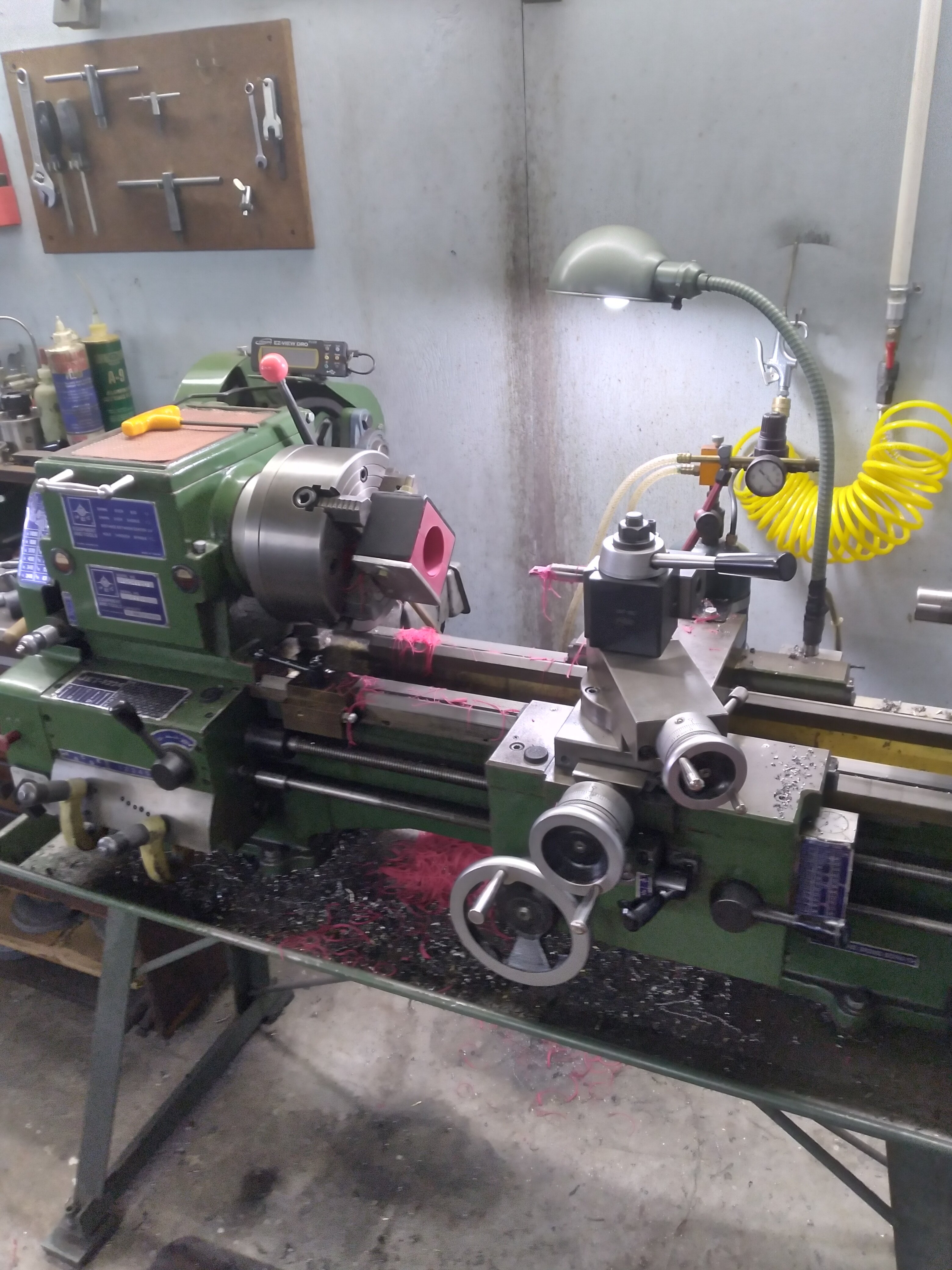

Im glad i built my machine rather than buying a butler. Originally i was buying a butler in a box truck but in the last minute i backed out because the box truck didnt fit in my shop. What i do know now about butlers is that some systems are made far more complicated than needs to be. For instance. Priming the chem pump. Compare their procedures to the hydramaster, sapphire scientific (pretty much all other manufacturers) youll see what i mean. Also how they stacked the hose reels and run live vacuum hoses. The major problem i would have had with butler is, you have to deal with butler direct, no distributors and they're located on the right coast and im on the left. Making a longer waits and higher shipping cost for parts. The simplest pto in my opinion on the market today is the cleanco when building Frankenstein i used alot of cleanco's components. (Modified engine & rear driveshaft mounts, heat exchangers, and coolant taps)The main 2 things that sold me against buying a new cleanco was#1 aluminum wastetank and #2 dated 70's-80s looks. Hydramaster 3 things that sold me against it was aluminum wastetank and#2 multi piece open drive shaft. #3 orientation of components between driver/ passenger seats. Although i did give hydramaster credit for having the most freed up space in the cargo area a of all the machines in researched . In the end after shopping for a new pto at the Las Vegas show i left pissed off and went home empty handed venting my frustration at my good friend and supplier, who gave the best advice in my situation. He said that he'd sell me whatever i decide to buy. But he went further and said that no single company makes the best of everything. All machines have pros and cons. One company will have the best drive system while anothers heat exchangers are the best while another Company will have the best ordination (how it fit and utilized the space). He looked at me and said but you Mr Dwaino are in a unique position your abilities and resources allows you ,if you want to, to take the best from each company and put into a single machine and have the best of the best. For me that worked great but its not for everyone. So unless you're willing to go down that rabbit hole every machine on the market has pros and cons. That need to be weighted to find the best match for you and your skills, needs, and situation. My advice is take time, listen to everyone and take all our comments as opinions rather than facts, do your own research and when the time comes to choose, you'll choose wisely

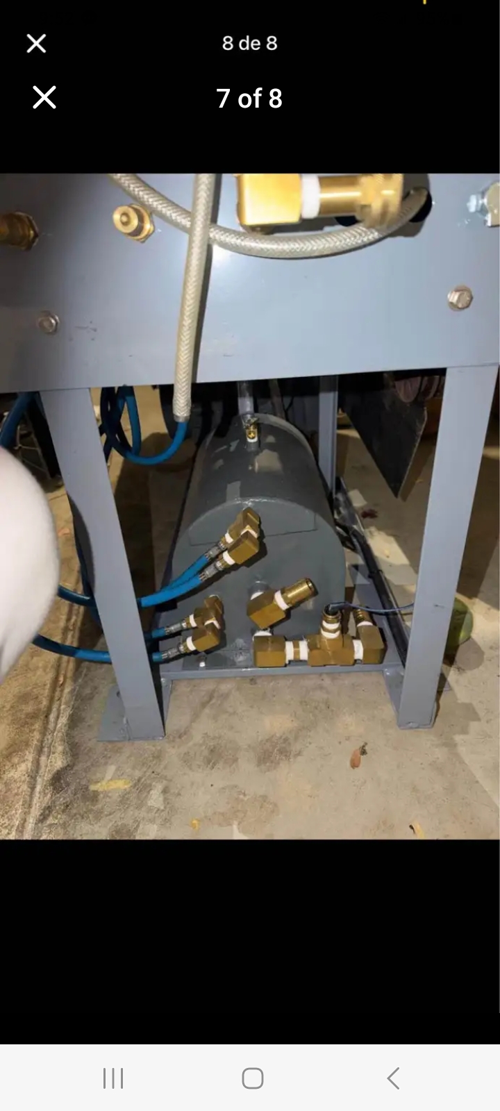

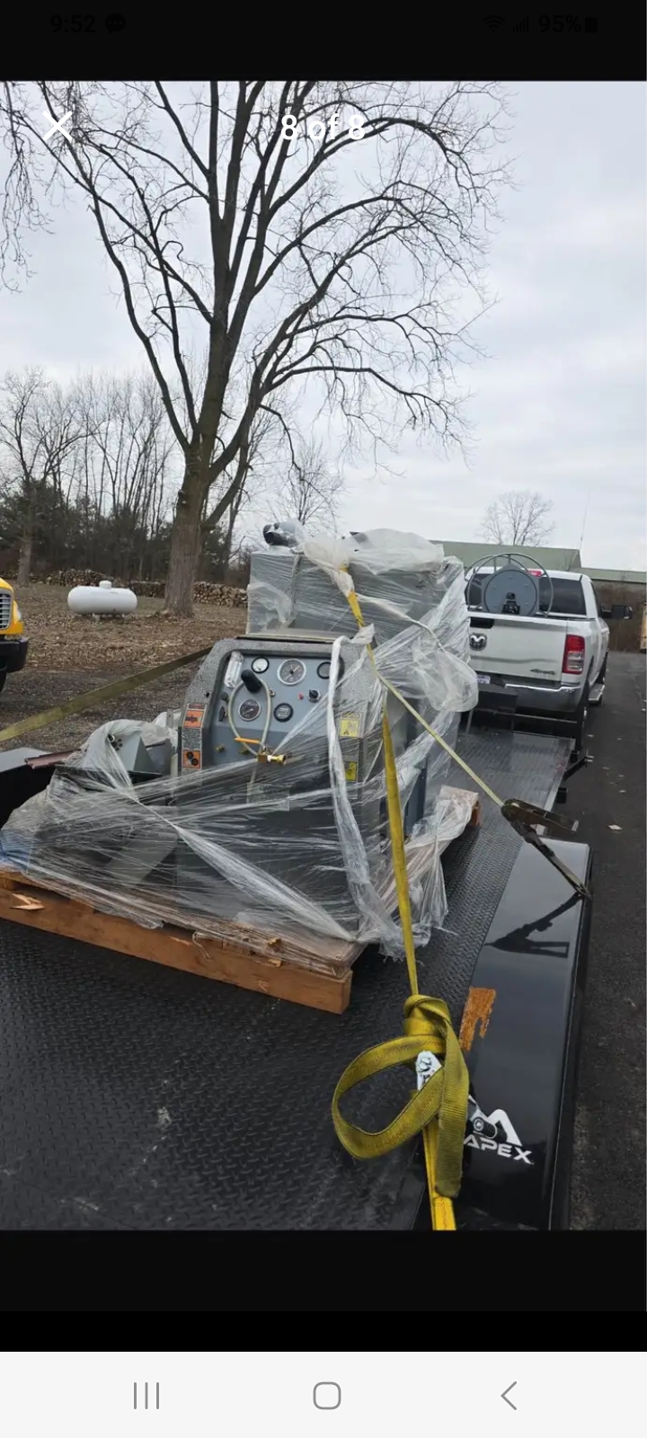

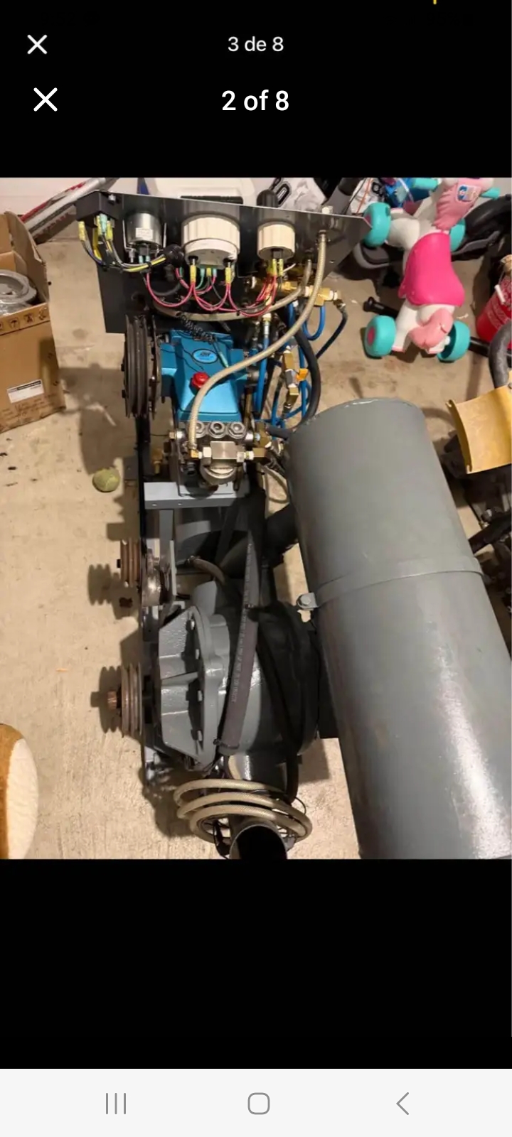

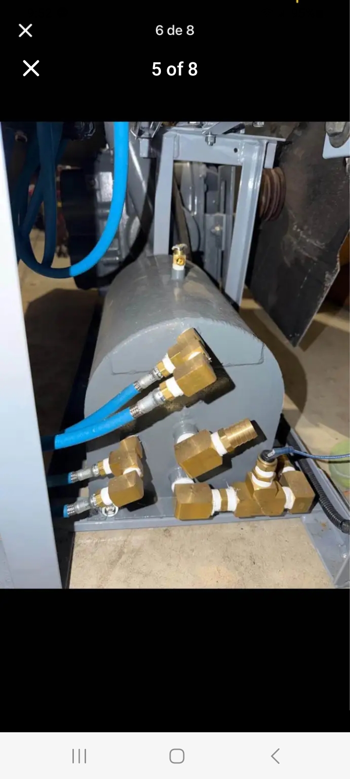

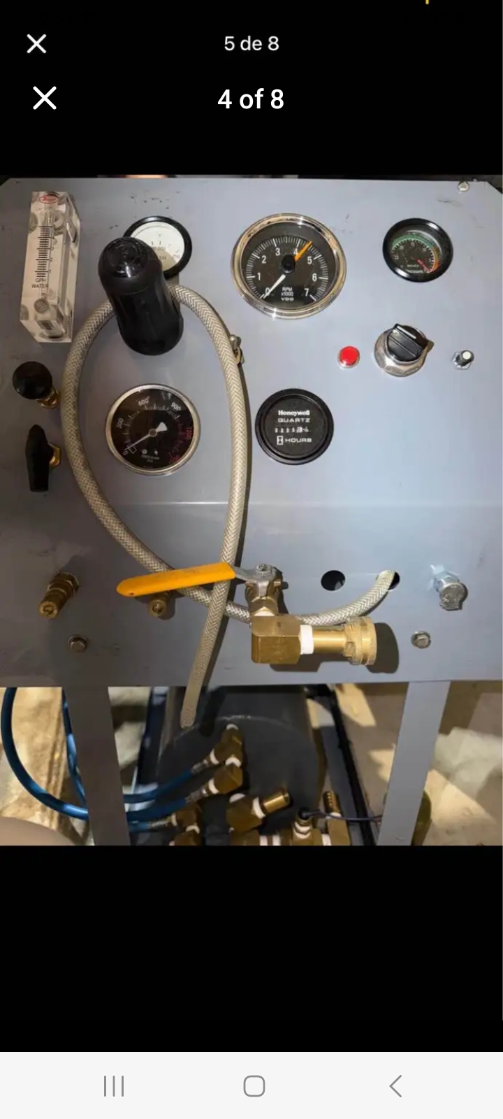

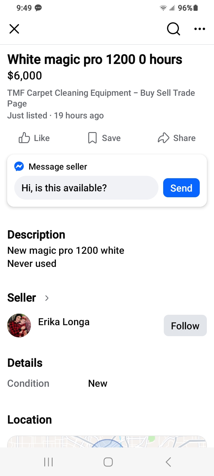

yeah, I talked to that chic about that she's selling. She said a flooring business bought it, never installed it and kept it tucked away in their wearhouse. I don't know, she seemed a little shady from her Facebook page.

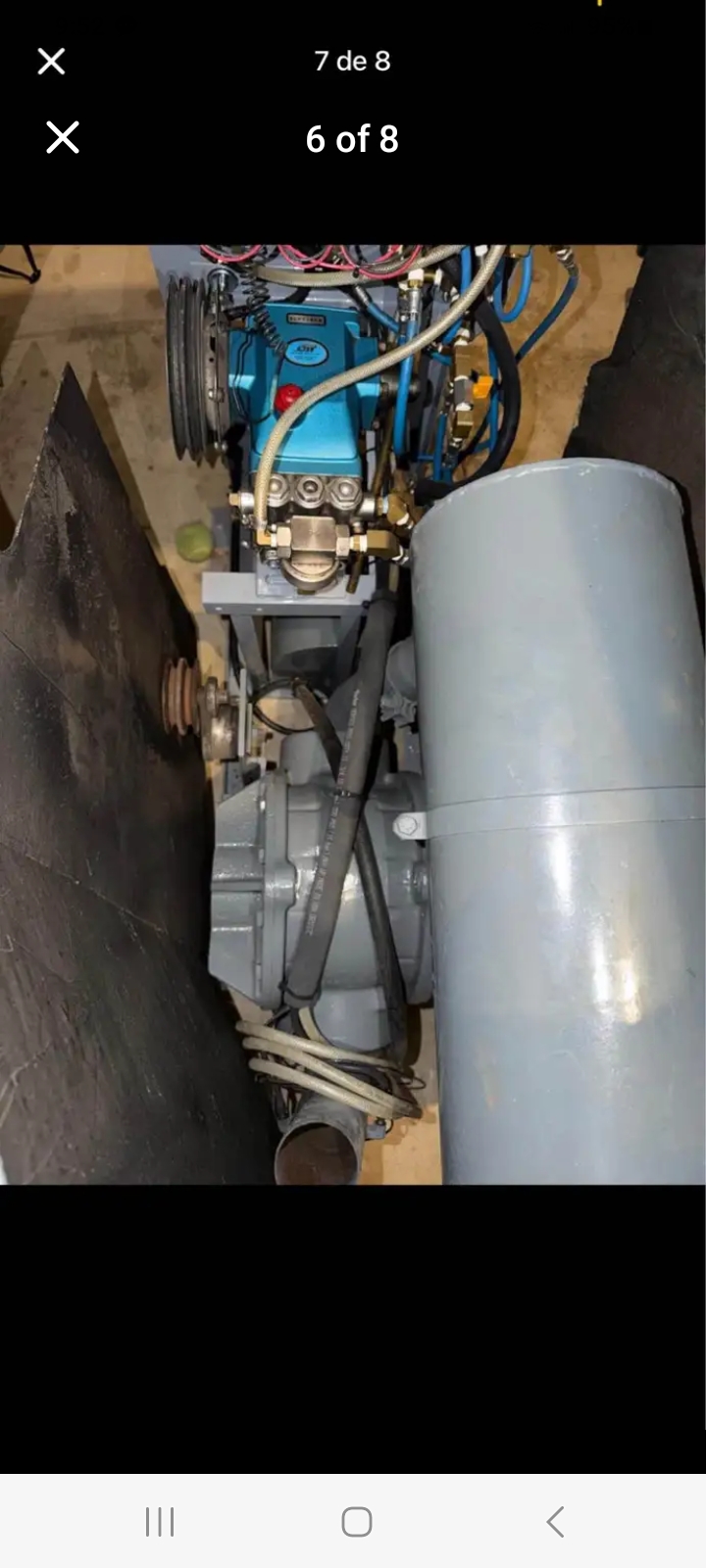

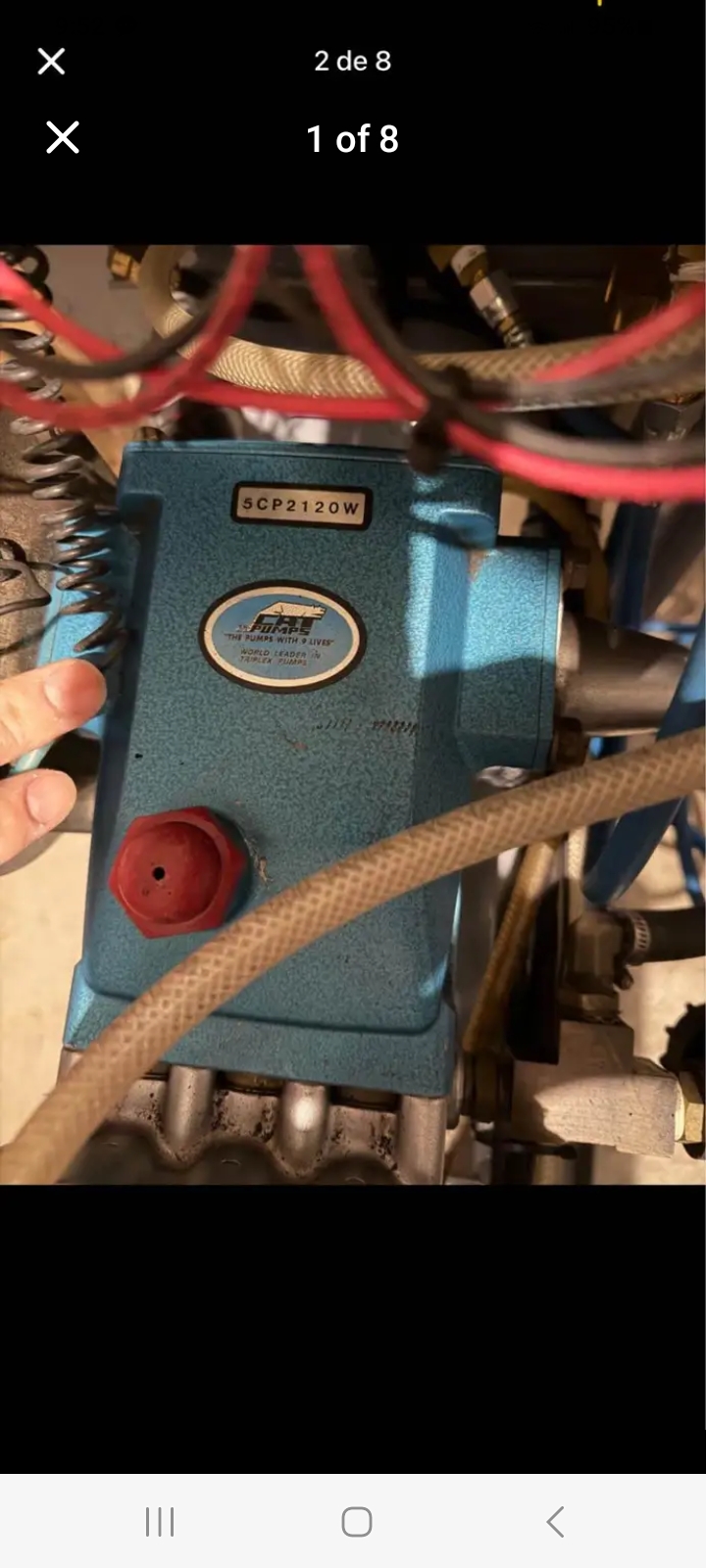

That's the third one of them I've seen being sold as new never installed. That particular one i would have to see in person. It doesn't have the control panel sticker/ silkscreen. But for me that wouldn't necessarily be a deal breaker. I would want documentation/ owners and installation manuals and be sure all the parts are there ie: driveshaft/ front&rear mounts/ throttle controller/heat taps etc etc . For me it would be the little things like weather or not it has doghouse hardware, look inside heatexchangers and blower loabs to see if ever used and maybe rebuilt. and just how complete the install kit is should have everything down to 30' of 1" heater hose. But from the pictures, if i were looking for a new machine,id drive the 500 or so miles to check it out. But thats me...🤓

It just looks like a really good parts machine for someone with an older white magic already in their van. And for that in mind, it’s a really good deal

I think this unit is for some VERY familiar with what is involved in hooking one of these units up to their van. I don't know if the "front end kit" is with this unit, and even if so, what vans it would work on now.
I'm sure Dwain could figure that out on about anything, but most couldn't

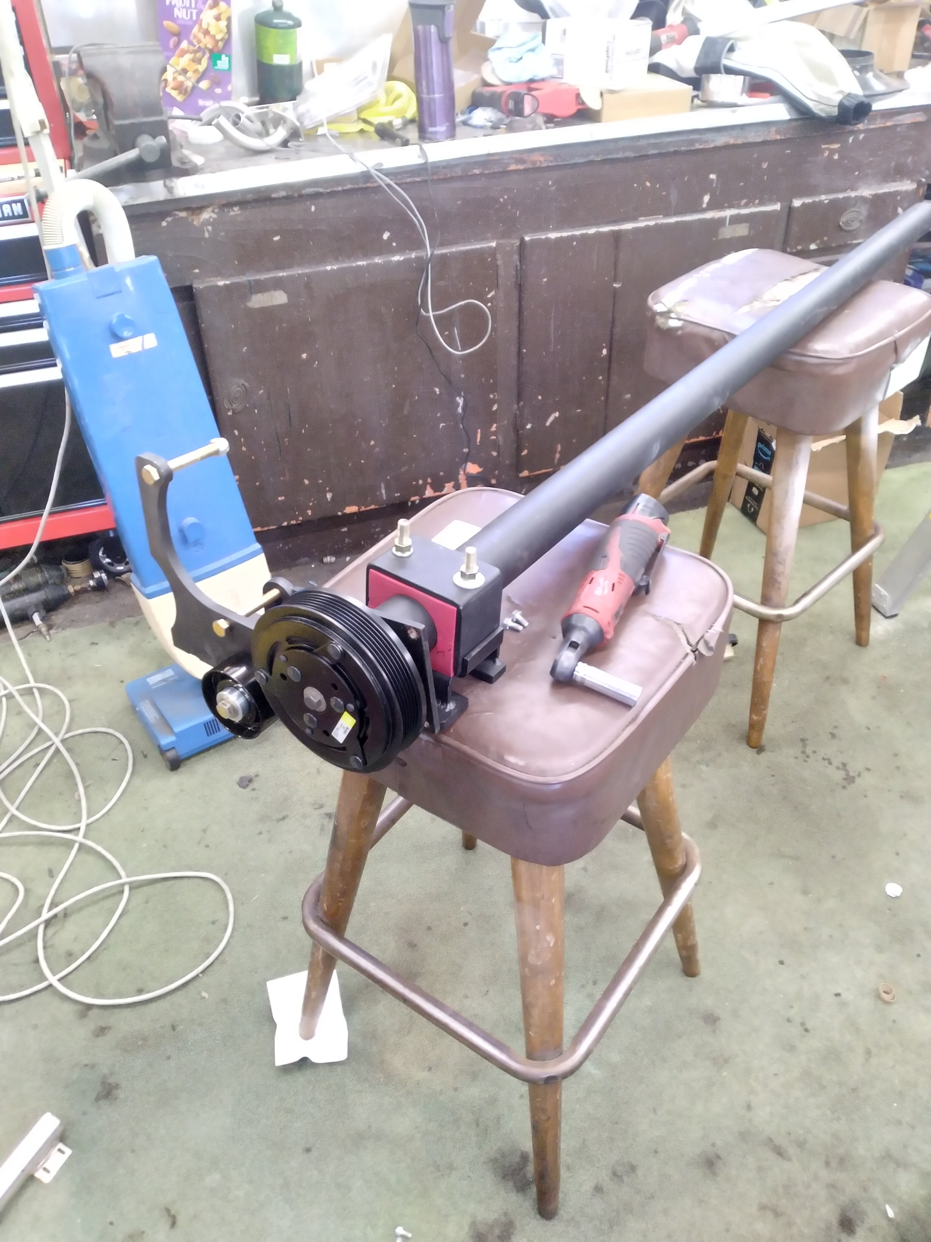

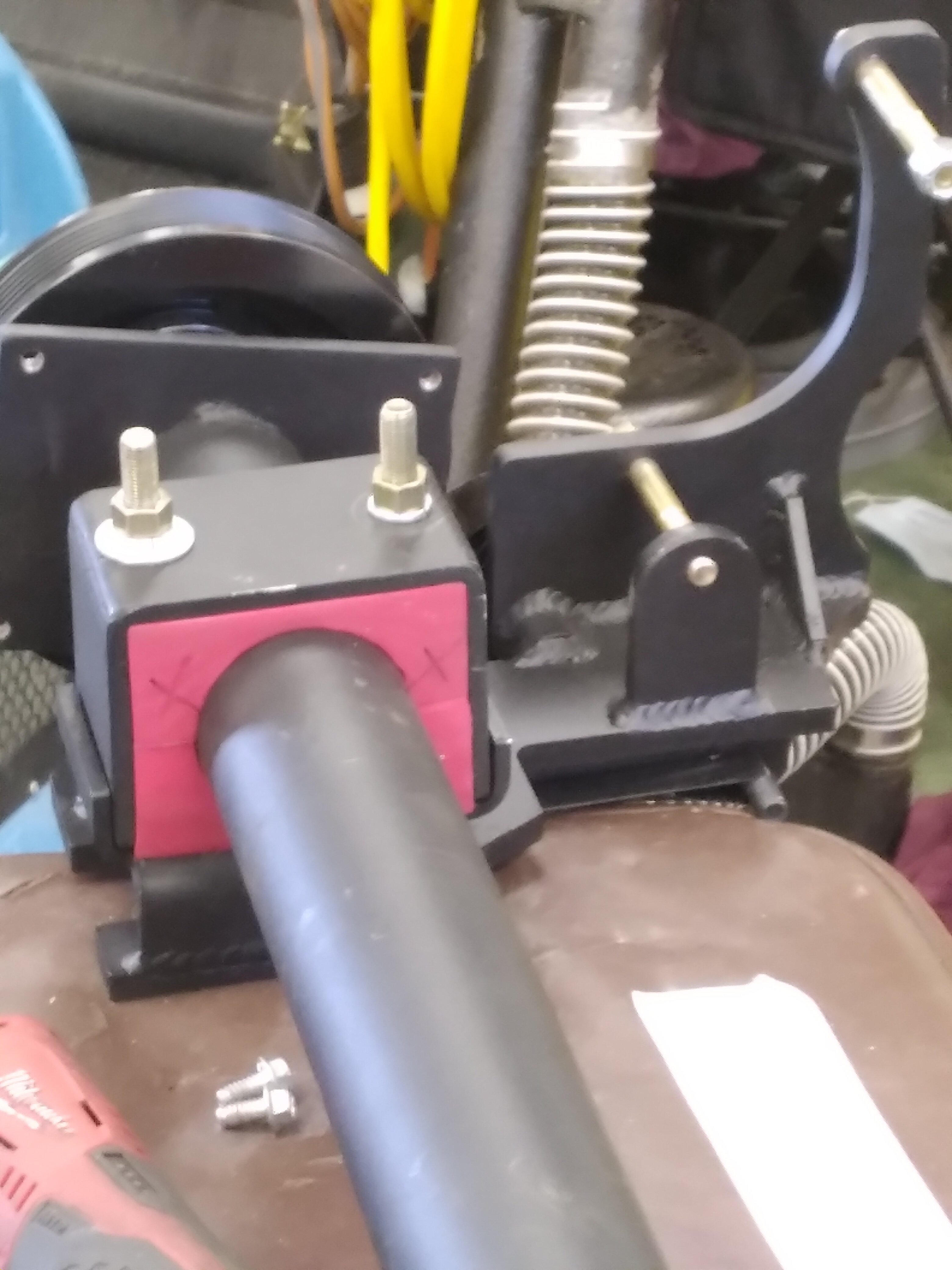

Fortunately most all pto's with the exception of steamgeni and hydramaster master used the same driveshaft. The butler,sapphire scientific, cleanco,white magic and i believe even the areo tech DDS all have the same. I've searched before to find it and the manufacturer on live and i did once but when clicking on it my fat fingers hit the wrong button and i haven't found it since. But its so universally used in the cleaning industry that an engine mount can be found. When i built Frankinstien none of the old 90s engine mounts i had would work on a 2020 chevy 6.0L i bought a complete cleanco frontend kit that came with complete driveshaft mount, air cleaner resonater relocate, coolant taps and hose, electronic throttle controller, doghouse boot etc. Because i have 7 or 8 steamgeni driveshafts i decided to modify the engine moumt to fit by boring out the bushing ¼" instead of buying a cleanco or other others shaft that already fit off the shelf

That is beyond the scope of my time and workspace constraints. But very cool, and seems like a stellar deal if it all checks out. A young machine and a young van would be saweet.

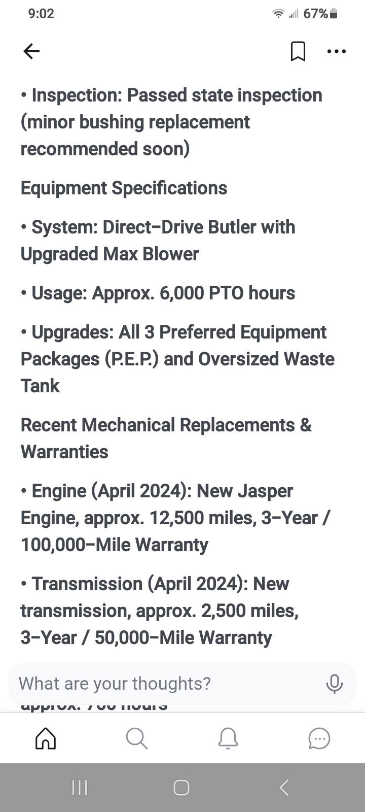

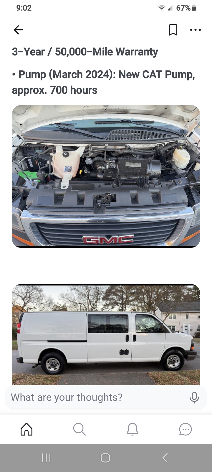

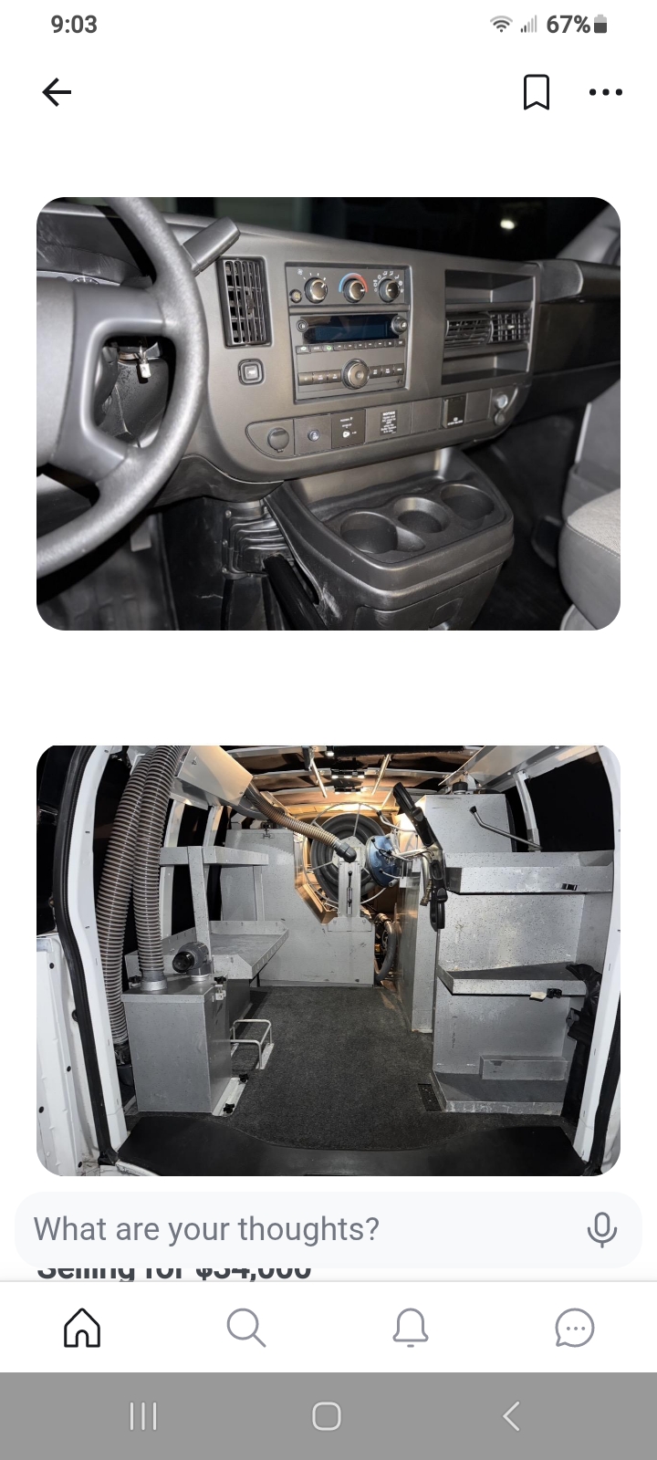

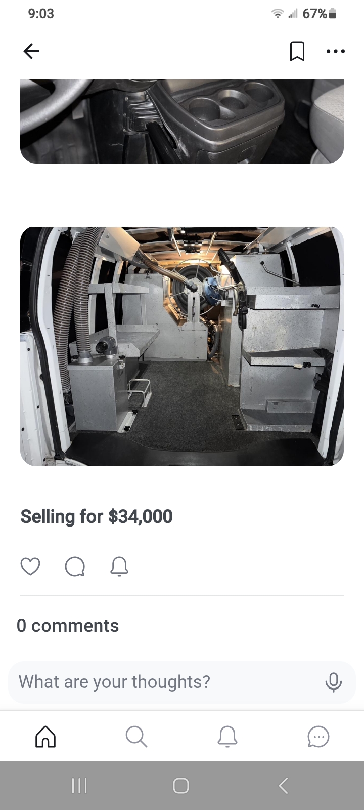

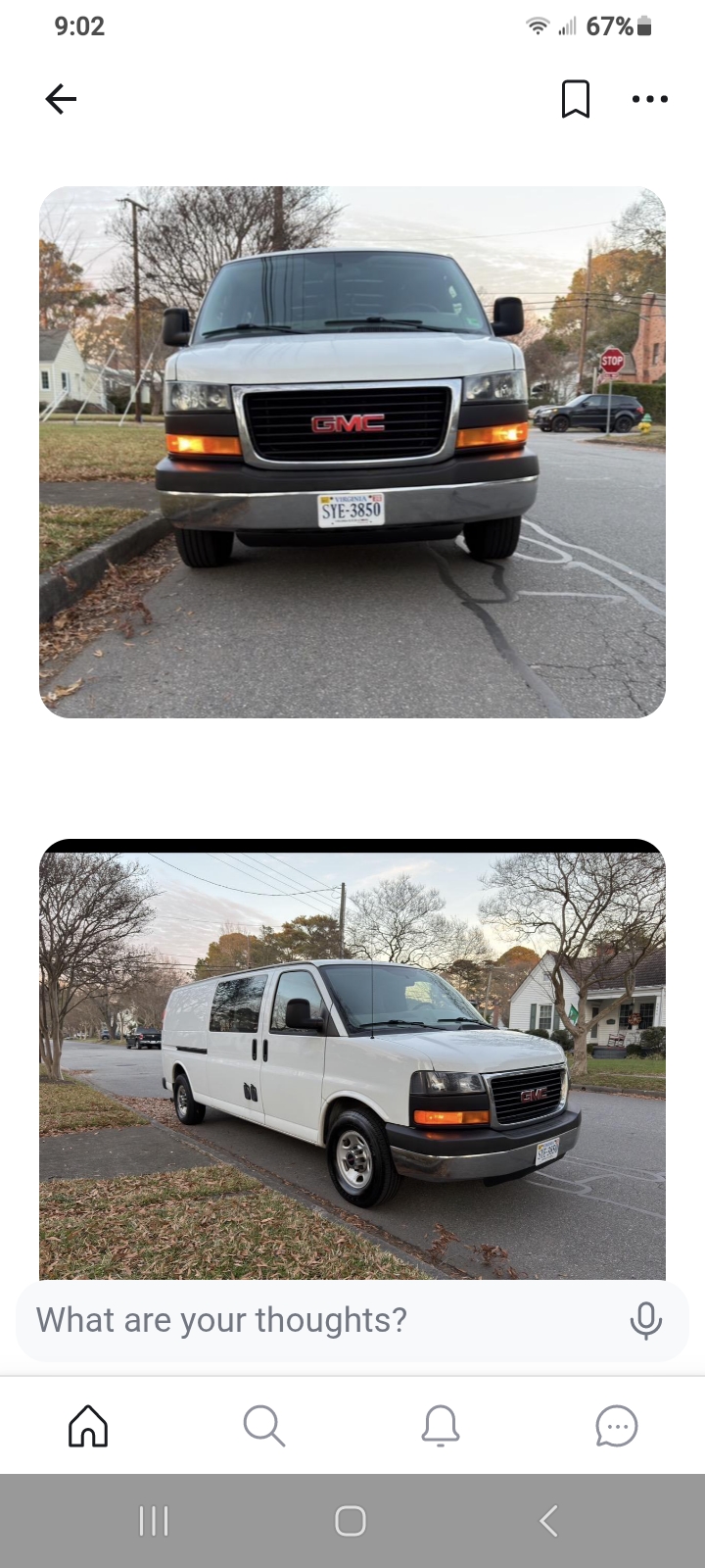

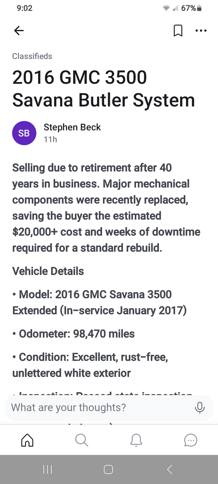

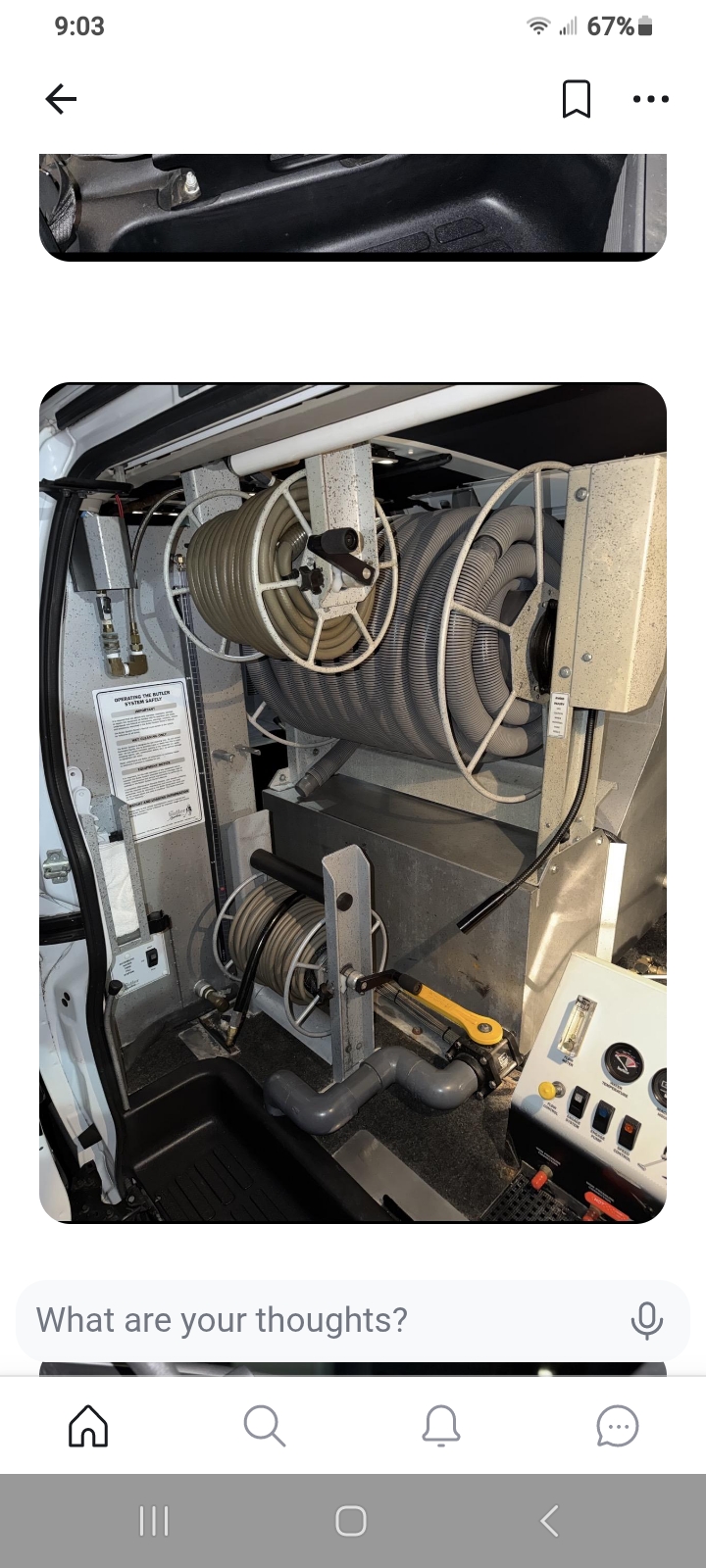

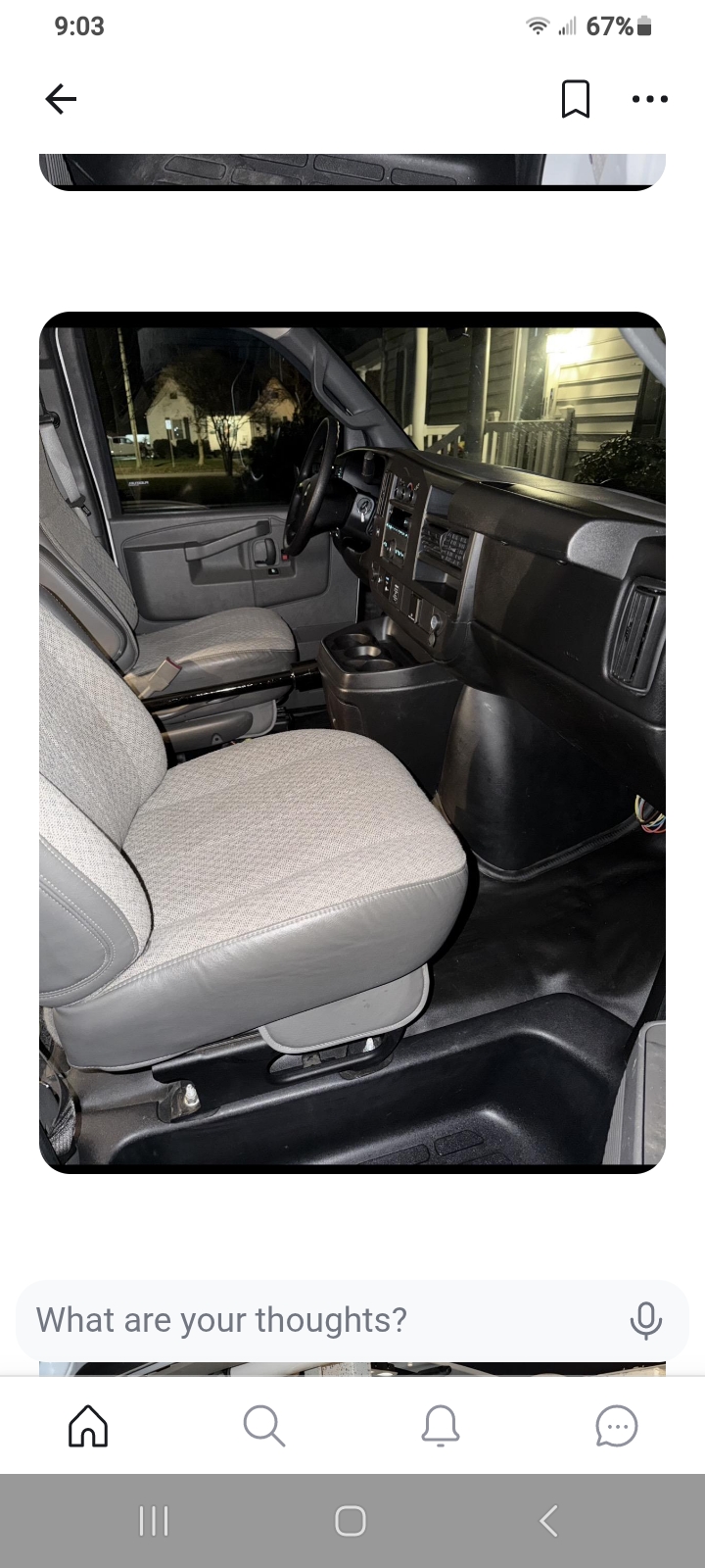

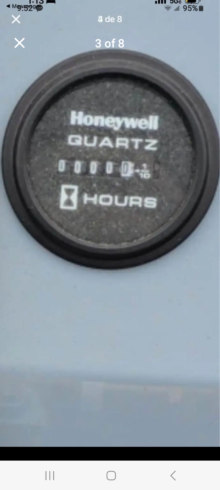

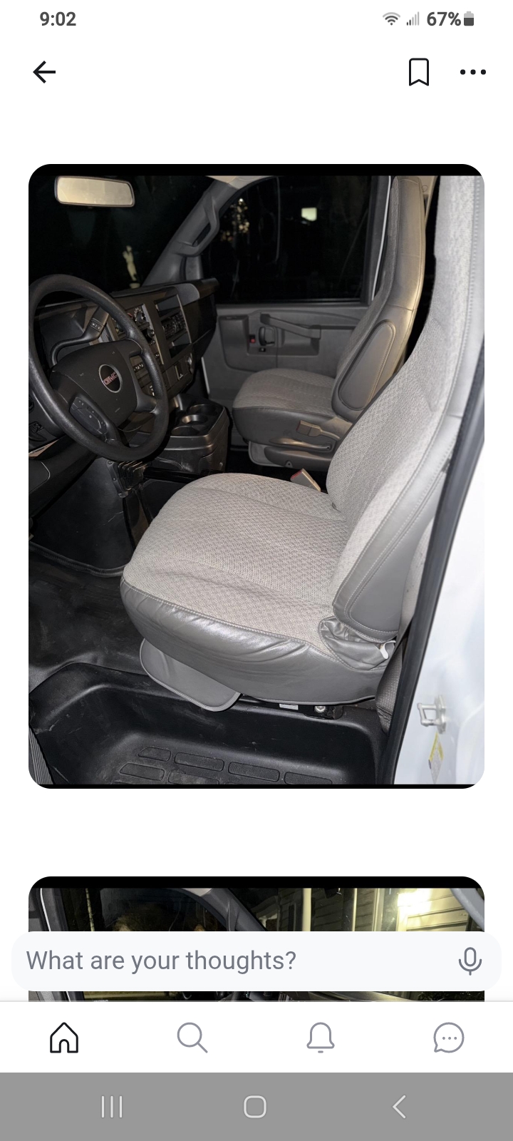

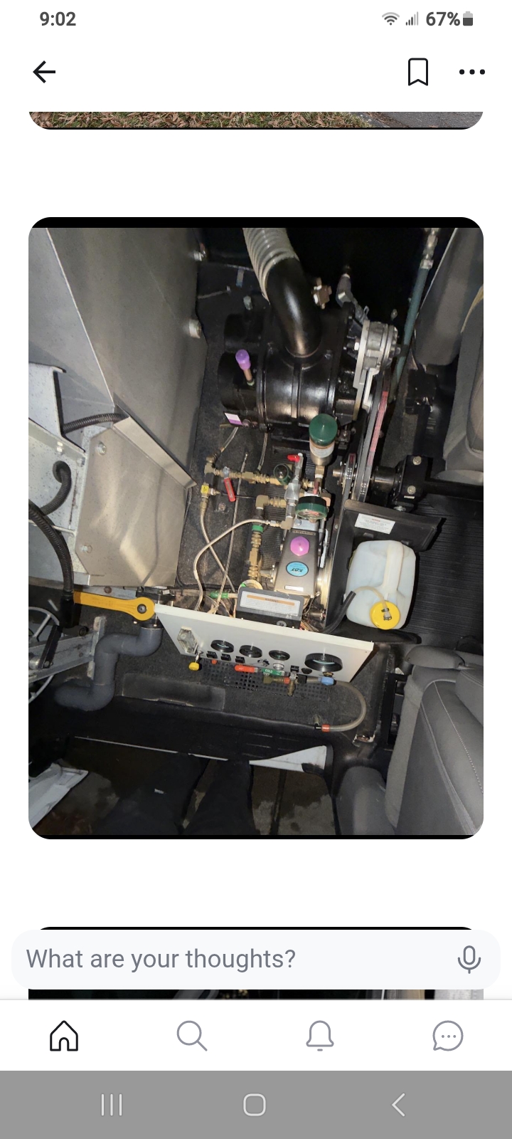

Theres a 2016 butler with a engine & transmission new and under warranty on tfm for sale pictures make it look well maintained asking 34k. Its new enough that a credit union may finance( according to the guys bio hes a few hours away from you in Norfolk Virginia)

That is a good deal with a new engine and transmission. I'll check it out. Thanks Dwain-o!
