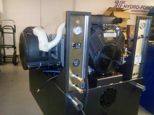

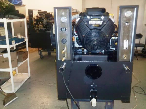

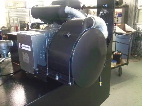

Greenie said:
wait a min?
All blowers already have a fill port and a breather port that I know of. Why would the pressure be any greater than any other blower if it was properly vented?
Or is there some blowers out there with PLUGs installed where breathers should be? :shock:
ps: Hogjowl
If you want a 150-170 gal waste tank, it's gonan take up some space, how about you just settle on a classic TNT with the 120, it's MUCH narrower.
Look at the pics. It has plugs on top just like the 650's DID.
L
Leslie Judson Jones
John,
Sorry it took me so long to get back to you. I was doing some investigation on your claim that Gardner Denver had a run of bad blowers. It took me a few days to confirm if this was the case or not. I’m glad you mentioned it, because I sure would hate to be selling machines with defective blowers.
After multiple emails and phone calls with Gardner Denver concerning this matter, I have confirmed that there is no run of defective blowers. I started a new post concerning this matter in case somebody already owned a unit with this blower. I wanted to put their mind at ease. These blowers do not require additional vents due to their internal vent system.
John Olson
6,281
John Olson
I should have asked what Blower that was. I thought it was the 650 you where using. I didn't realize you was using the smaller blower. I should have looked closer. The T408 hasn't had an issue that I know of. I WAS WRONG.
