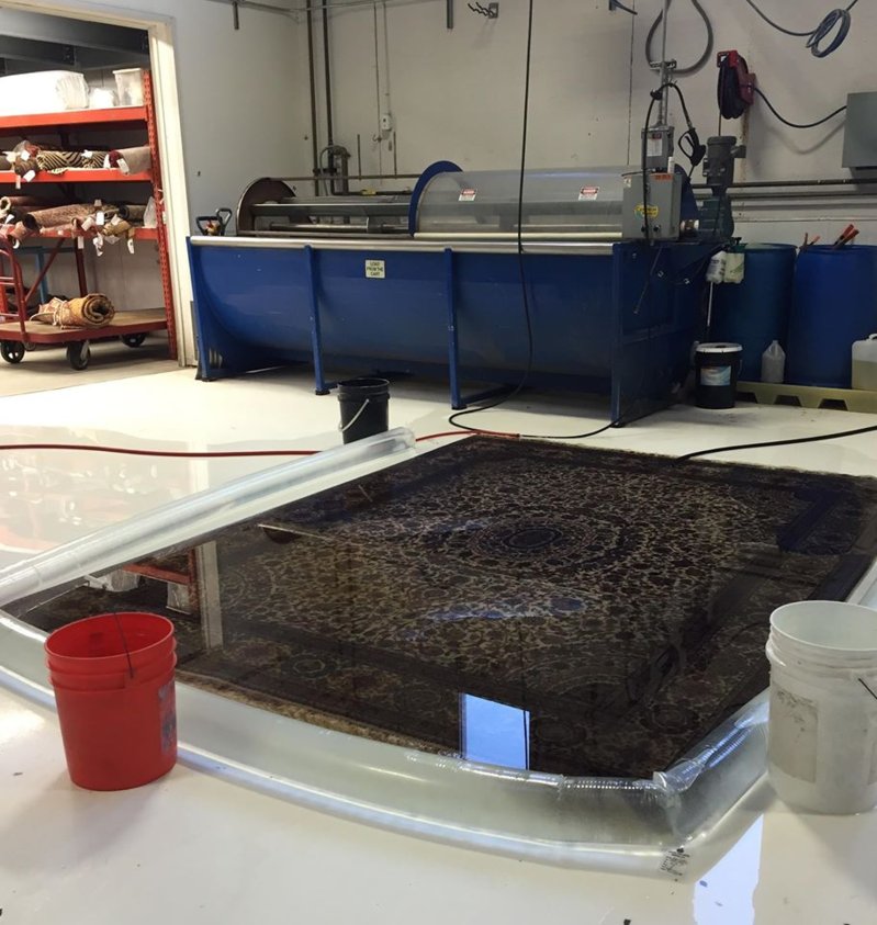

You can also fill the smaller diameter tubes with water to make quick soaking enclosures on the wash floor. (Robert Mann's idea is inexpensive)
We also sell the new version Rug Suckers offered by Rugged Industries.
http://centrum-force.com/rug-sucker.html
