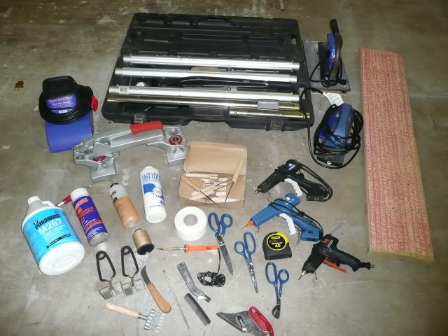

Harry Myers
This is some of what I use on a basic carpet repair.
