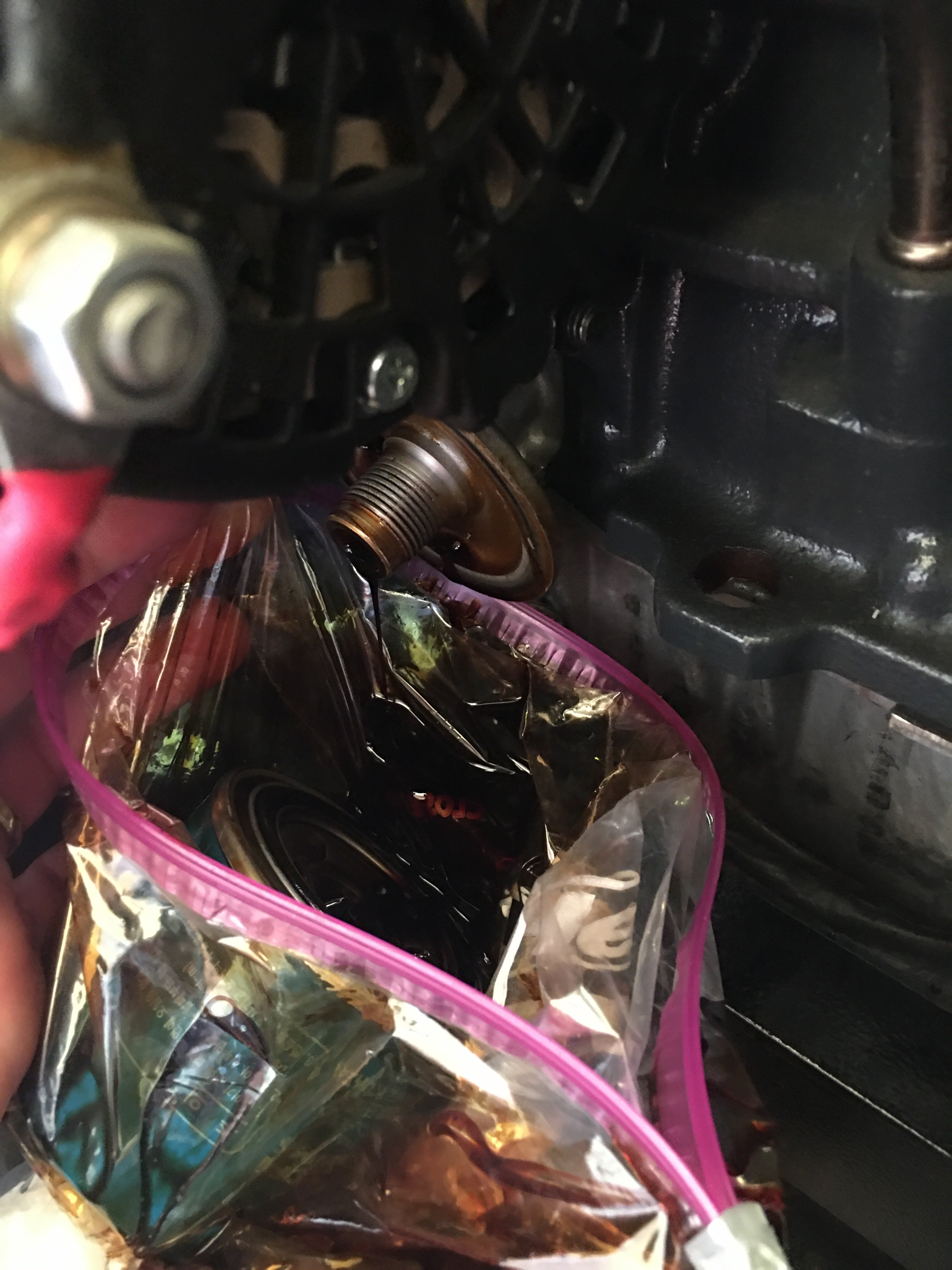

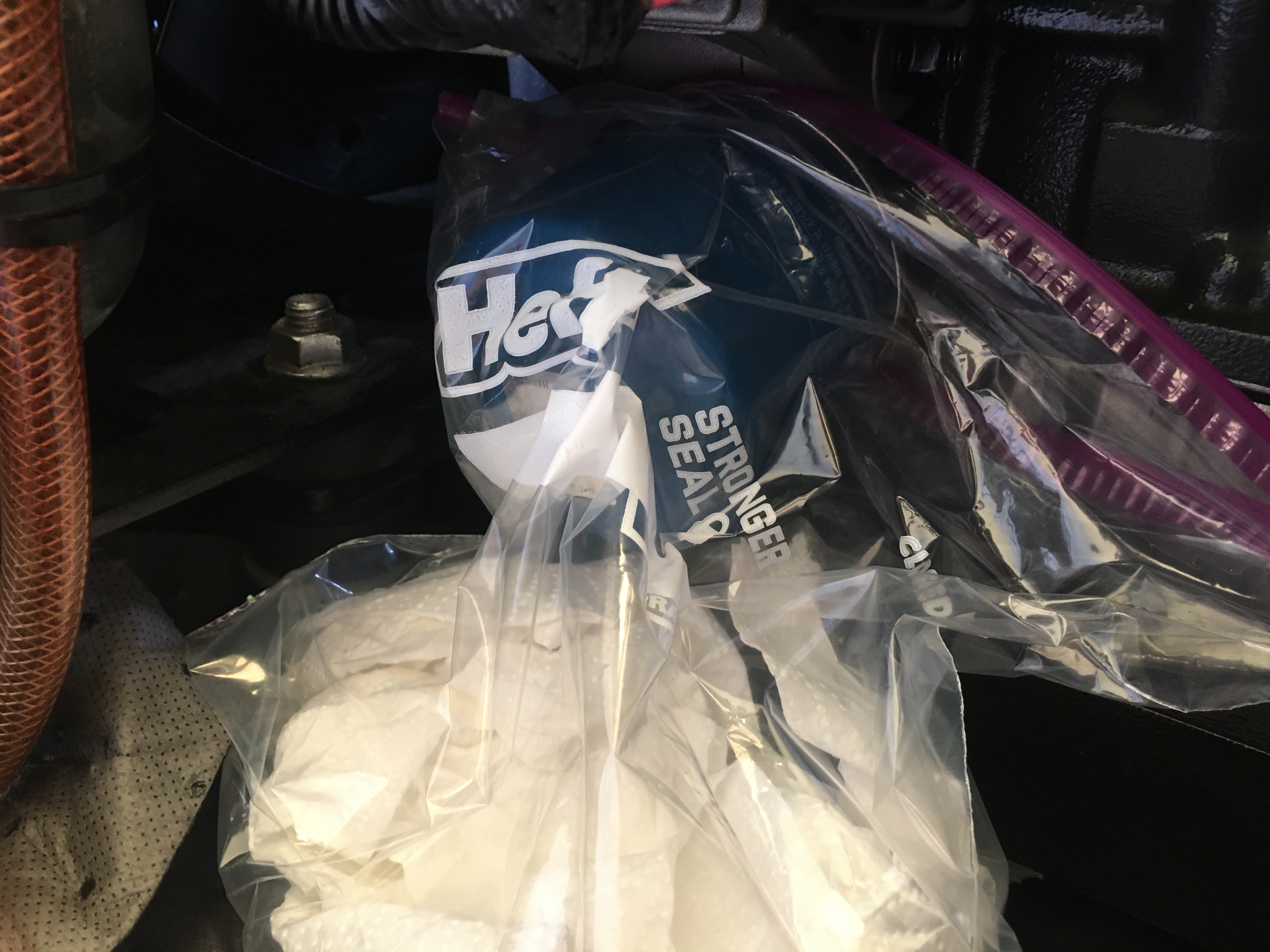

The CLEANEST way to change the oil on your truckmount!
14,611
Enjoy applying this tip

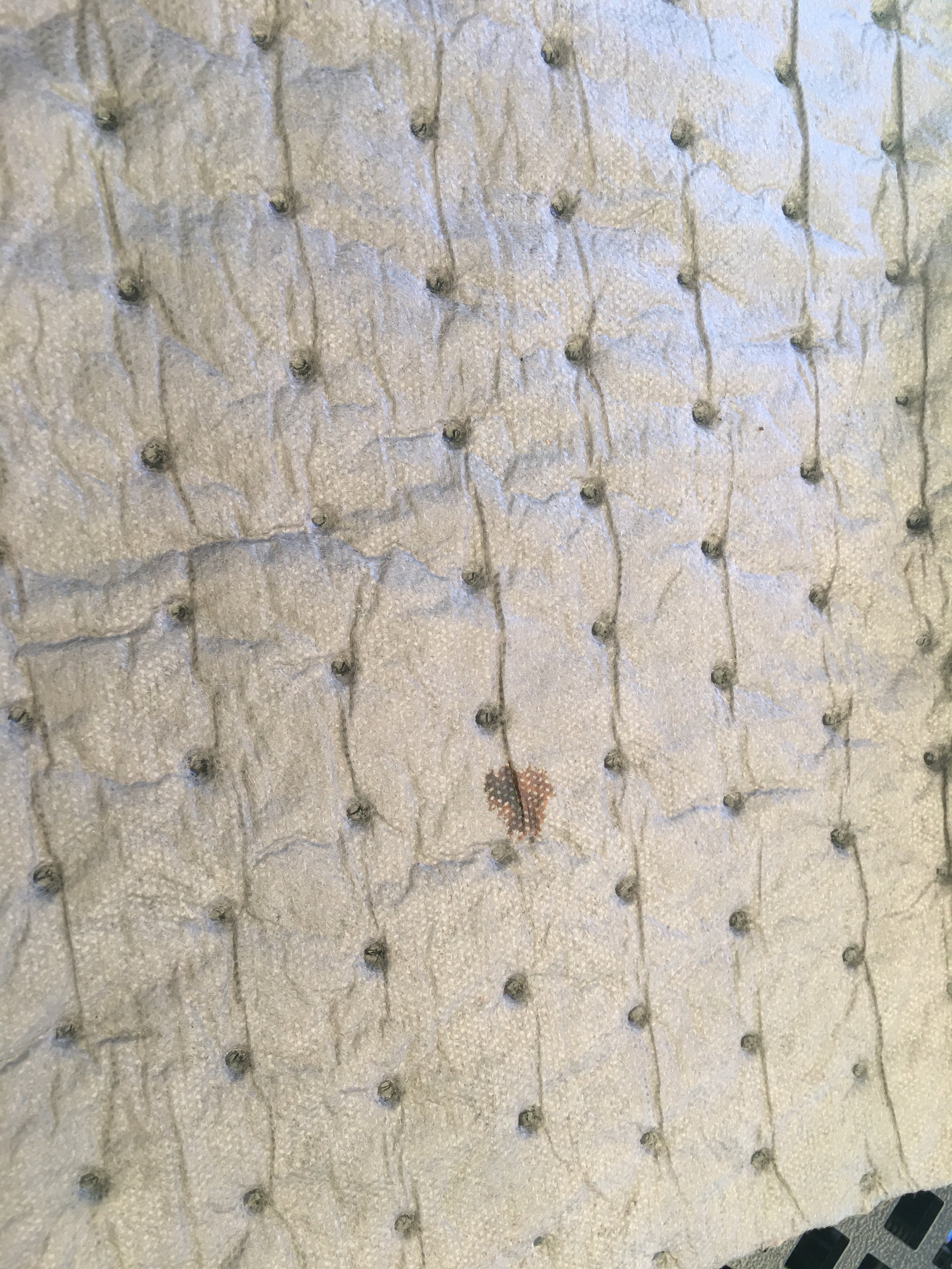

only one drop of oil on my oil catching cloth compared to major cleanup.
A691DEEF-5A2F-4386-89BA-B32C16D83F4E.jpeg 45E163D1-99FE-4278-A7F7-F0203DD95F84.jpeg 3030D94C-0AE5-4753-8727-F765C112DF79.jpeg CB0E0DEC-DBCC-4725-A4A6-1C34B1282B04.jpeg
14,611
I got this tip from youtube on a guy showing how to do a clean oil change on his boat. I figured it's worth sharing for us tm maintenance do it yourselfers
14,611
I'm using the ziplock bag to catch the oil while I take the filter off. It makes your red potholder, that you say catches oil, look amateur. Is there any more room in that noggin of yours to absorb any more advice?
