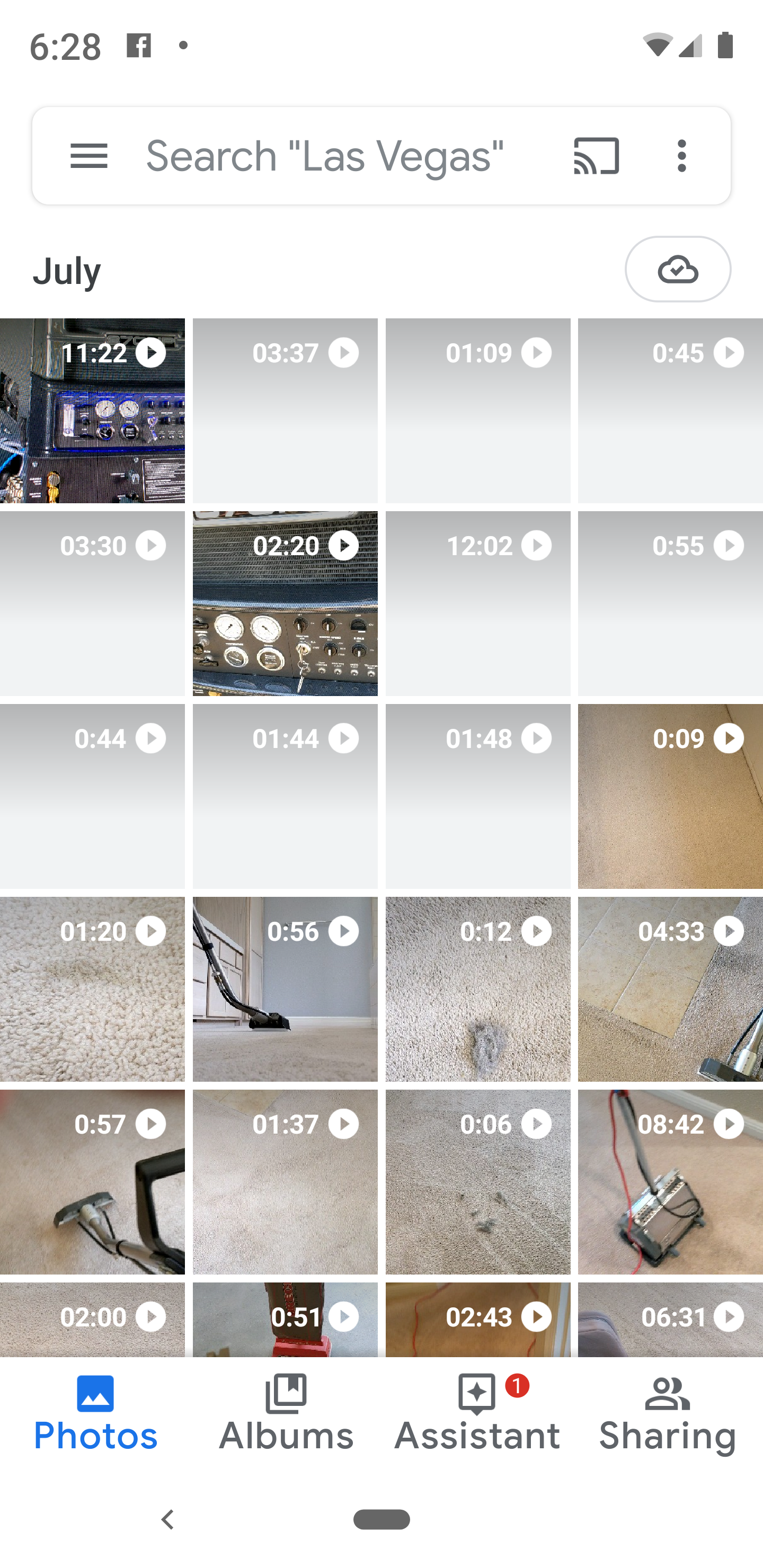

Unbeknownst to me,my Gphone F'd up all the videos...

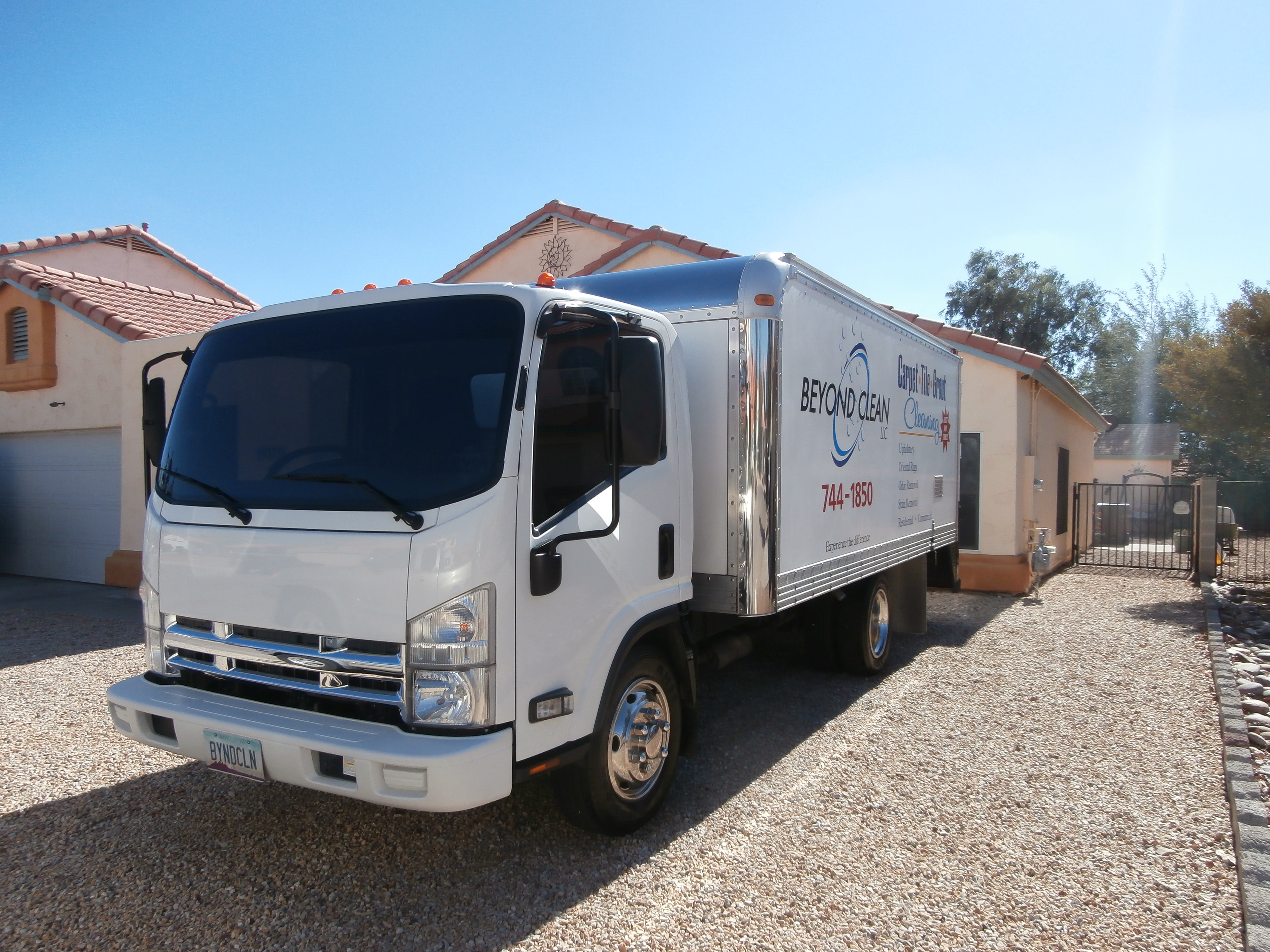

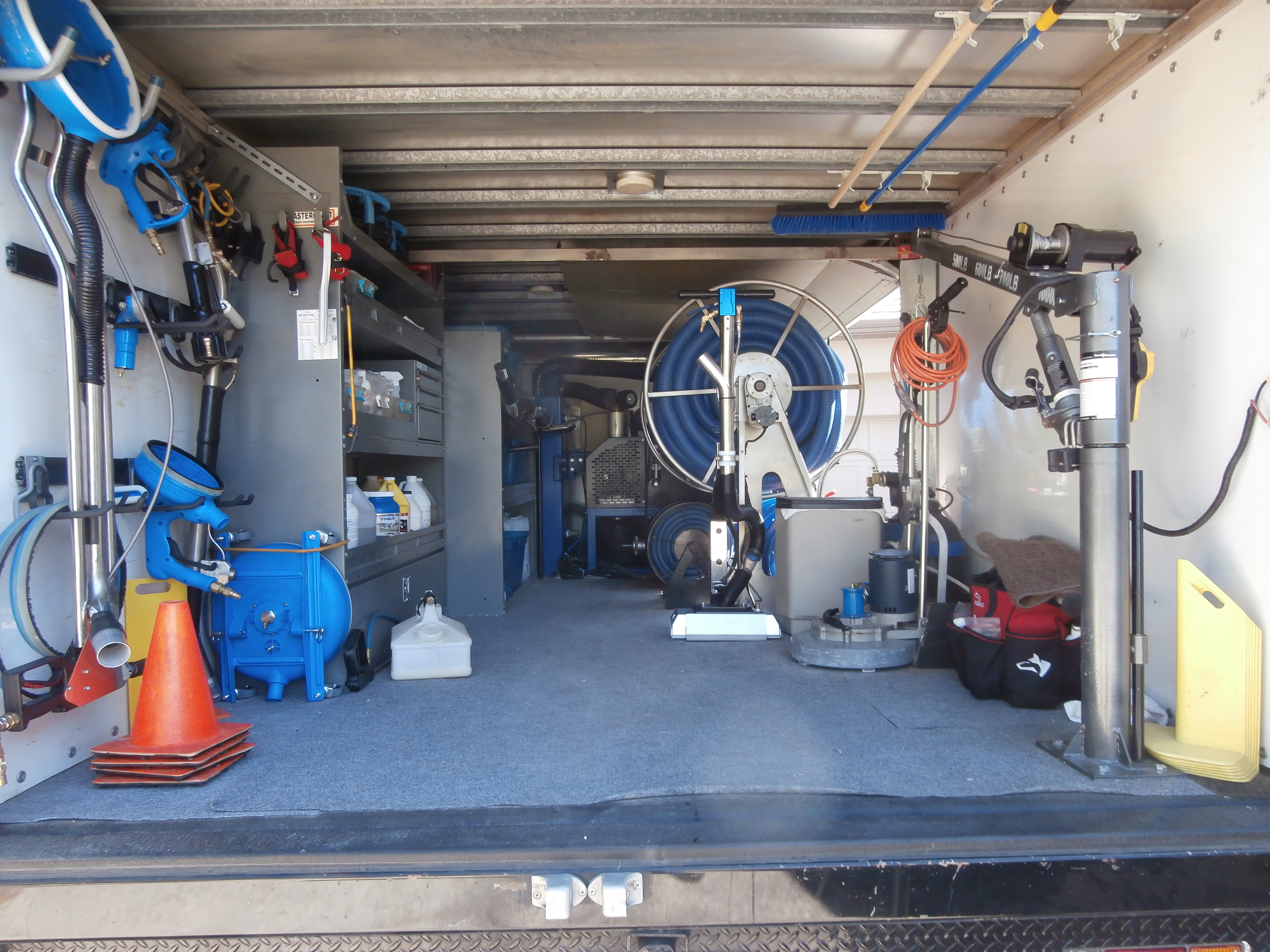

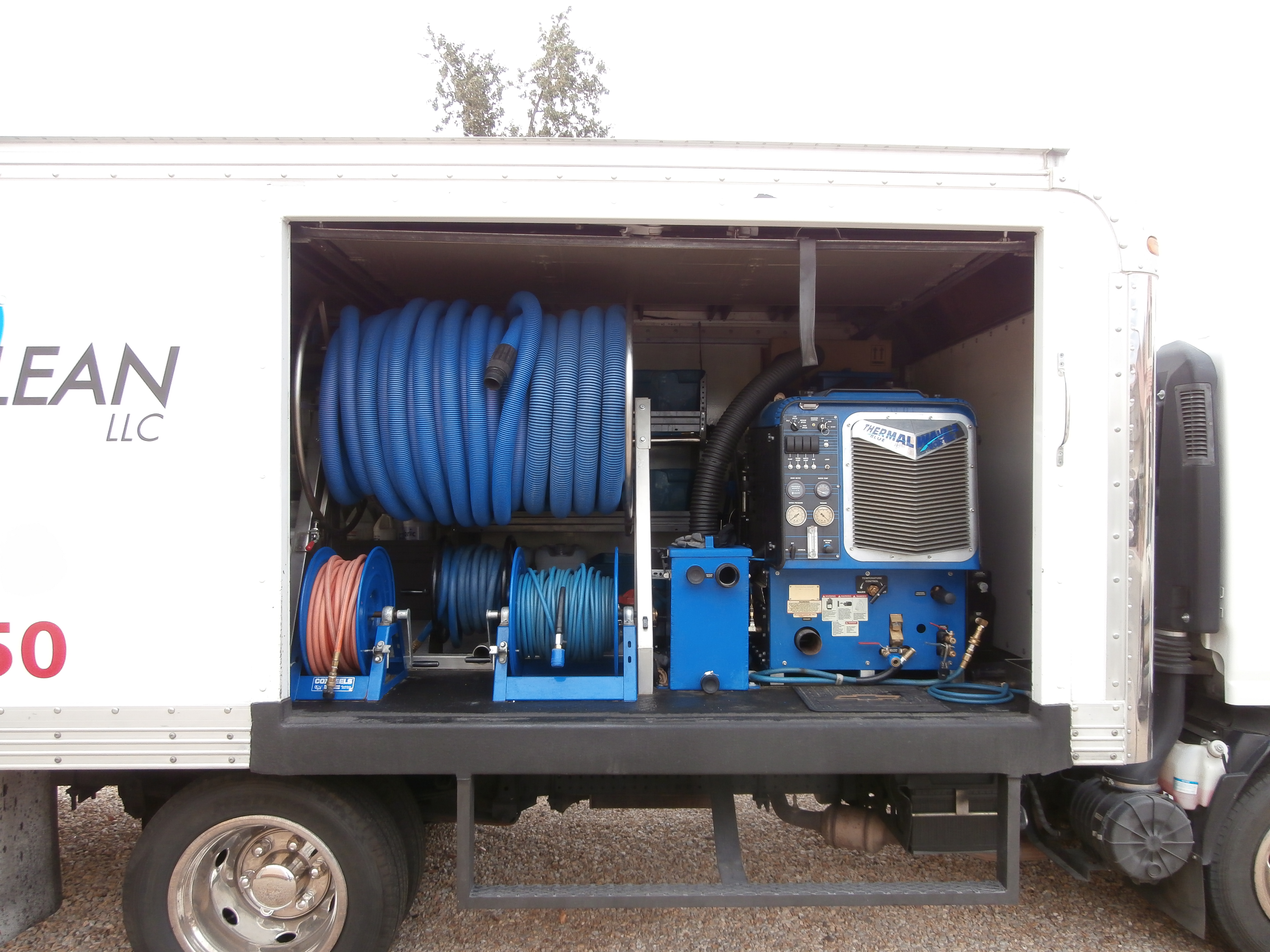

they would be crazy not to build a set up like this and put an 870 in it.....Chevy W4500..runs on unleaded fuel......16 foot low profile box....this one is a large capacity truck......it runs a GVW 14,500 and 19.5 tires...so they are built to haul weight...even with my tank full.....it's like that truck is empty.... 300 feet of vacuum hose... 150-gallon waste tank with a live A.P.O...I don't use a fresh tank...I really have no use for them....but there is more than enough room and load capacity to run whatever you want......no direct drive...no PTO...one fuel runs everything...replace my thermal wave with an 870....you are set for anything.......
