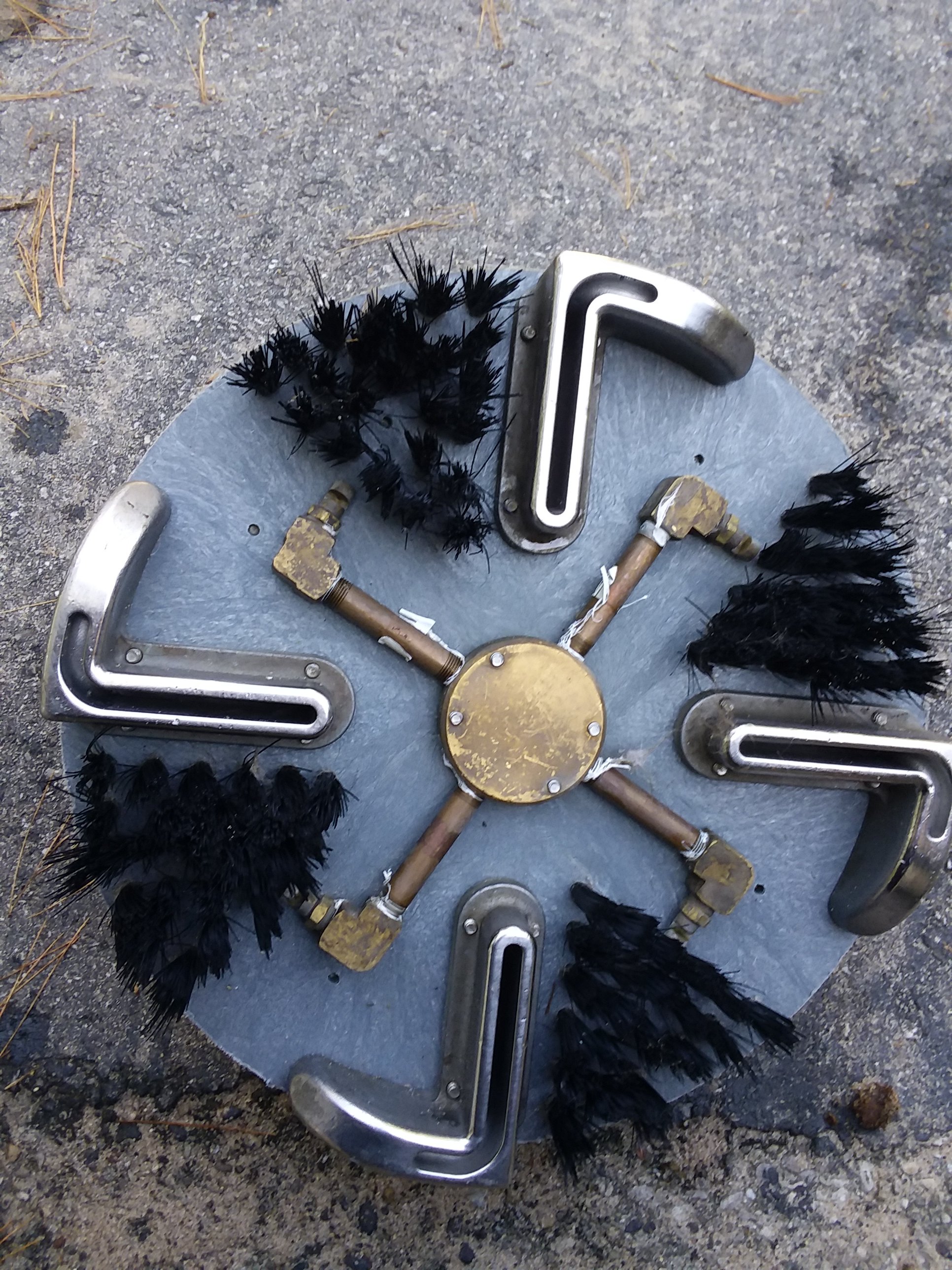

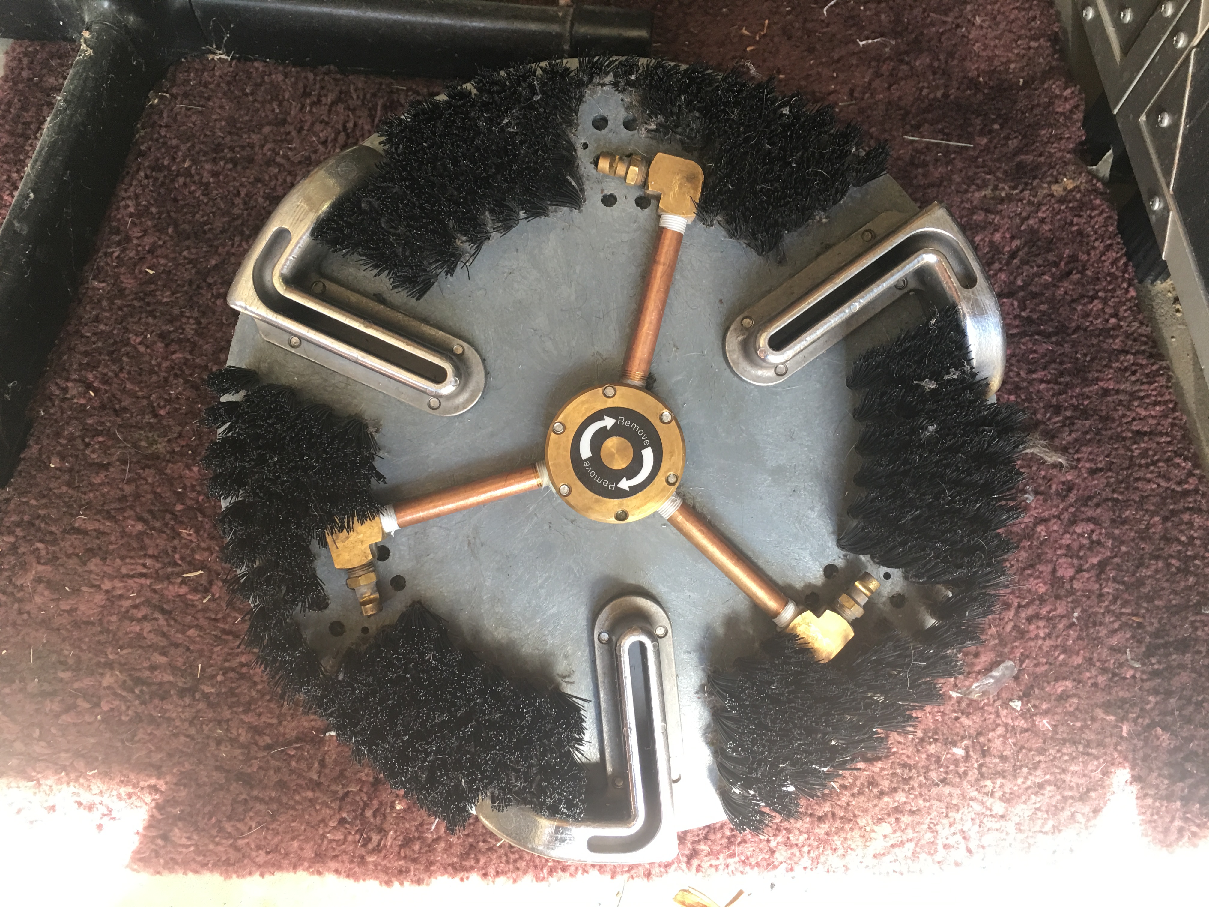

Final version with custom brush deck plate supplied by Rotovac
Thanks to @Loren Egland for the inspiration

A quad head with brushes would be my ideal for the system I used. How did you accomplish this quad with brush design?You are behind the times.View attachment 96474

drilled the holes with a drill press and stole the bristles from a regular brush head. The bristles next to the jets are placed so that on a long nap carpet the spray pattern is maximized. When being used the bristles bend back a little and the spray basically hits the bristles.How did you accomplish this quad with brush design?
