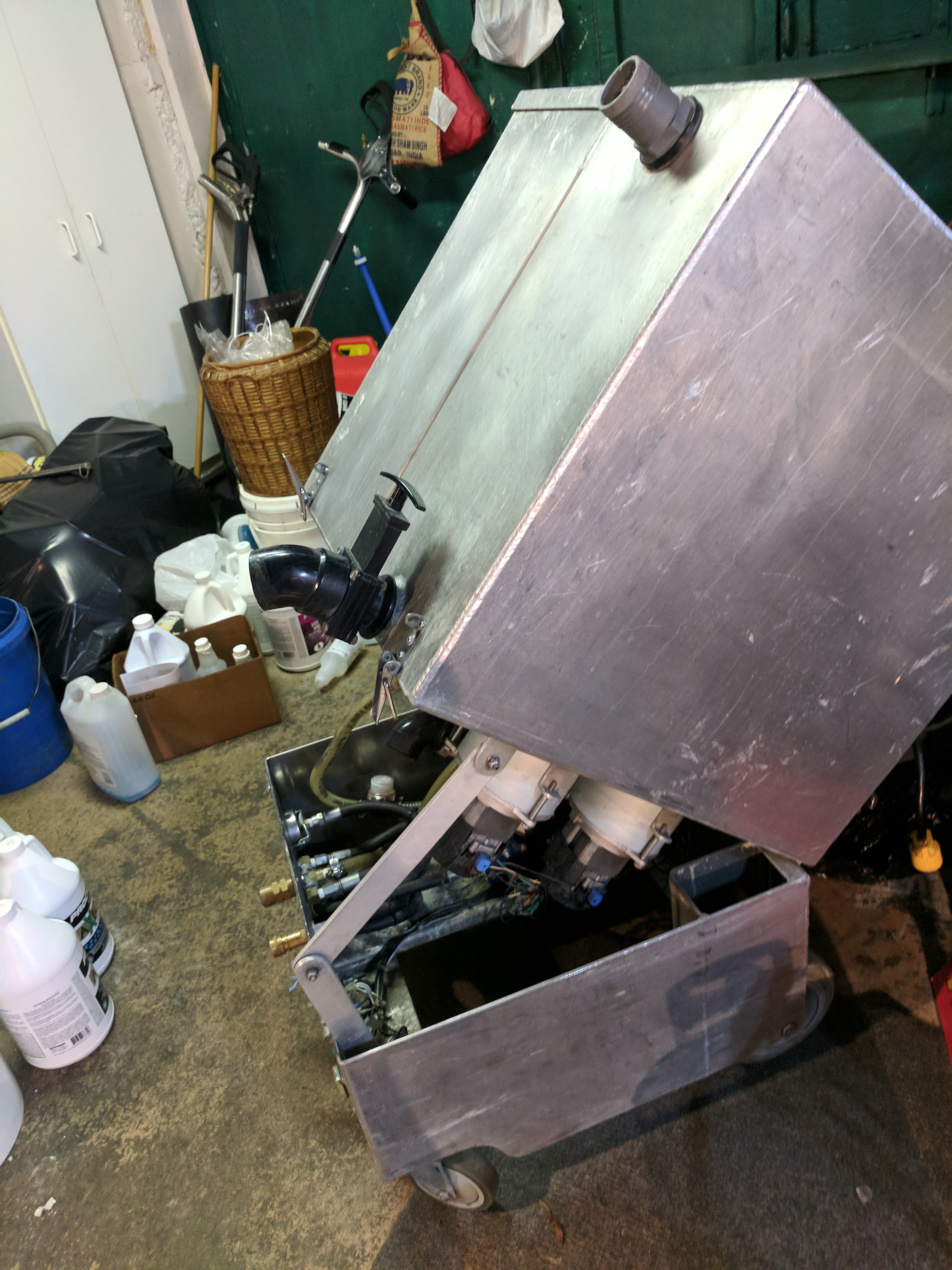

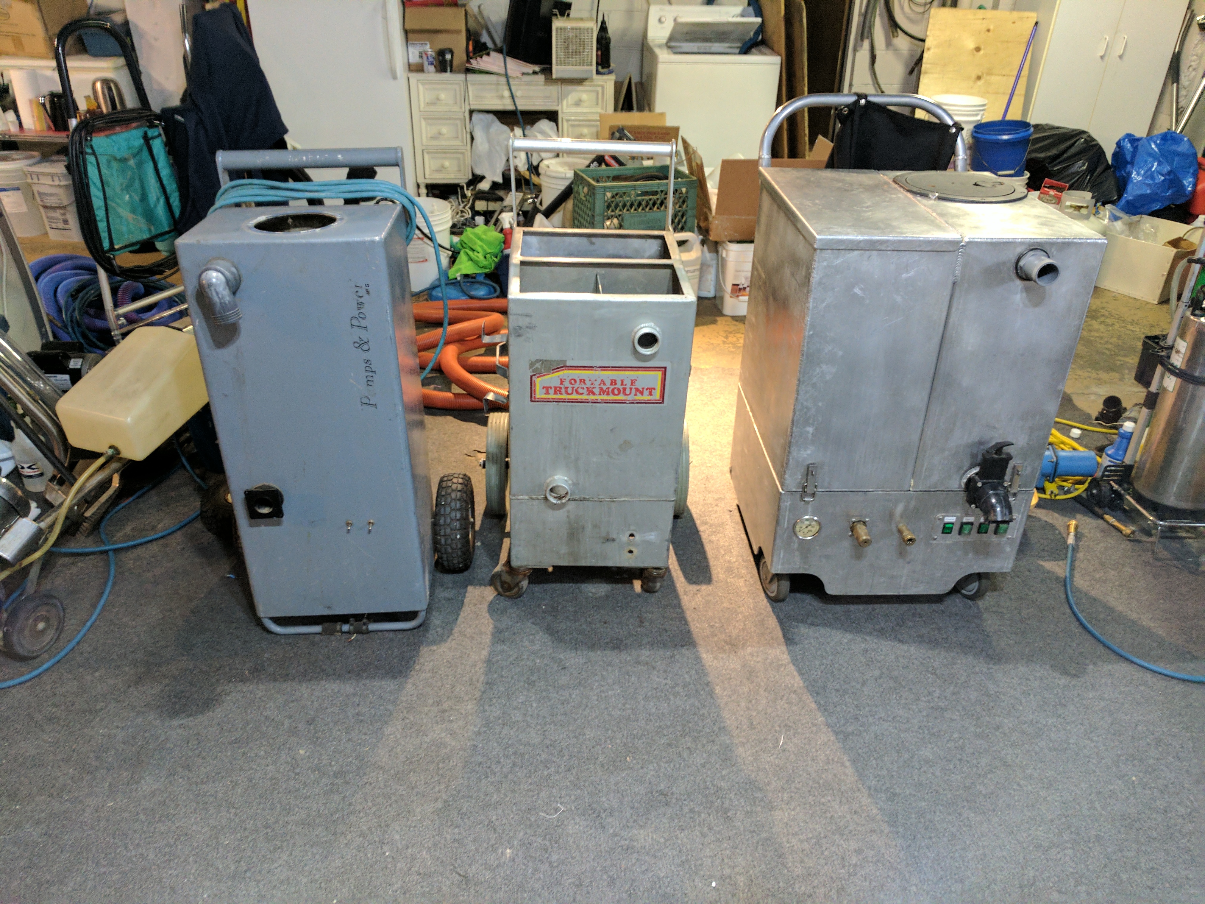

24 gallons for the big one, 12 for the center, the other is just a vacuum tank. Pressure is 500 psi at 1.5 GPM.(tested) lift is aprox 10 inches hg.(also tested) true CFM is unknown but if I use the specs for the vac motors like everybody else, it's about 200 CFM. I have tested the amperage draw with a clamp meter and the draw on one cord is 12 amps and on the other, just under 15 amps. The rated amperage of the individual components is higher but that's what it takes in real life. If I had more money, I would be testing the 6.6 and the 8.4 motors. In theory they don't take any more amperage than my 5.7's.Wow .. nice weld job !! How many gallons on the middle and one to the right? What do they weigh? Have you measured cfms and lift? If so, what are the numbers?
