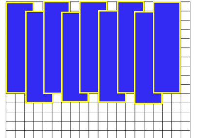

Proper stroke in my opinion is trigger on as you pull it towards you. Push wand up over the area you just cleaned. Overlap by 1/3 and repeat. Then dry stroke over the same area. Straight up and down, no sawteeth.
I agree 100%. What I am seeing in these videos is guys spraying up at a angle, coming down at a angle and then spraying back up at a angle. So your spraying water back down on a area you just cleaned.
I clean on a straight backstroke
Sawtooth over (dry) to the next backstroke..................overlapping a bit
clean straight backstroke
repeat until row is finished
sawtooth drystroke back over row....start next row
any other way is wrong..... I don't care what any of you say

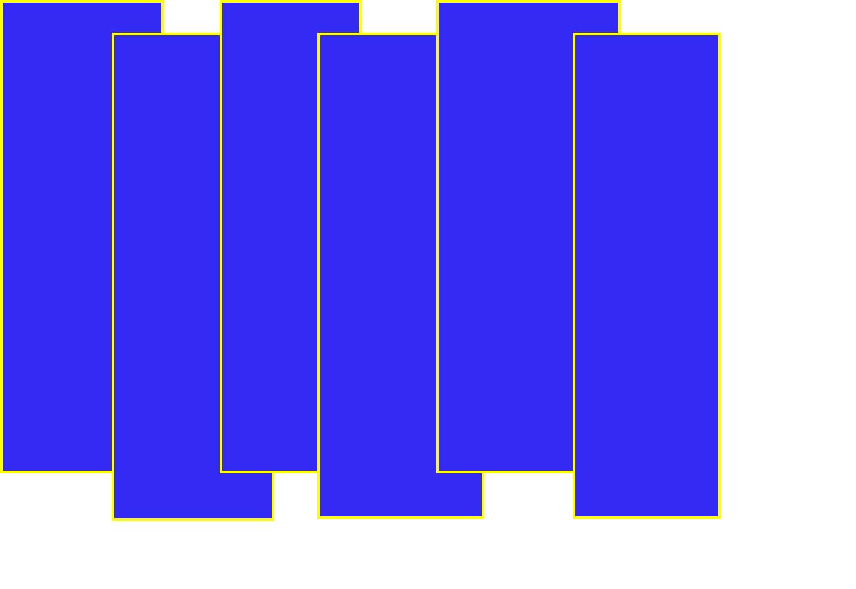

So that way assuming jets are all the same you double rinse two strips of 4" and leave a single rinsed 4" strip in the centre. Now that could make for a nice pattern, with uneven drying and wick'back:headscratch:
We overlap by just a smidgeon and lift the wand for the next pass when doing domestics. On commercial different story as they are usually low pile synthetics that don't hold a wand mark much
roro
27,987
roro
That doesn't make any sense at all. If we overlap by a third, the carpet gets flushed 3 times.
