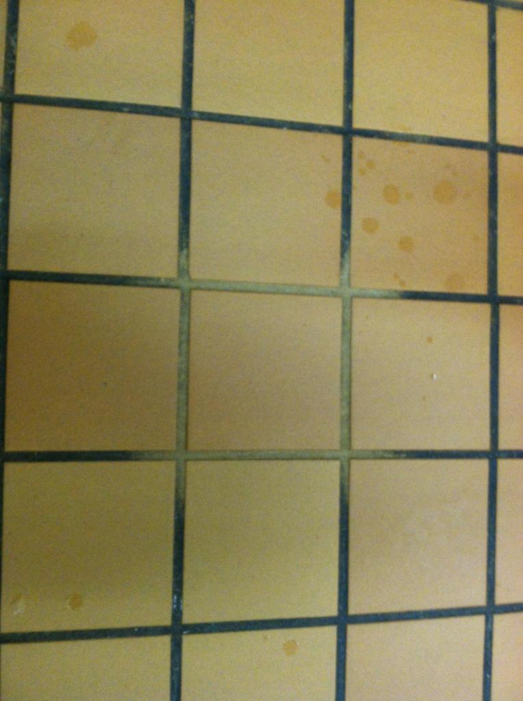

Do you recommend sealing a commercial Kitchen??
Looked at it today, 20 yrs old 6 inch quarry but they are tan.
Nasty grungy grout joints. Never been steamed. Gets mopped 3 times a day.
Don't want to rip them off if it wears off in a few months.
It's a Battered/Abuse center for Women.
Flex straight from HydroForce with soft brush for demo

Not in general, kitchens usually use bleach or other harsh chemicals that will eat sealer off pretty quick.
