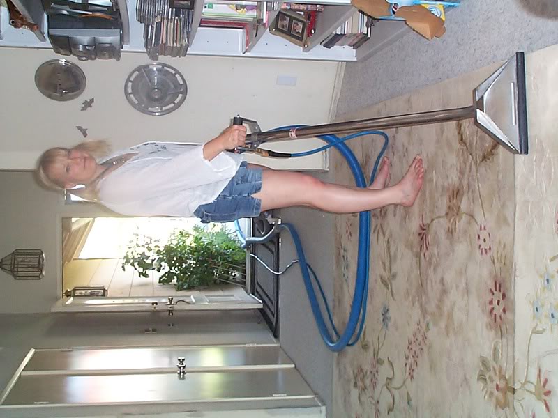

The Evo glide is Delrin not nylon. I've used Delrin glides extensively, there biggest downfall is snagging and roughening over time. if you run one, it's important to sand it regularly to keep it smooth because it won't burnish over like Teflon does. Here's a pic of me using a Delrin glide:
