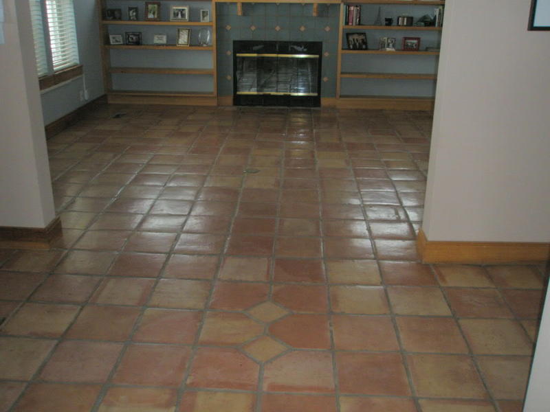

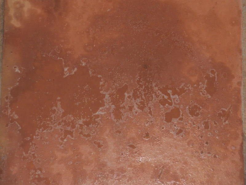

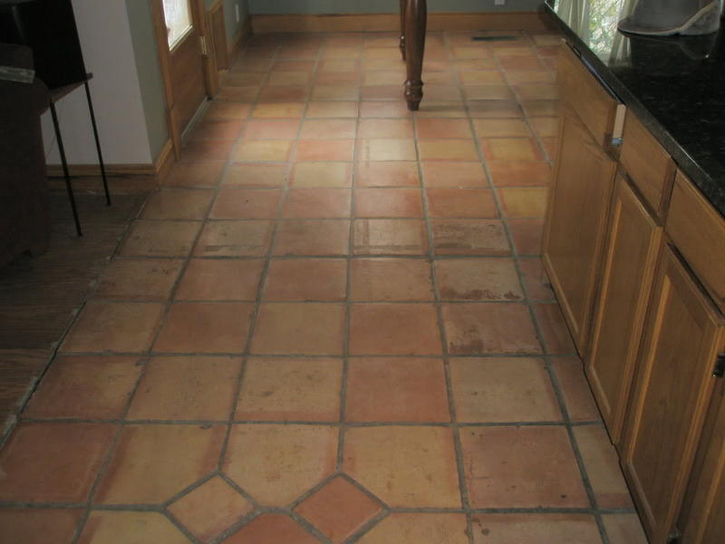

This was non factory finished saltillio tile. Be very careful, this is the first saltillio that has give me a problem. At first look every thing seem to be standard.
after stripping i noticed we had a problem it was ployurithanie omg what a fricking night mare.

When I bid the next one I will pull a air register and inspect the side of the tile If it has been factory baked and finished it will show about 1/8 in down in the tile. I f not just run.
