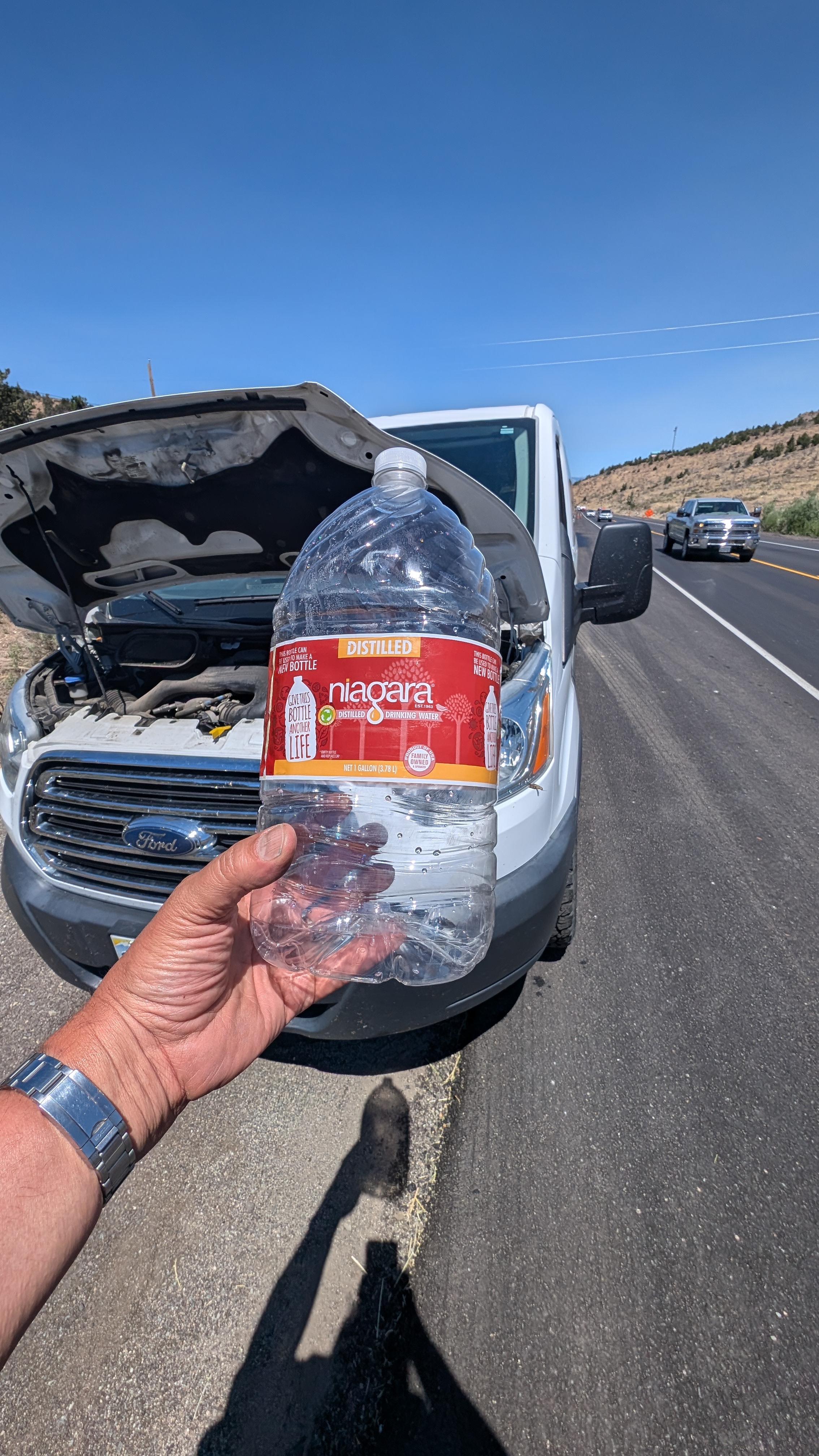

There's at least two reasons to always keep distilled water on your working vehicle
116,052
Virtually every two lane road in our county is being repaved this year and sitting in the stalled traffic at 95 degrees cuased it to over heat....

You sure the cooling system is up to par?

I carry a gallon of 50-50 on the truck, and 2 quarts of engine oil.
I’ve got them tucked into a corner, just in cases as this…
We also run a large snail fan on high directly on the engine during jobs right now…
This heat is no joke.

the lectro fan doesn't run all the time
It only cycles on when a certain temp is reached, then shuts off
I know you're hard of hearing, but with you hearing aid, you should be able to hear it cycle on and off if you can't see it
Water pump is failing.
"Most likely"
how do you figure?
It's belt driven.
If not dribbling water, the impeller is circulating coolant
I don't believe water pumps work sometimes and sometimes not
confirm the cooling fan is working or not
if it is, flush the cooling system and replace the thermostat

The coolant evaporates when the leak is slow.
Sometimes you can hear the bearings making noise.
I've been nervous with my van for a couple months. It was making too much noise. Mechanic said nothing wrong.
Finally got a code the alternator was bad. Replaced yesterday.
I feel so relieved today. Got a big job an hour away tomorrow. I've been stressing knowing something was coming.
Get into the shop. You are causing more damage to the motor letting it get that hot. You have to fix it anyway.

I have had water pumps fail because of the bushings or bearings have worn out. Still spins but not at the right rpm. Will be ok on the highway but will overheat under a heavier load like going up hills. They don't make the impellers like they used to.
