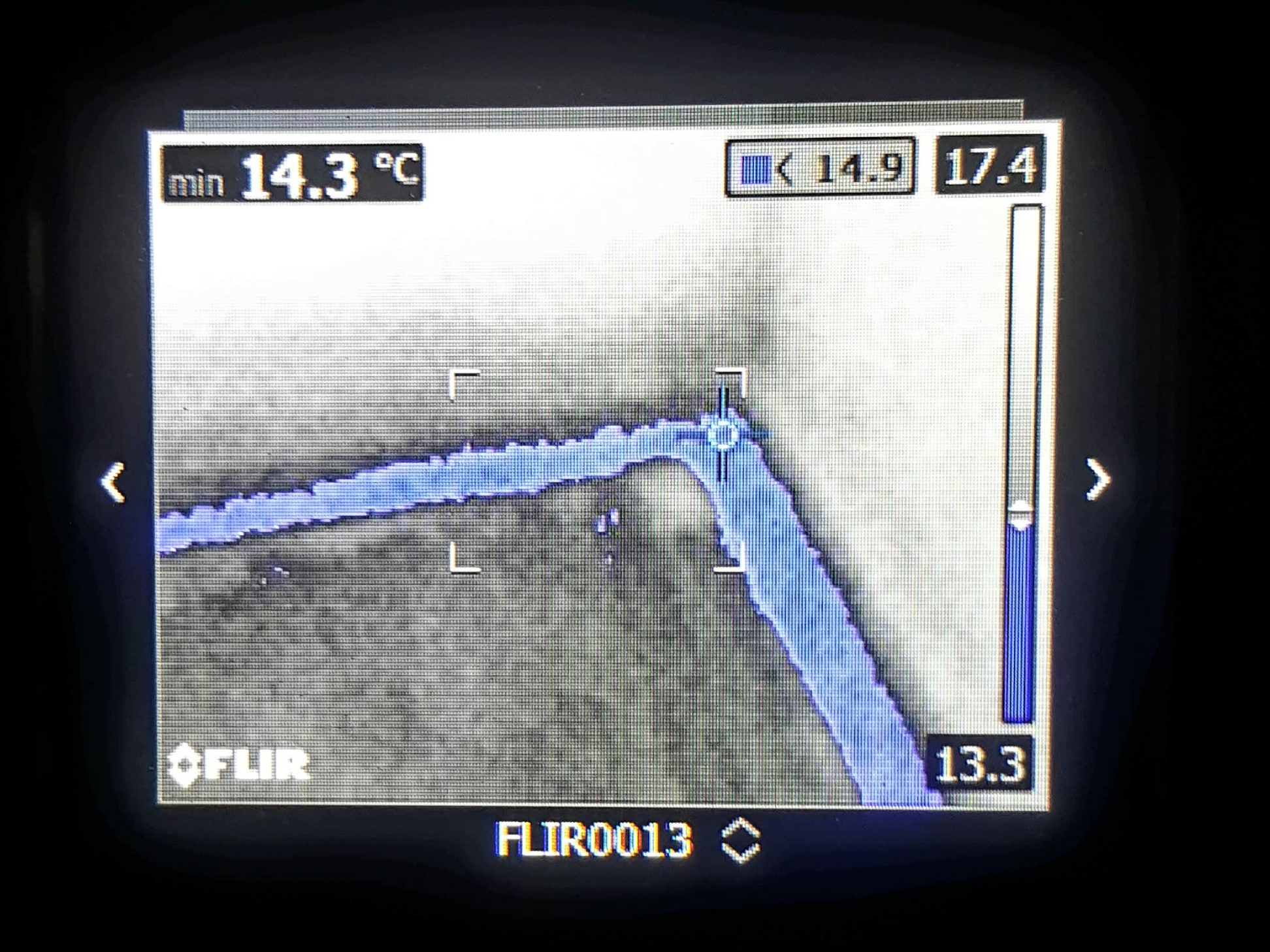

thermal imaging shows difference in surface temperature
which helps pinpoint an area to investigate further

If there is a big enough temp difference from seepage or evaporation to affect the surface then yes (depends on unit how sensitive)
If its a slow leak 6" below surface and the water isn't surfacing there, or is same temp as the surrounding concrete it wont show a variance
If you've got water coming in it should highlight a cooler area somewhere
