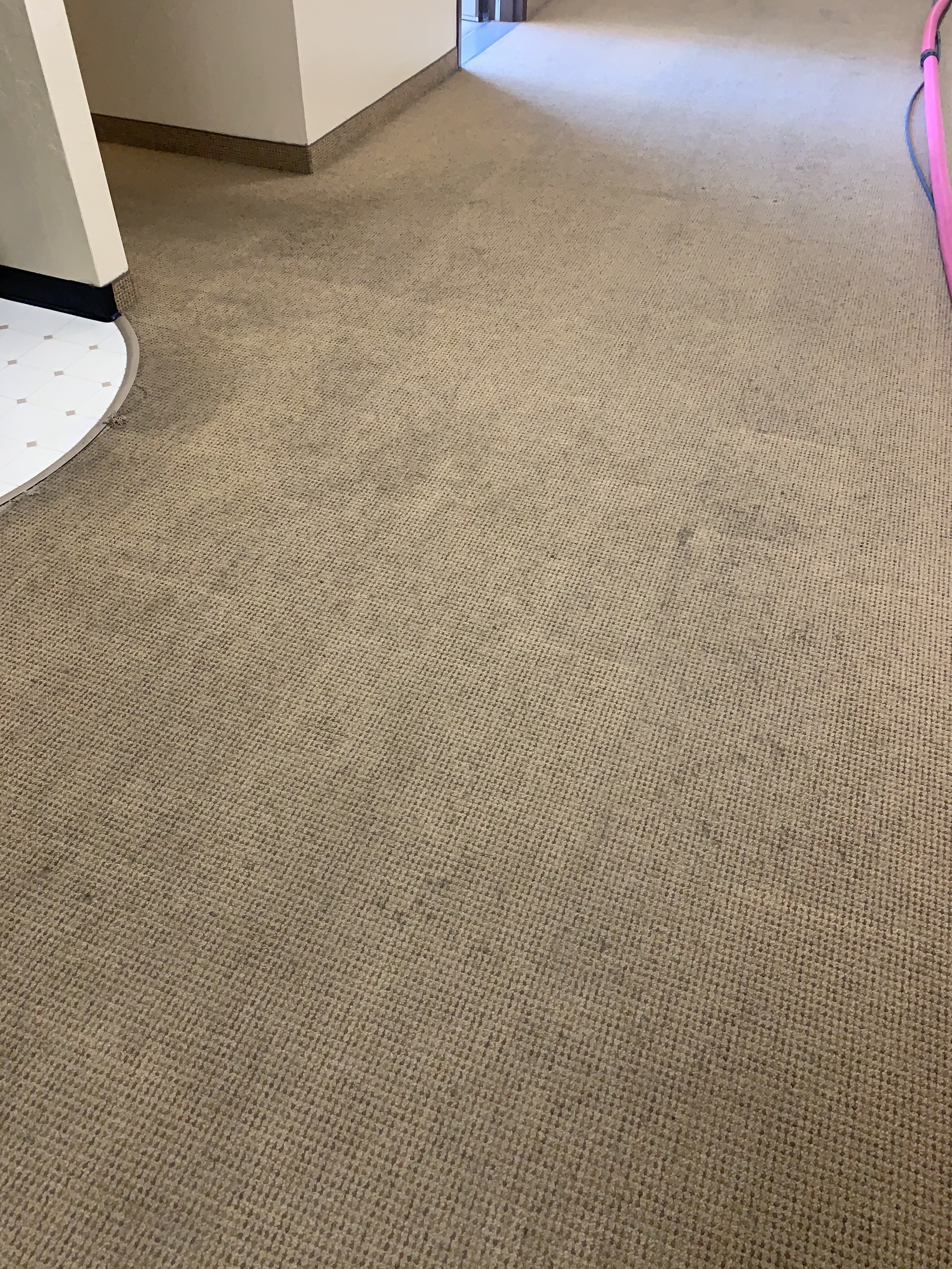

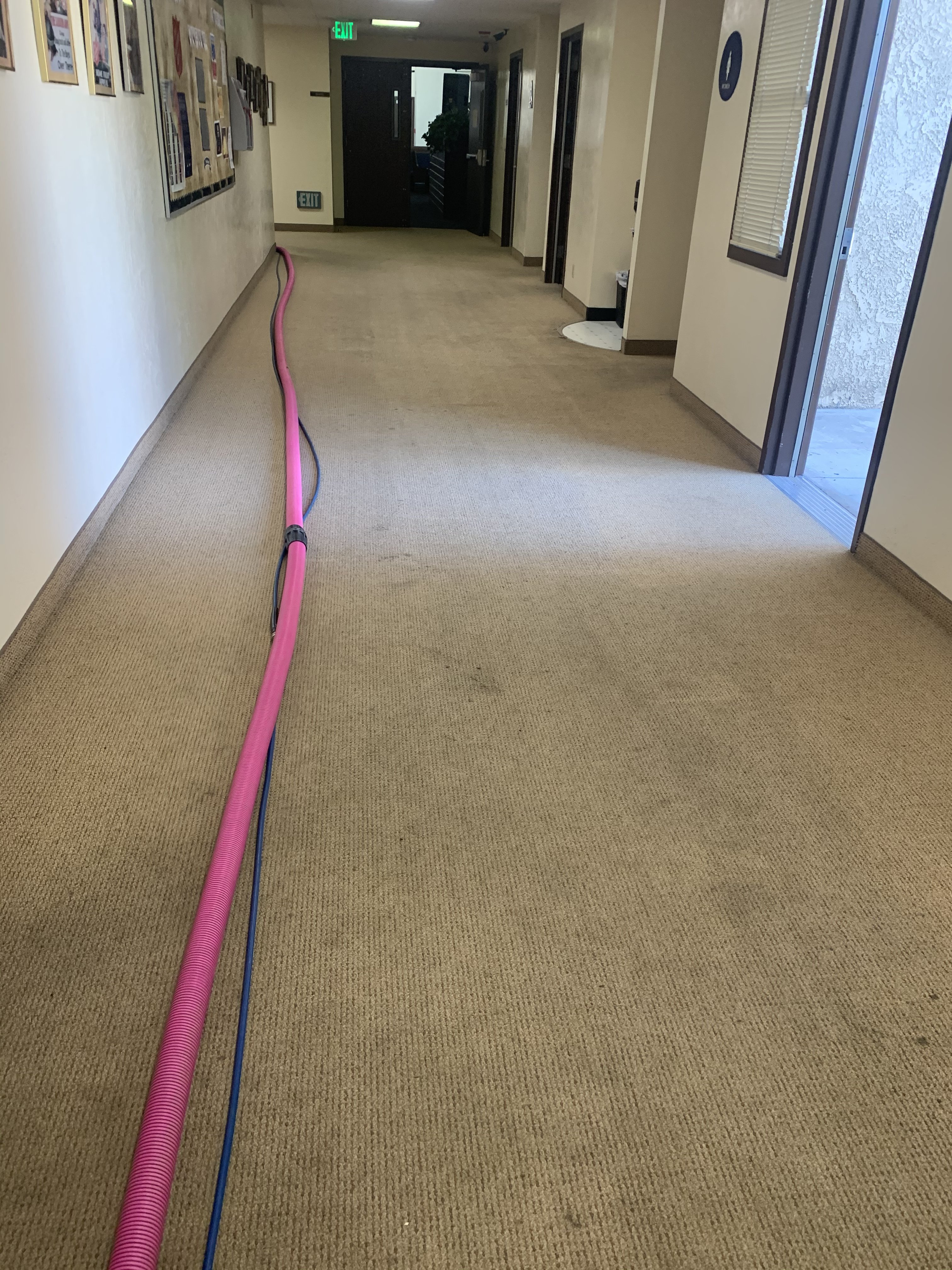

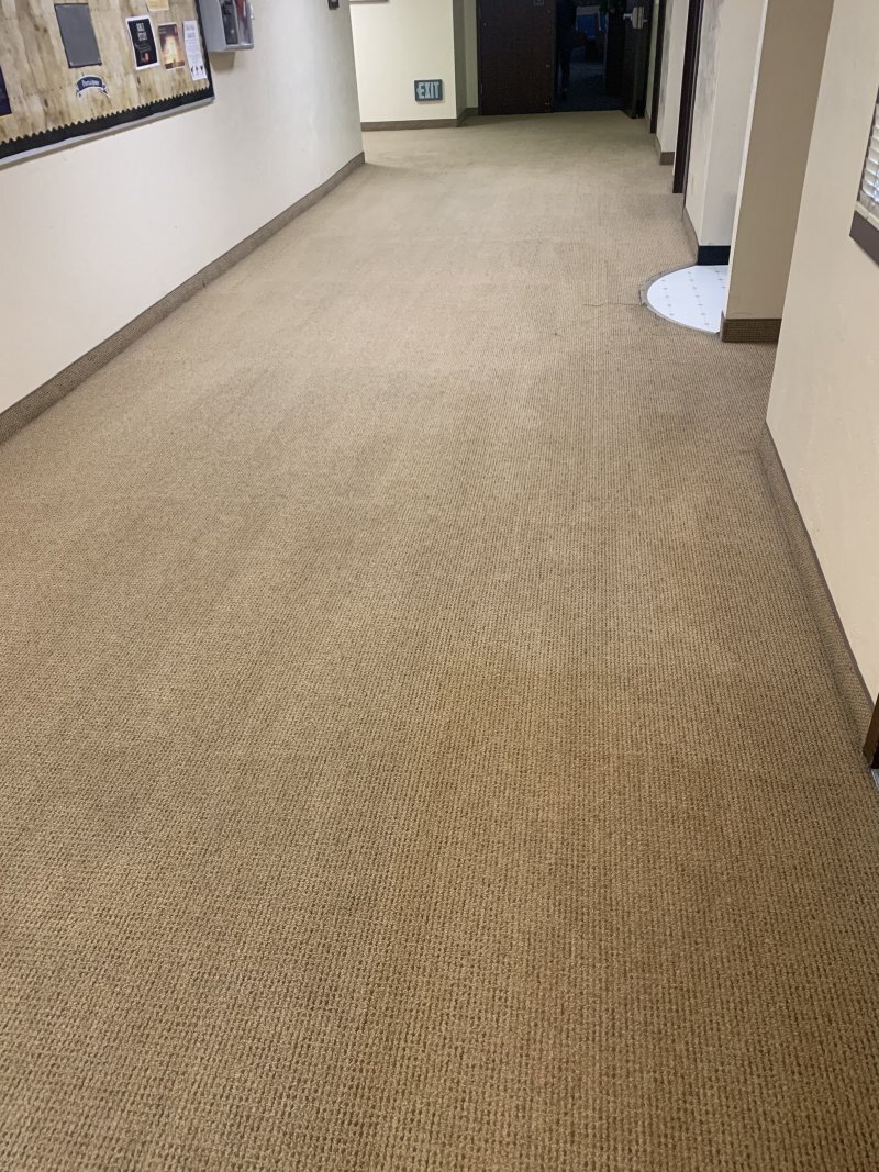

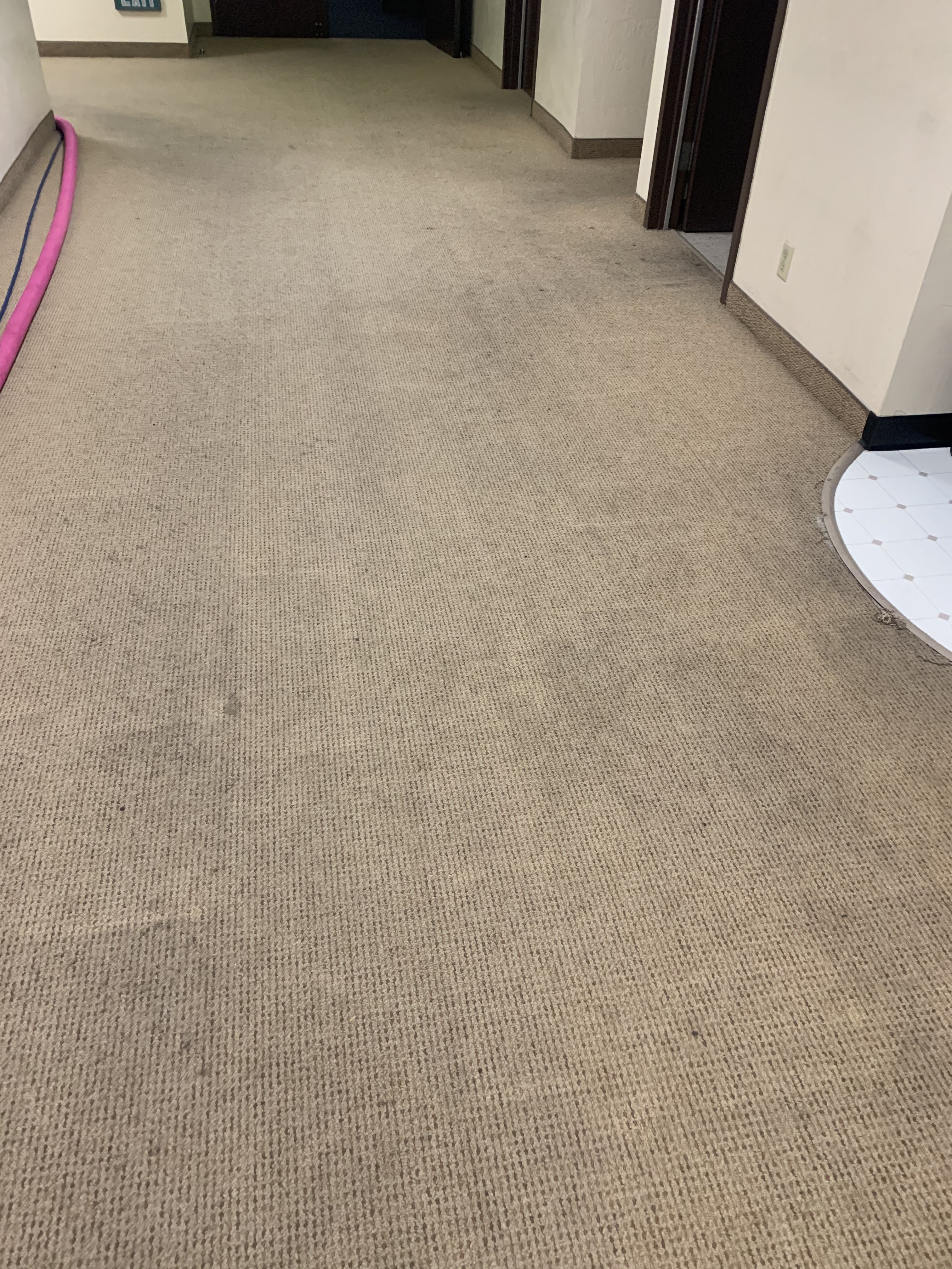

I quoted this account two weeks ago they scheduled at the beginning of the week for us to come out didn’t think much of it
When I arrived I found out that it was just cleaned by the competition and they were unhappy with the work
My price was considerably more and the other guy promised the world
To be fair the carpet was darker and there were some large spots that are gone but obviously there is a lot of room for improvement
This group owns 20 properties in the area
Will update with pictures as we go!

There are more lousy carpet cleaners out there than good ones. Not hard to out clean them with a little attention to detail. Having a little scrubbing power, whether it's a CRB or 175 can make all the difference as well as doing enough dry strokes or using fans to speed dry. I find it amazing that a lot of commercial cleaners don't do dry strokes at all. There reasoning is often that it has all weekend to dry. It also has all weekend to wick up and brown.

I don't usually turn down my psi. I like being able to flush what I've already put down. Just be sure your wand is extracting ok and not bouncing all over an uneven floor. Flood fans are a great equalizer.

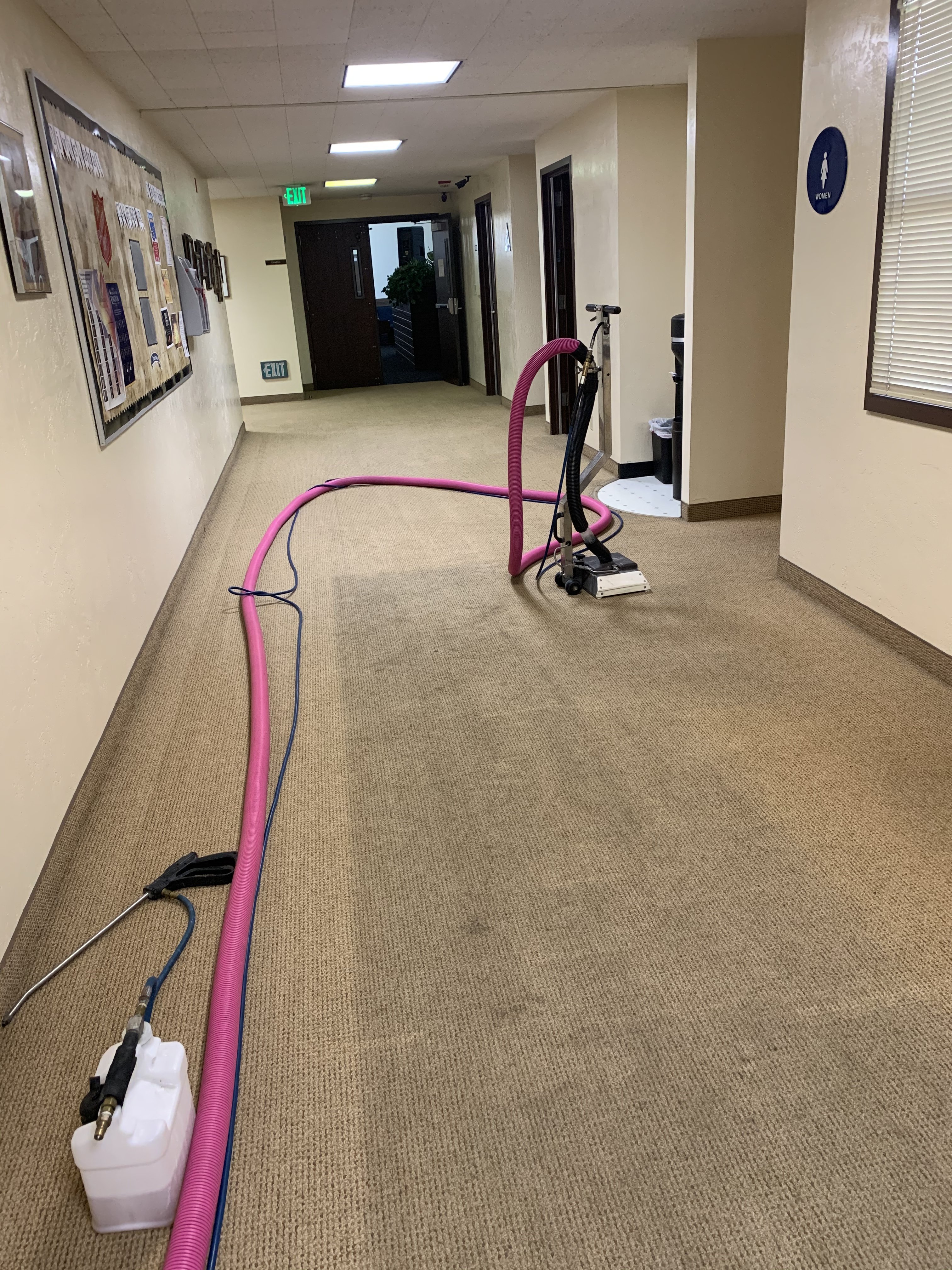

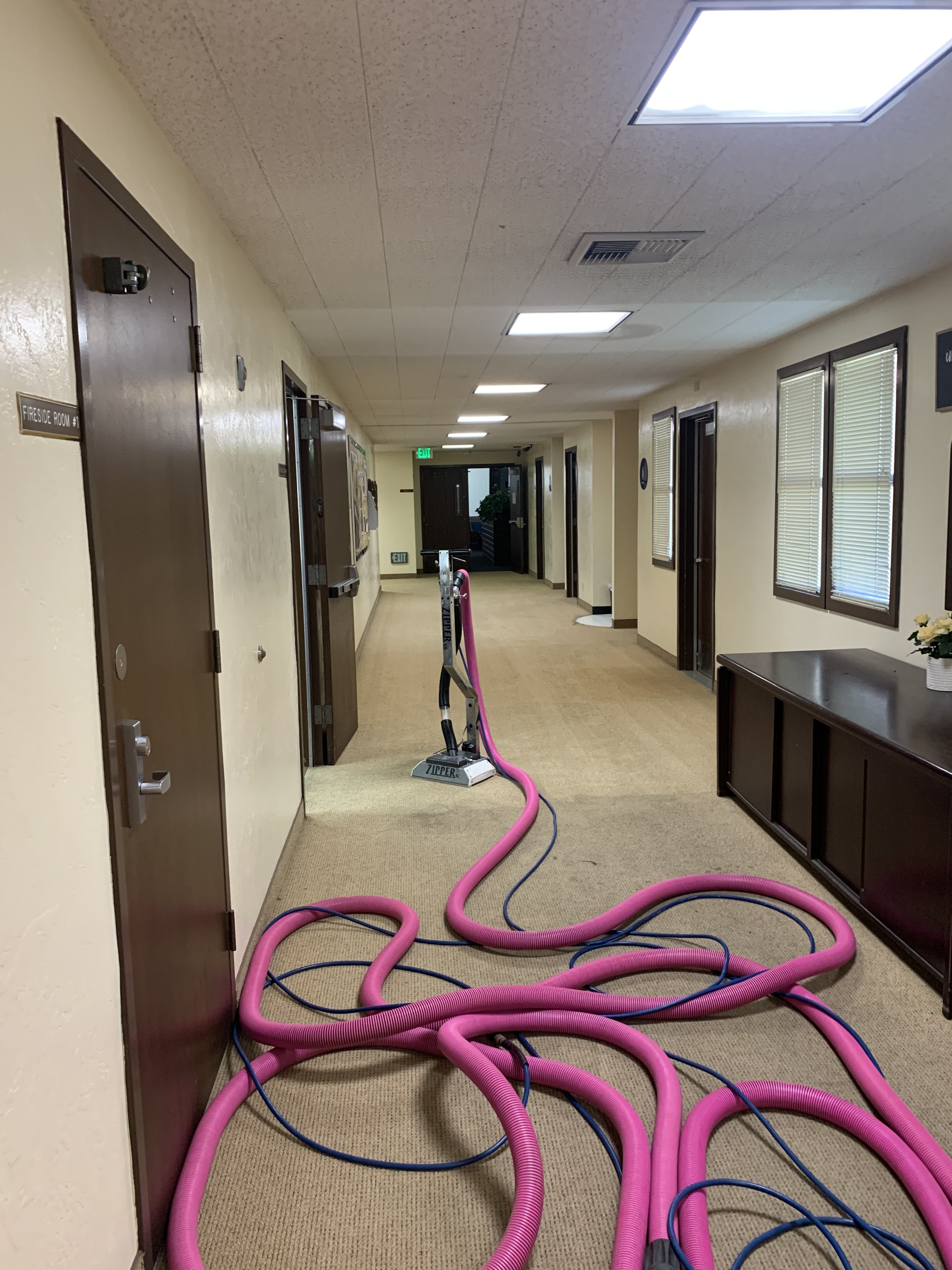

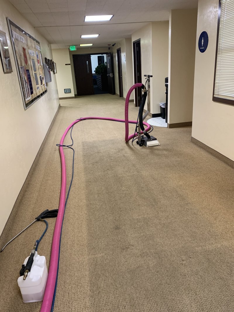

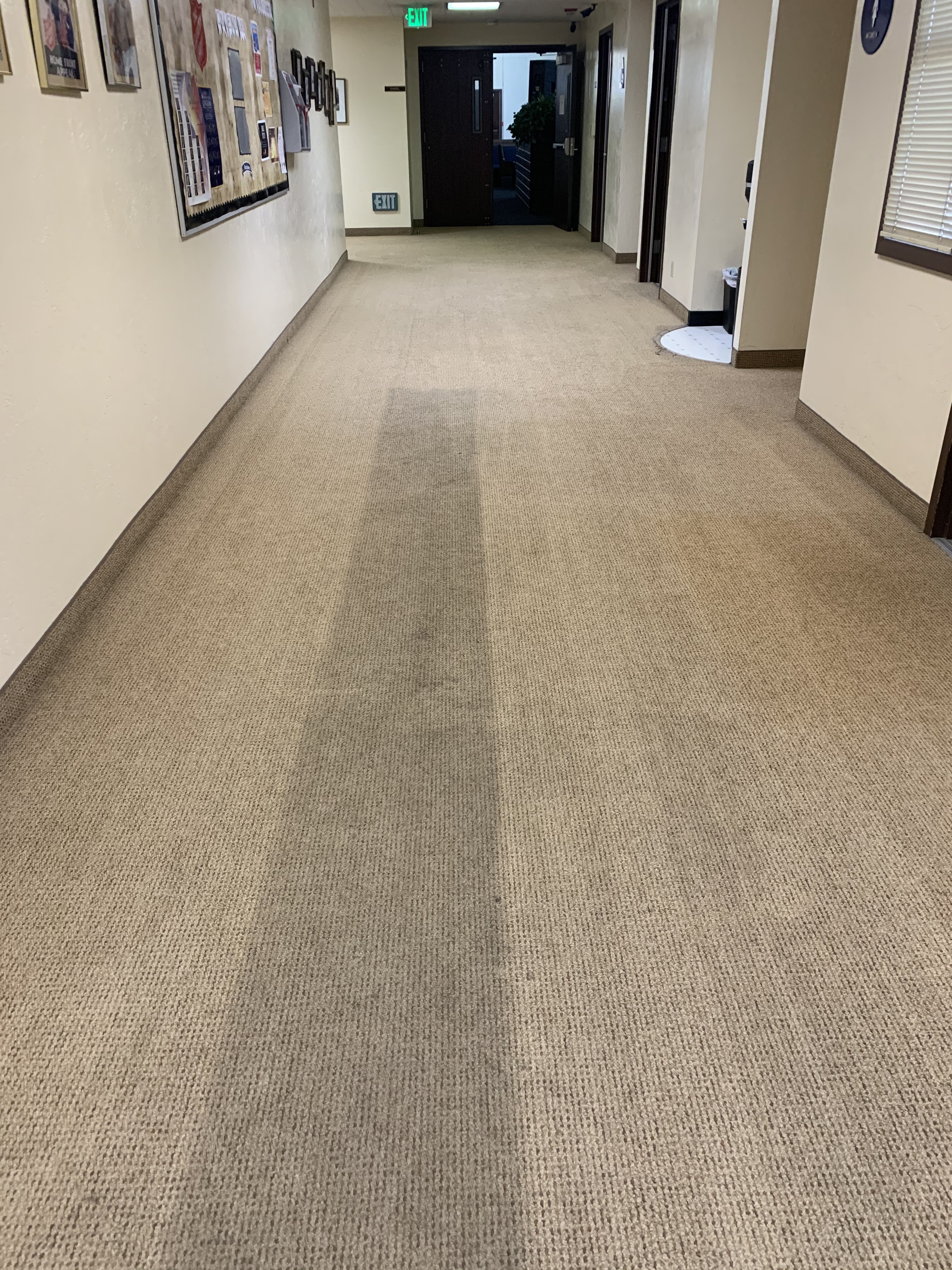

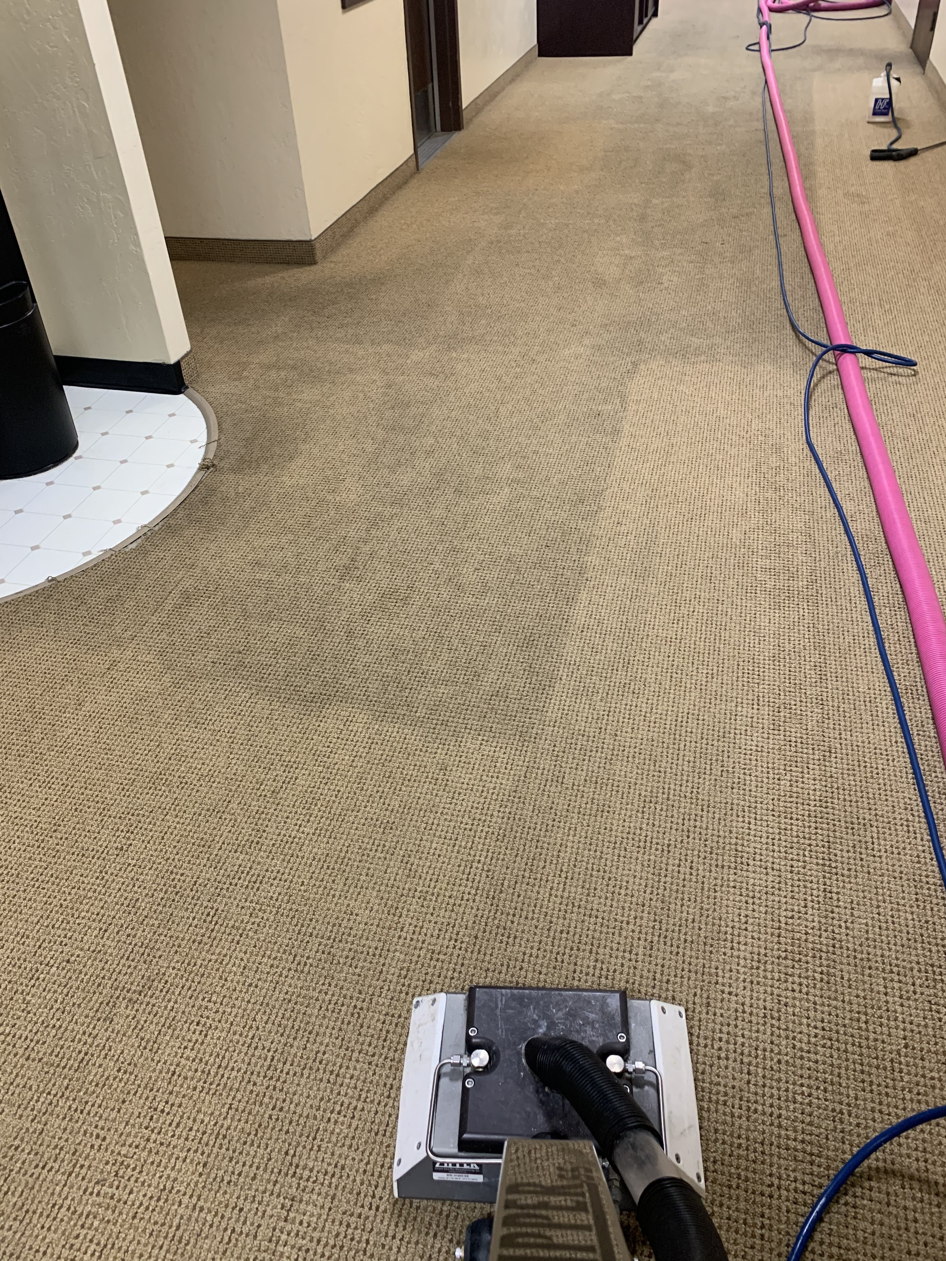

So much foam it’s crazy lol it’s moving slower than I would like
Probably need to post bonnet
Also everyone thinks they should be walking on it as I clean

Prep them for the likelihood that you will need to do a touch up. After it dries just a quick once over with encap on any recurring areas.
Exactly I scheduled them for a “low
Moisture post cleaning” in two weeks
I explained after the years of not cleaning and cleaning improperly we will need a few cleanings to get it back to being under control
Then we will clean less frequently

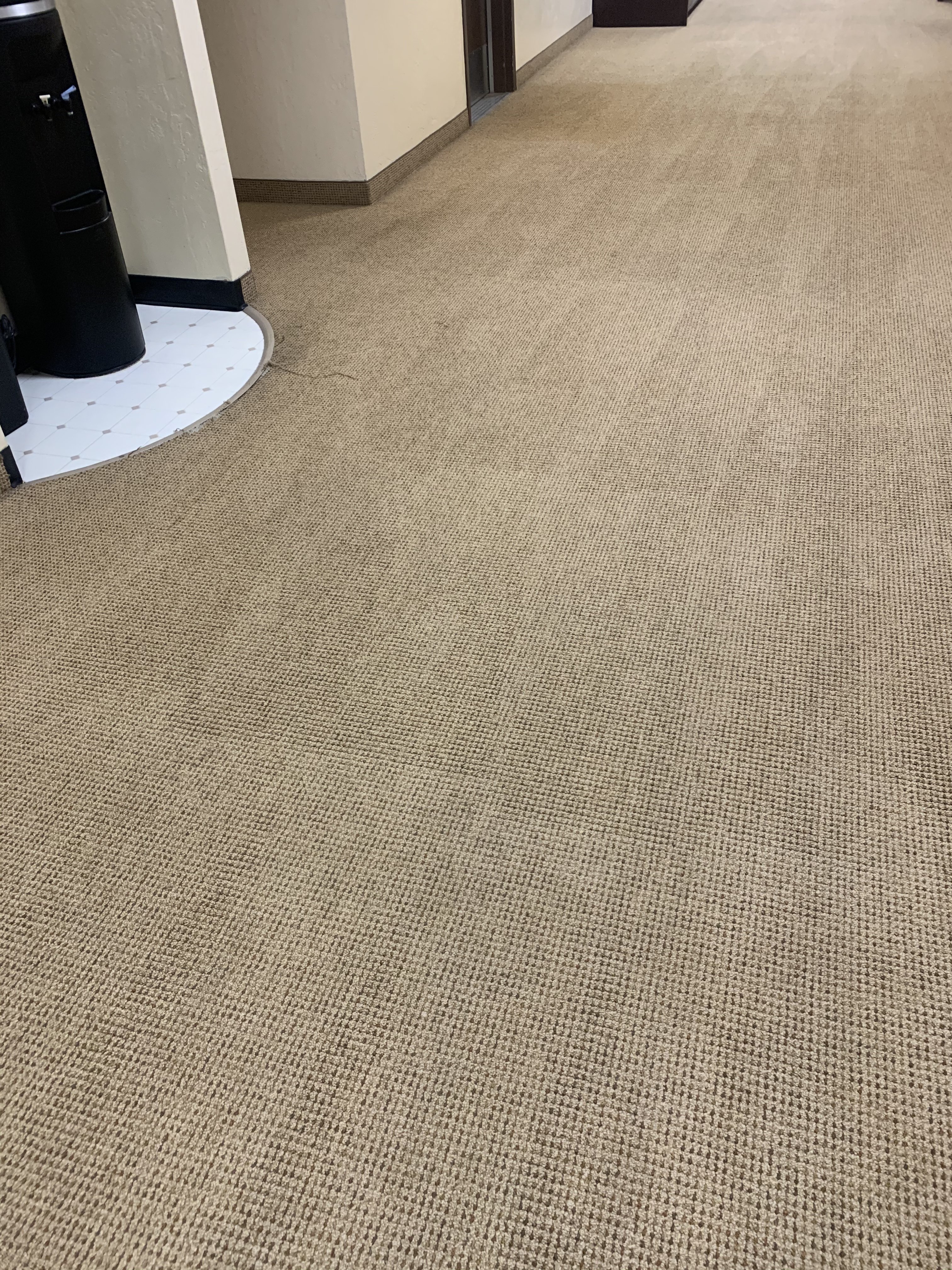

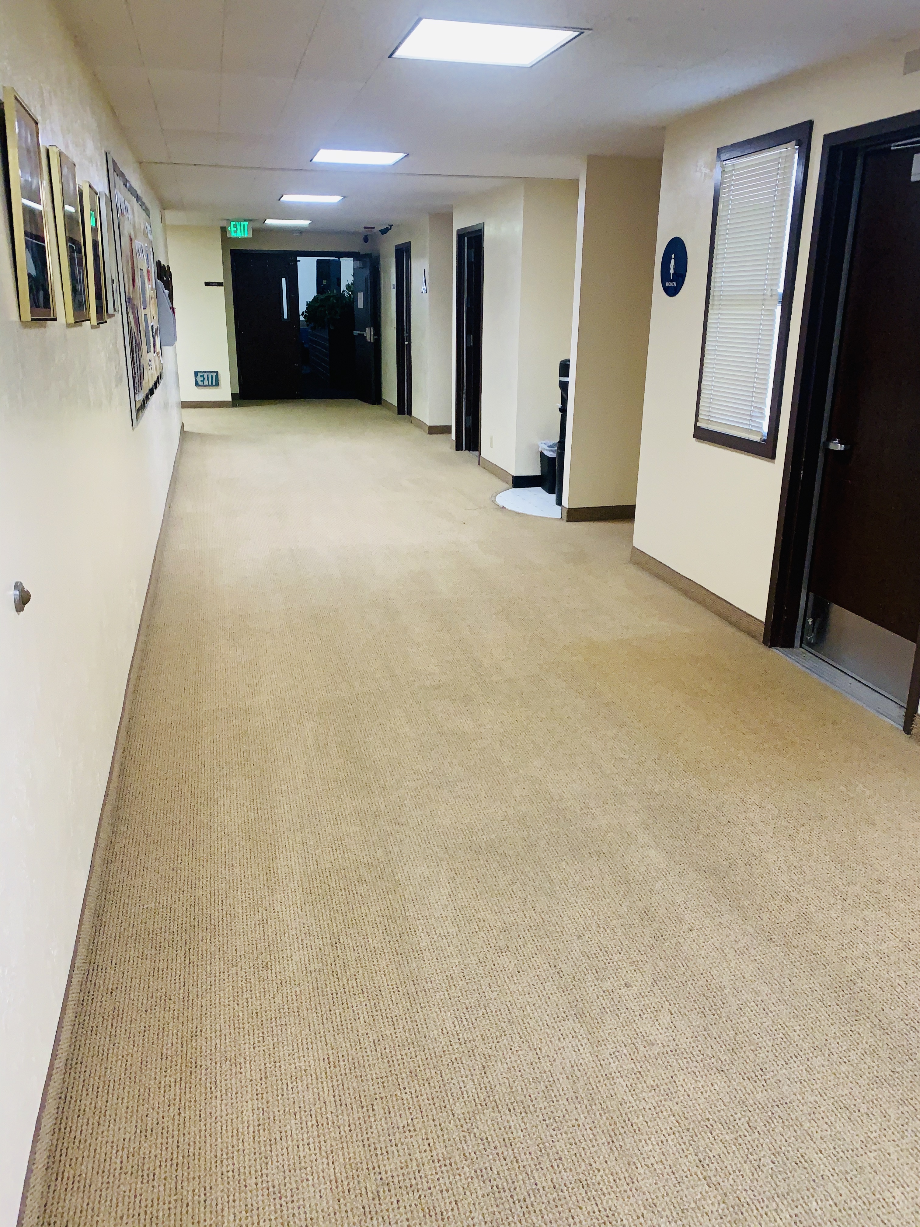

Honestly it’s better not 100
But better
They are blown away

Yes most guys are always looking at the watch with every wand stroke around here.
Full on water up and back wand pass with no dry strokes at all.
They think I am crazy for CRB scrub, cleaning so slow and wasting time on those dry passes that don't do anything.
Great job on that restoration cleaning Brightside.

Jay, It brightened up so much it looks like you re-lamped the light fixtures! The owner should name his next legitimate child Jay, out of gratitude.

No that’s me messing with my camera trying to not pick up all the weird shadows
It looked amazing but for some reason on my I phone it picks up weird stuff

I do like the crb but for the price I don’t know
On bad jobs I rotary and then “groom” with my wand while I edge
On commercial I pretty much only use the zipper I’m obsessed! If the floor is uneven I will wand then bonnet
