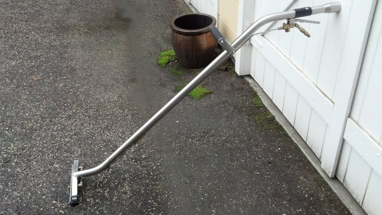

Anyway, today I asked him for a price on a tile edging wand ... stand up variety ... and he told me what I wanted was "stupid".
So, my question to you guys is ... what tile edging tool do you like?
I want one that will allow me to clean up to the baseboard, while standing up. Currently I am using a PMF tool that is a hand tool. Many of you will recognize it by Magic Wands name of "Magic Grinder". I like it, but of course it gets old having to squat down to edge with it.
116,345
PMF custom made with S bend, extra long and 2 inch adaptor
49,576
Prattville, Alabama

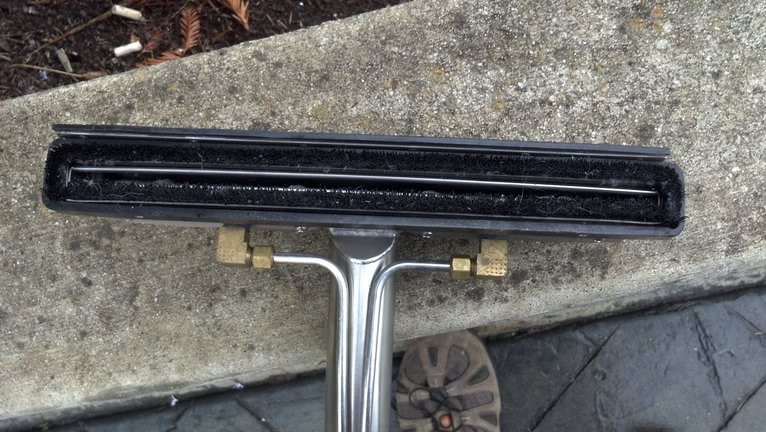

Potential problem I see with that wand is the head width. I need one that I can get into corners behind toilets and in tight places in small bathrooms and laundry rooms. I don't want a two inch hose connector either. I want to use a 1.5 inch whip. Way too much twisting around corners and tight places with the tile cleaning I do.

Unfortunately there isn't a tool available for what you want Marty. The Gecko would be ideal but the spray pattern leaves too much on the sides. Either a modified gecko with a few jets to cover the whole width or possibly chop about an inch off each side of the head.
I made my own from pvc fittings. The brush for it is the biggest pita as I have to bend a straight piece. I've yet to find a source for round brush attachments.

I got the PMF W159OSB. It is perfect for what I want. It is my magic grinder hand tool, except it is made into a full length wand.
Bought it from Joe.

That looks like the same wand I use for edging except for the brush attachment, jet and valve. I called pmf sometime ago to see if they sell the brush so that I can adopt it but they said they couldn't.
Let us know how it works.
