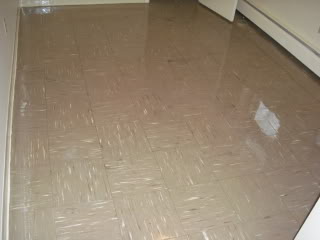

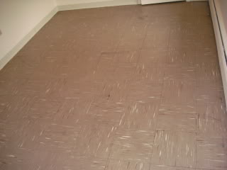

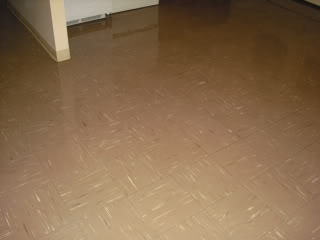

Thanks for your help - Cleaned Update
Went to the local Hillyard location who also helps to fix my TM issues. They rented me a 175 for $20. I bought a Doodle Bug, pads, Cleaner, finish mop and handle, blue floor pad and high solids finish. The total bill was $115 including rental. Job took 4 hours. 490 sqft. Job Gross $515. More than $1 per square. Customer was thrilled and offered me his other commercial business work.
I mixed 8 ounces to two gallons of water in my pump up. (Leaves me with 120 ounces of cleaner yet).
Stripped or cleaned with blue pad.
Vacced up slurry with shop vac.
Rinsed with clear cool water.
Dried it up, and rinsed again.
applied first coat of wax thin with finish mop.
Went and cleaned 1 room and stairs in neighboring town ($125)
Came back and applied 2nd coat.
Dried with air mover tilted up, so as not to create ripples in the finish.
Applied 3rd coat and finished.
This was actually enjoyable, I might even like it more than carpet cleaning. Just have to save up for my own Orbot.
BEFORE
AFTER
BEFORE
AFTER
