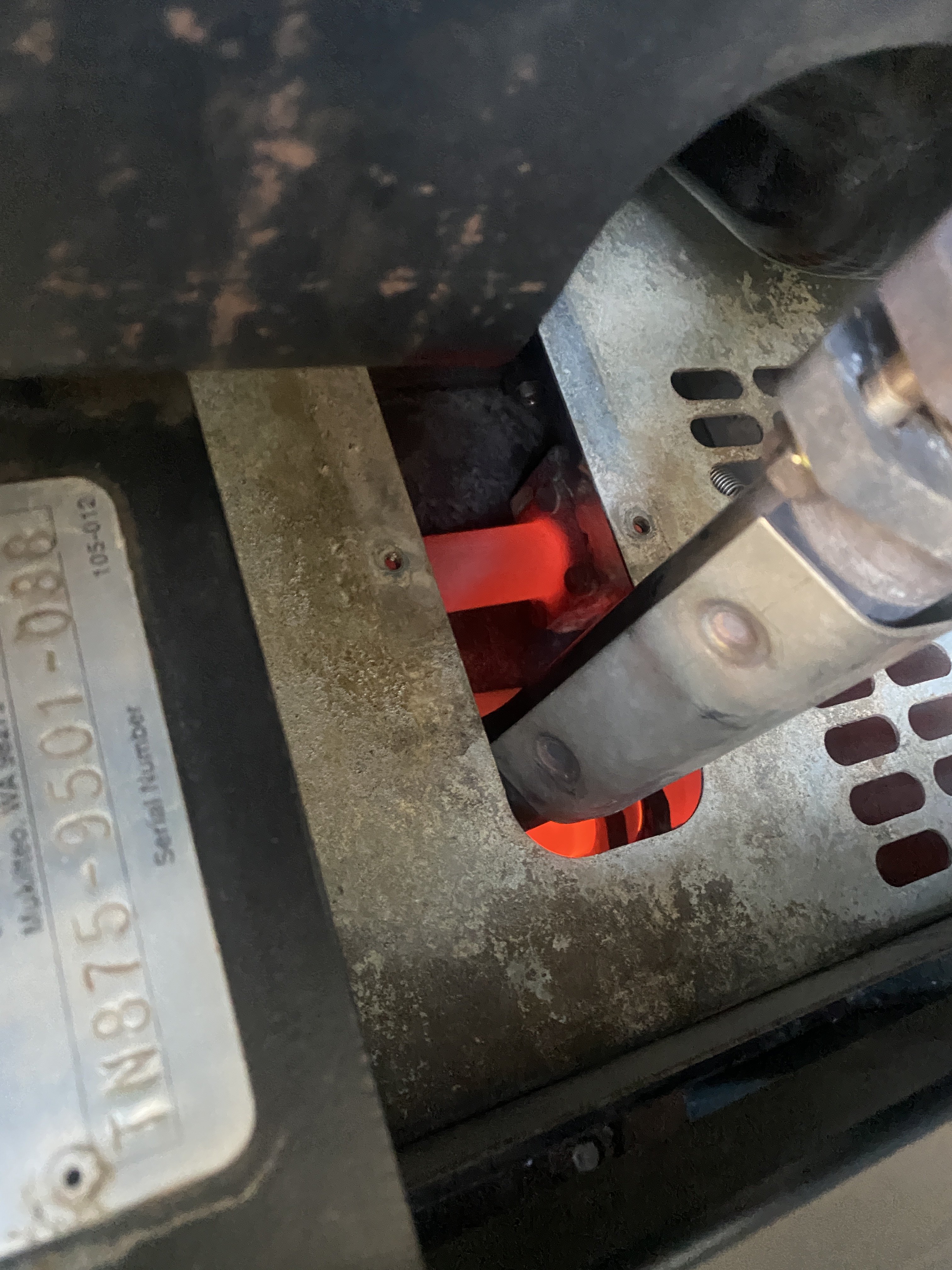

I have a Titan 875 with the gm Vortec engine. 1400 hrs. I also have a Thermalwave same engine same hours but the engine always runs smoothly. The Titan will start up fine and run great for about 20 min then as best as I can describe starts to stumble, bog down or missing. In the past I would just turn it off give it a few minutes start up again it would run fine for a bit . I would repeat this a few times and eventually it would smooth out after it ran a bit longer and then run for hours fine even on some all day jobs. But whenever it would be off for a bit I would go through the same thing. Especially when first getting it running beginning of the day.
a few weeks ago I was having an awful time getting past that usual start and stop till it smoothed out. I noticed the lower exhaust was cherry red diverter valve too and lower pipes . I figured I had a clogged catalytic and taped it a bit and eventually it smoothed out enough to finish an all day job and the exhaust stayed cool. Machine ran fine.
i went ahead and replaced the cat and made sure all the exhaust system was clear of any debris and yes the old caunit was crumbling inside the unit.
I figured this was the problem but on the next use the machine was doing the same thing but it would not smooth out even with the start stop routine. I kept an eye on the exhaust and it never turned cherry red or looked like any overheating.
Any ideas guys any help would be great.
of I was to start it now it would run fine for a bit like new.

Update what looked like a loose plug wire doesn’t seem to be the problem. Quick recap. I had hollowed out the old cat while I waited on a new/used cat. During that time when I ran the machine it still stumbled and ran like it was bogged down but the exhaust tubing including the diverter valve did not get cherry red but it still stumbled like before . I later received a good used cat no debris in it honey comb looked clear I installed it and that’s when I found the loose spark plug wire. I ran the machine today with the replacement cat and the spark plug wire secured. Machine ran for about 15 min smooth then a slight stumble and then the same issue with bogged down. This time the exhaust and diverter valve cherry red.
I think I have two problems . I will take out the replacement cat an see it it fell apart it is a used one so maybe it fell apart and more junk in the system clogging up the exhaust and that probably why the cherry red exhaust. The really need some help .
