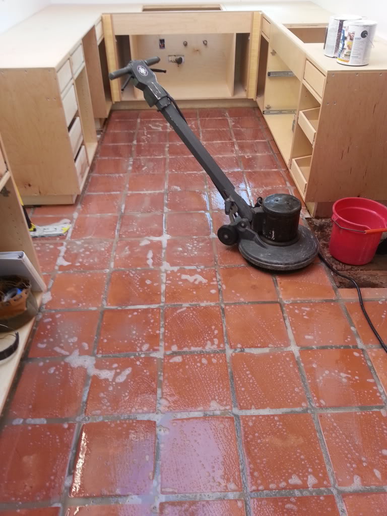

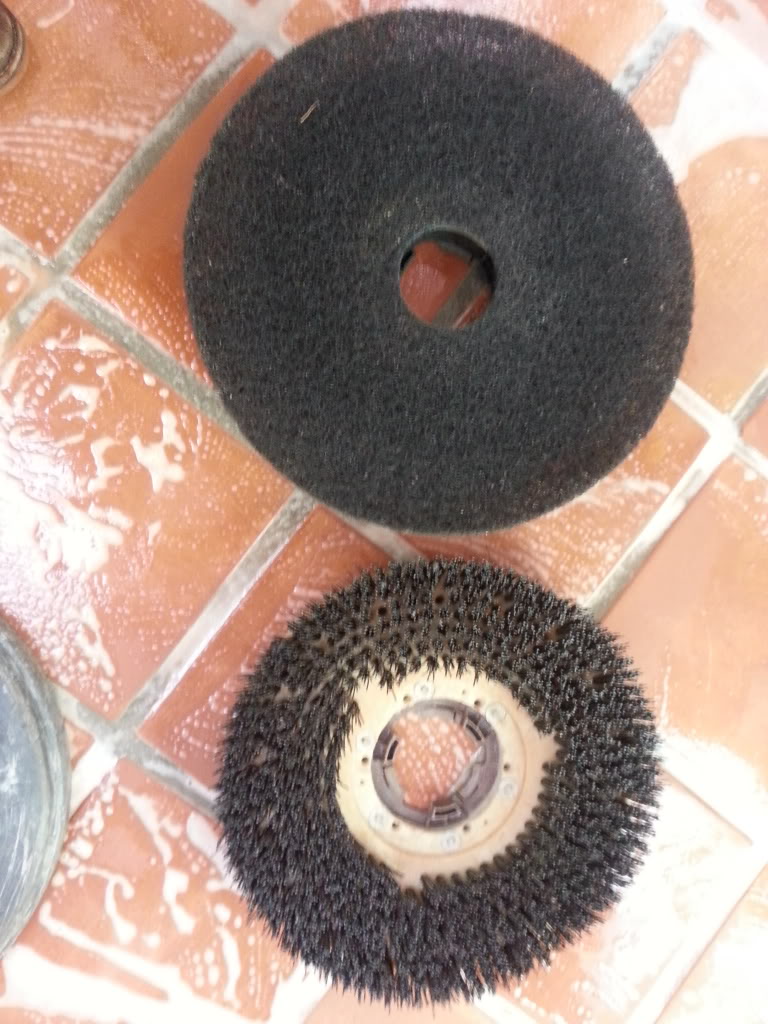

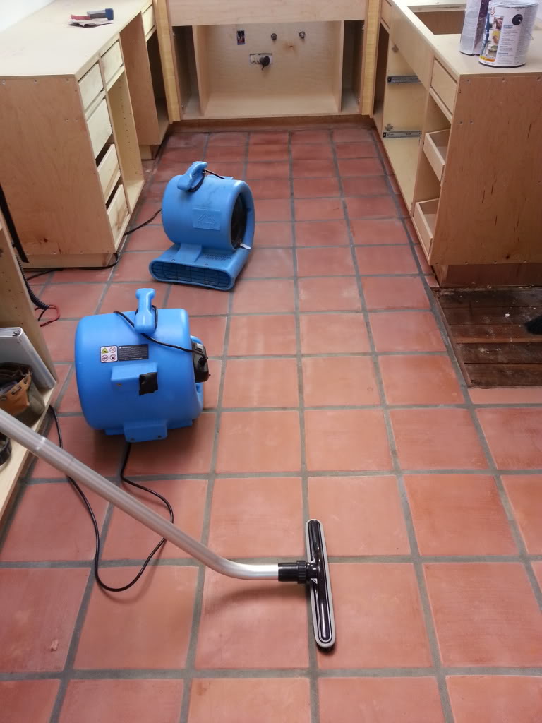

just these 70 or so feet took 2 hours to strip.

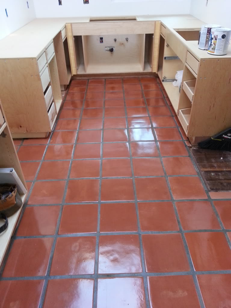

I'll go back tomorrow to apply 4 coats of wax/ finish
pretty much have to charge $10 a foot to make carpet money stripping Saltillo tiles.
20 plus year old floor, never dealt with..

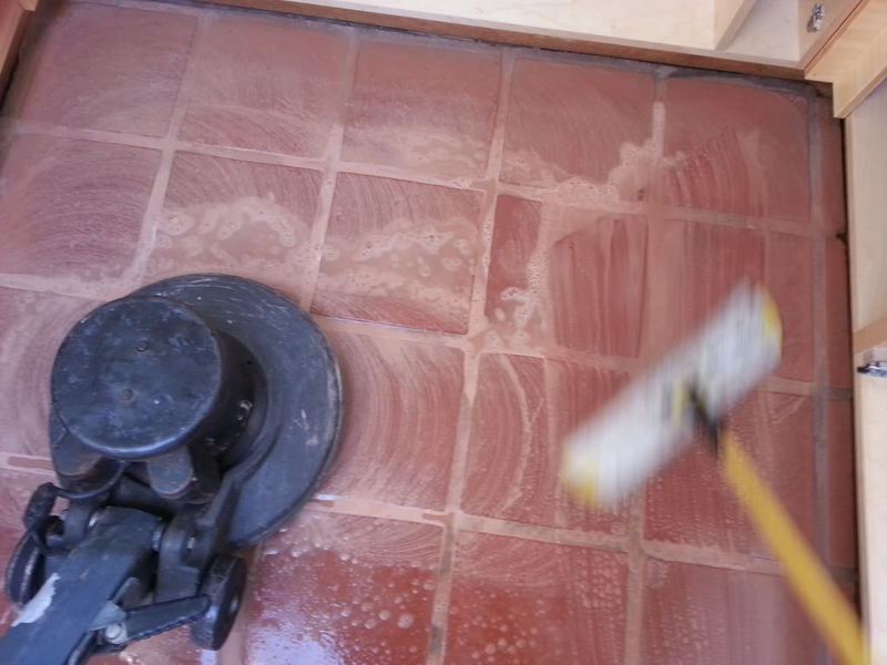

soaking in Zep stripper

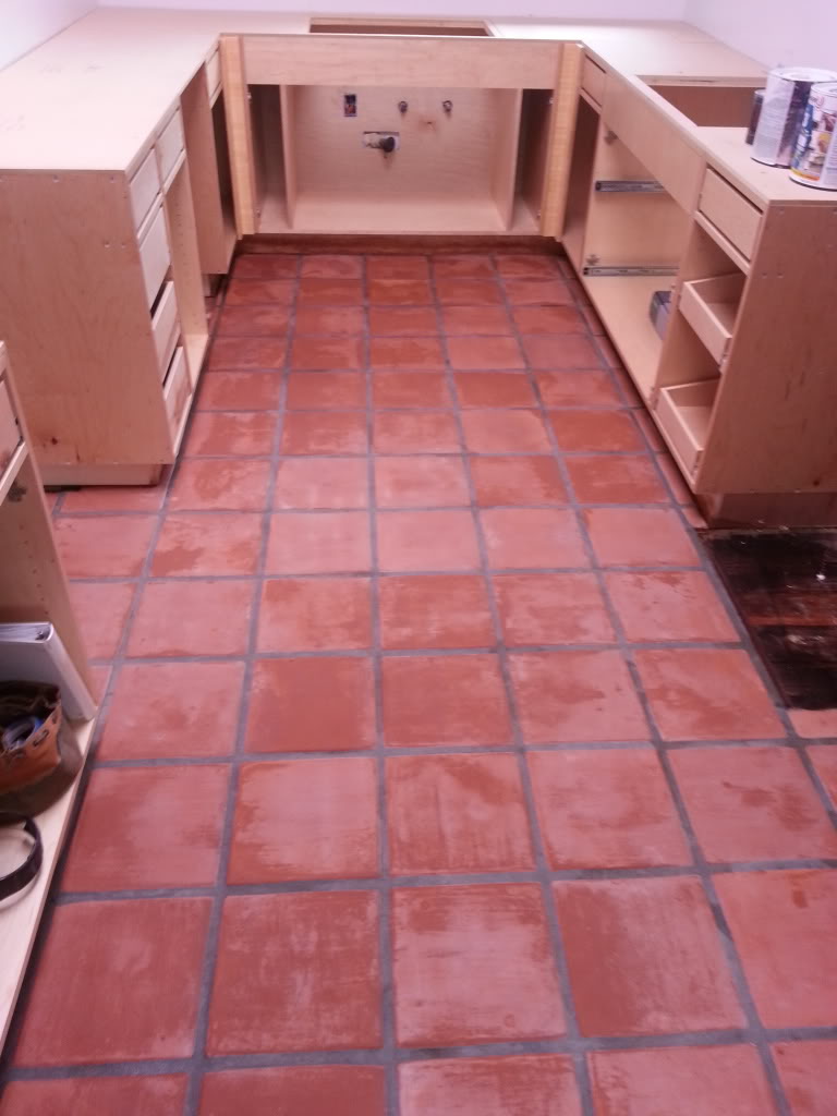

Went over and over and over with a Malgrit brush and a black pad..

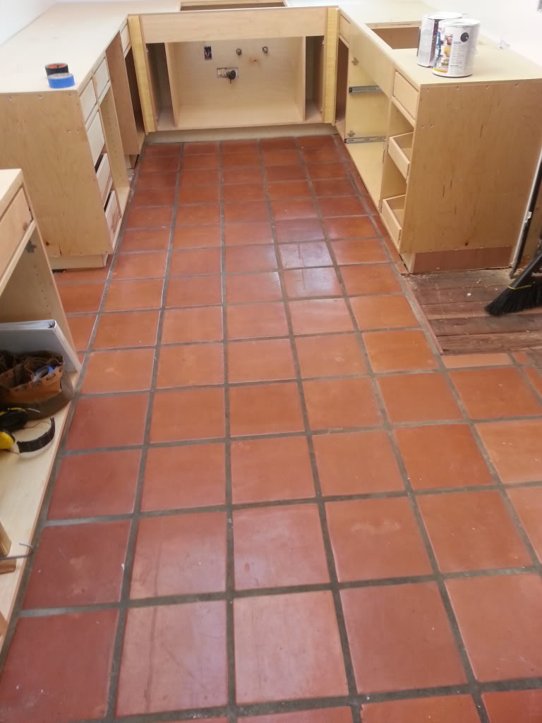

fully naked and drying..

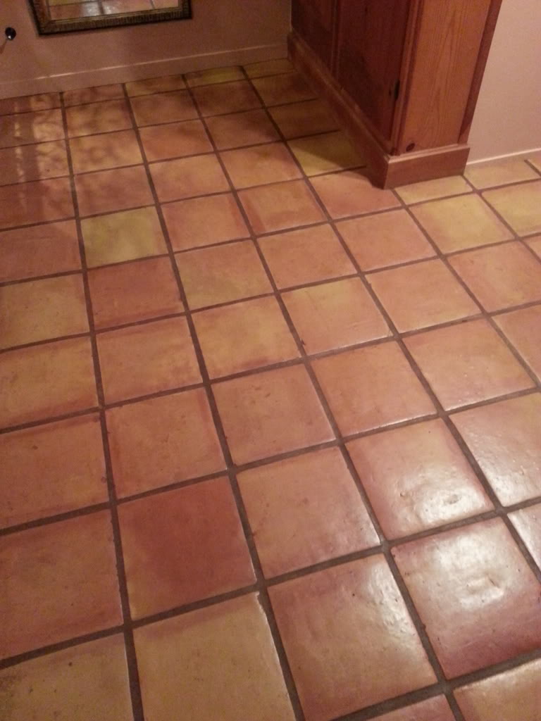

I wish I had fred in my back pocket. Mike I'm not knocking the floor, but with a better finish it would have looked better.
116,353
Fred has nothing to do with MY ability to post a word press blog.
and seven coats of a concrete sealer would have been ridiculous consider the same worn out floor continues seamlessly on to the left of the kitchen.
116,353
let me get this straight, polished marble looks "better" than honed or tumbled?
I guess that explains the bald head look...lol
I personally don't like an ultra glossy floor, and neither does this homeowner..

how do you apply the sealer?
how long will it last? i know a near impossible question but a few years or what time frame?
i just walked from one of these because of lack of experience in them..only see them in fla every 6 months or so.
116,353
flat mop it on Dave.
good finishes self level and dry in 10 to 15 minutes.
thats the easy part.
getting the old stuff off can be a nightmare, especially if different products were used over time. If some idiot put an epoxy or lacquer finish on it, run like hell.
strong stripper, scrub scrub scrub rinse repeat...
