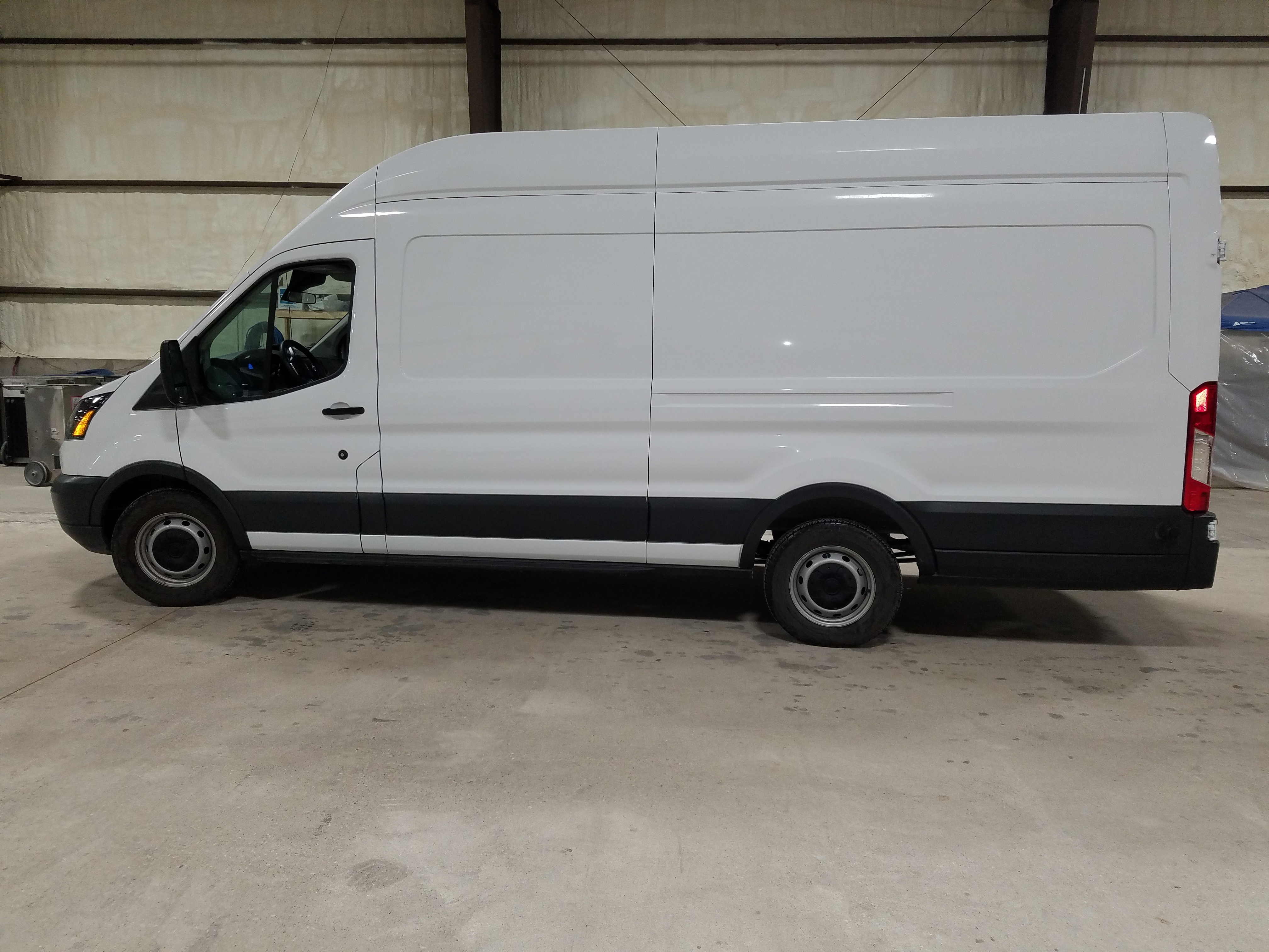

Jerry McMahon
It's even sag.

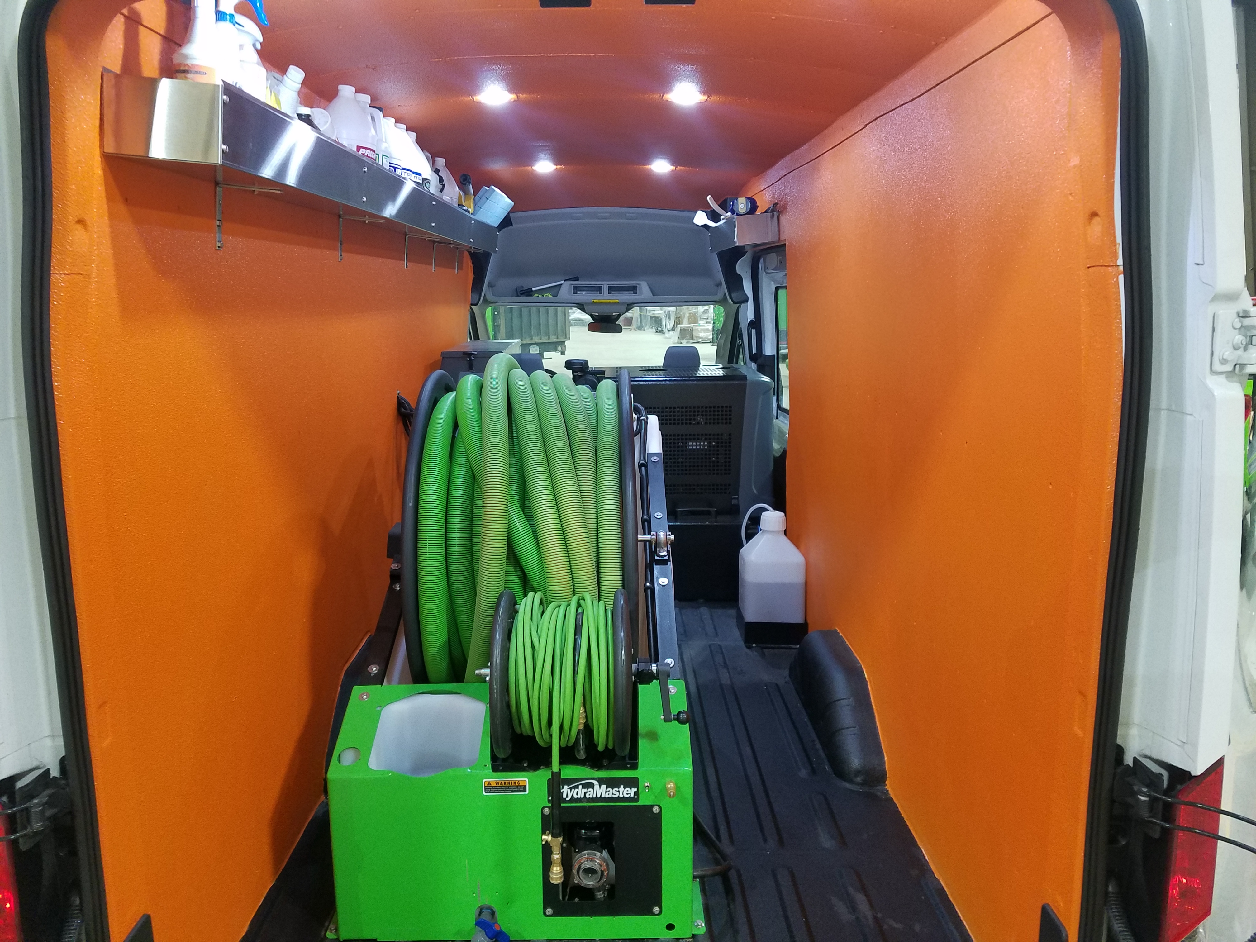

20190412_200645.jpg 20190412_201540.jpg 20190412_203251.jpg 20190412_203336.jpg
FB7777
Too late now, but it appears all the water weight is resting on the rear axle
Side mount probably would have eliminated the sag
On my original 1988 Ford Econoline 150 I had a spring company add a couple leafs. No idea if it's possible or how it would effect the ride

Can you move the water tank back to sit right over the axle or move it to go out the side door? With just your tank and hoses you have half of your payload sitting behind the rear axle. If you ever get the van swerving the back end will come around on you and flip it. That is why they outlawed schools from using the Ford extended vans to carry students.

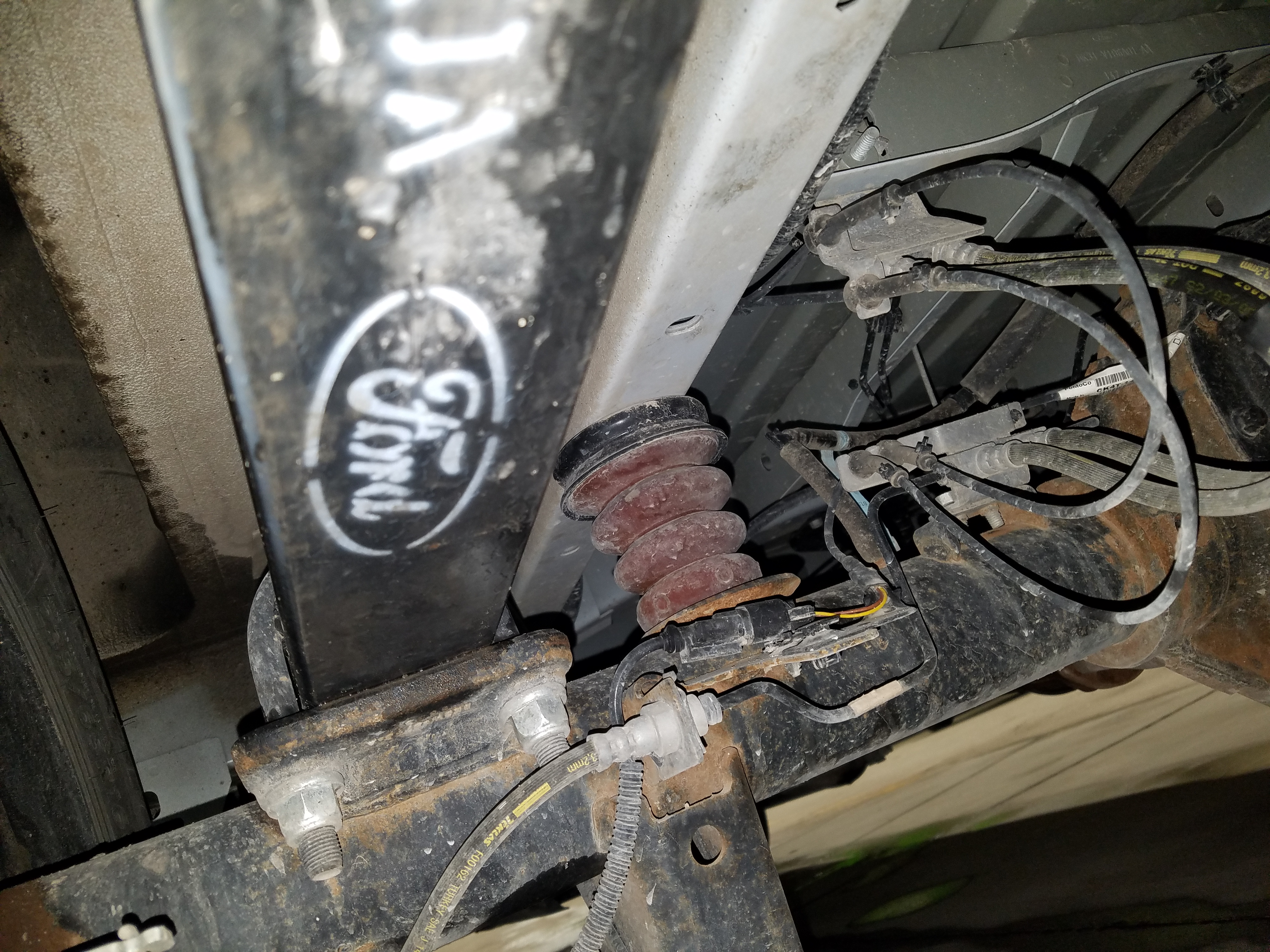

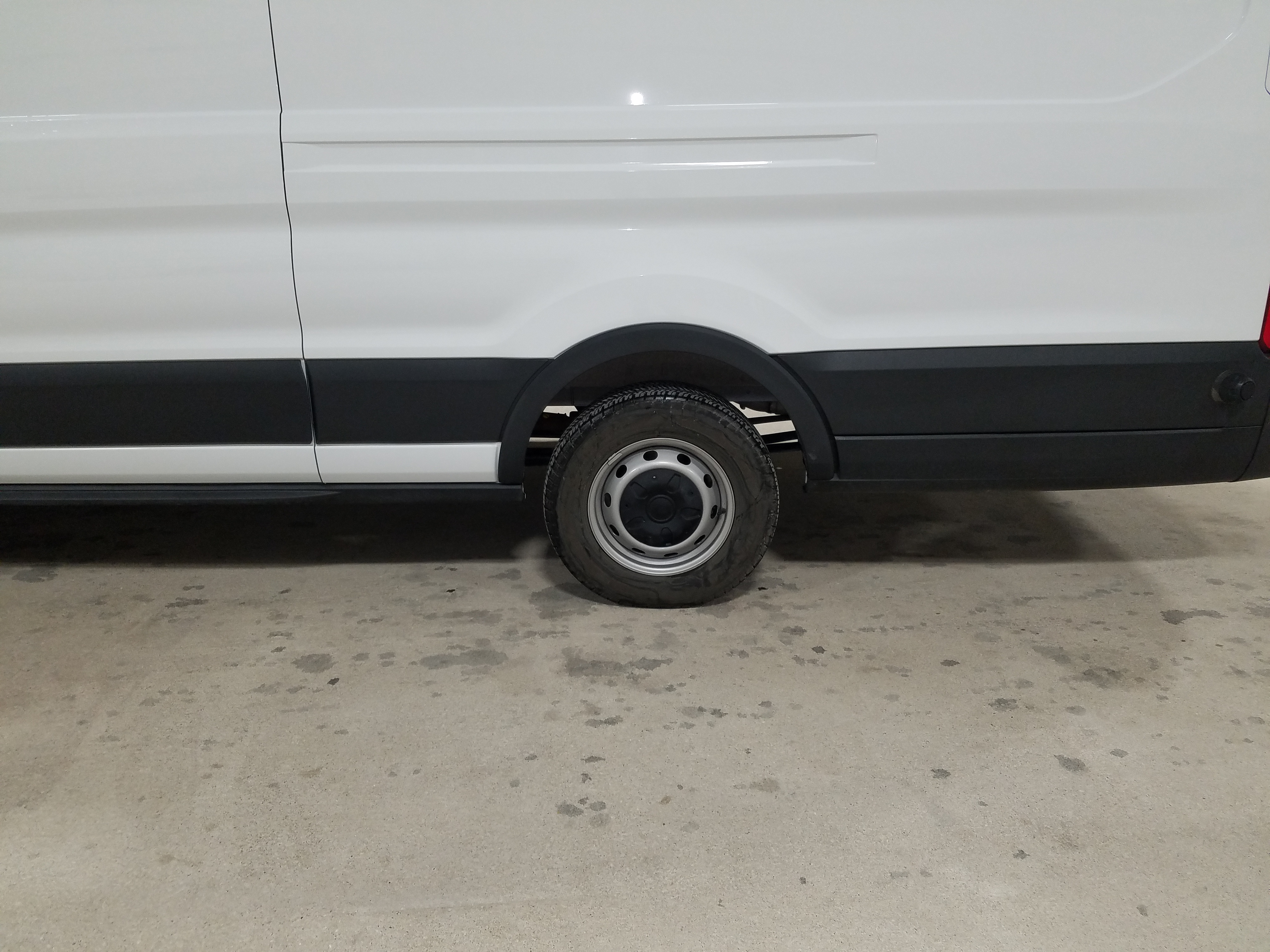

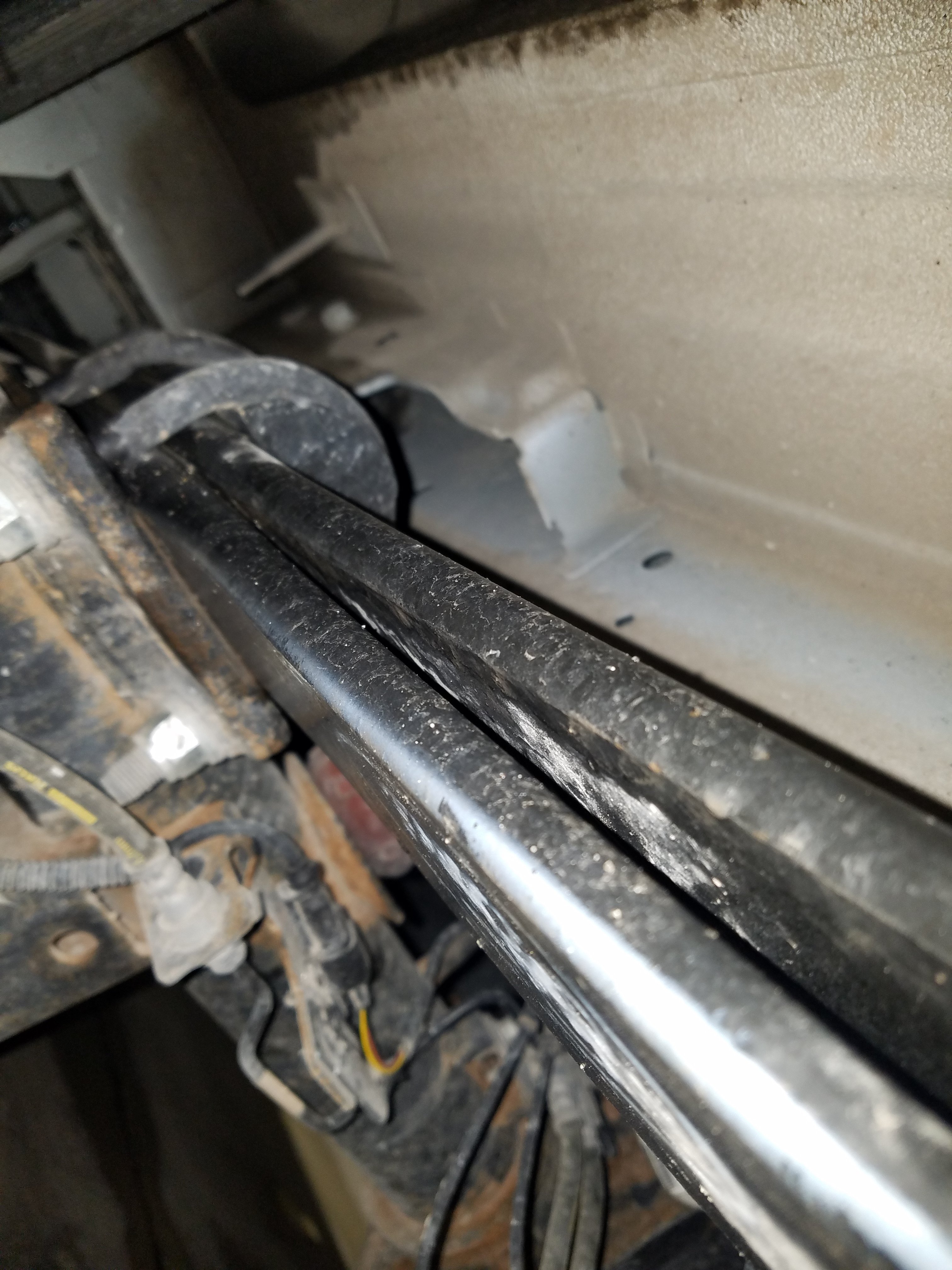

Ended up putting bigger springs in. Much better, I think it's sitting about where it was stock and this pic is with 120 gallons in there.
Still gonna remove the Hydra Cradle. Taking up way to much space, I can't get all my stuff in there.
