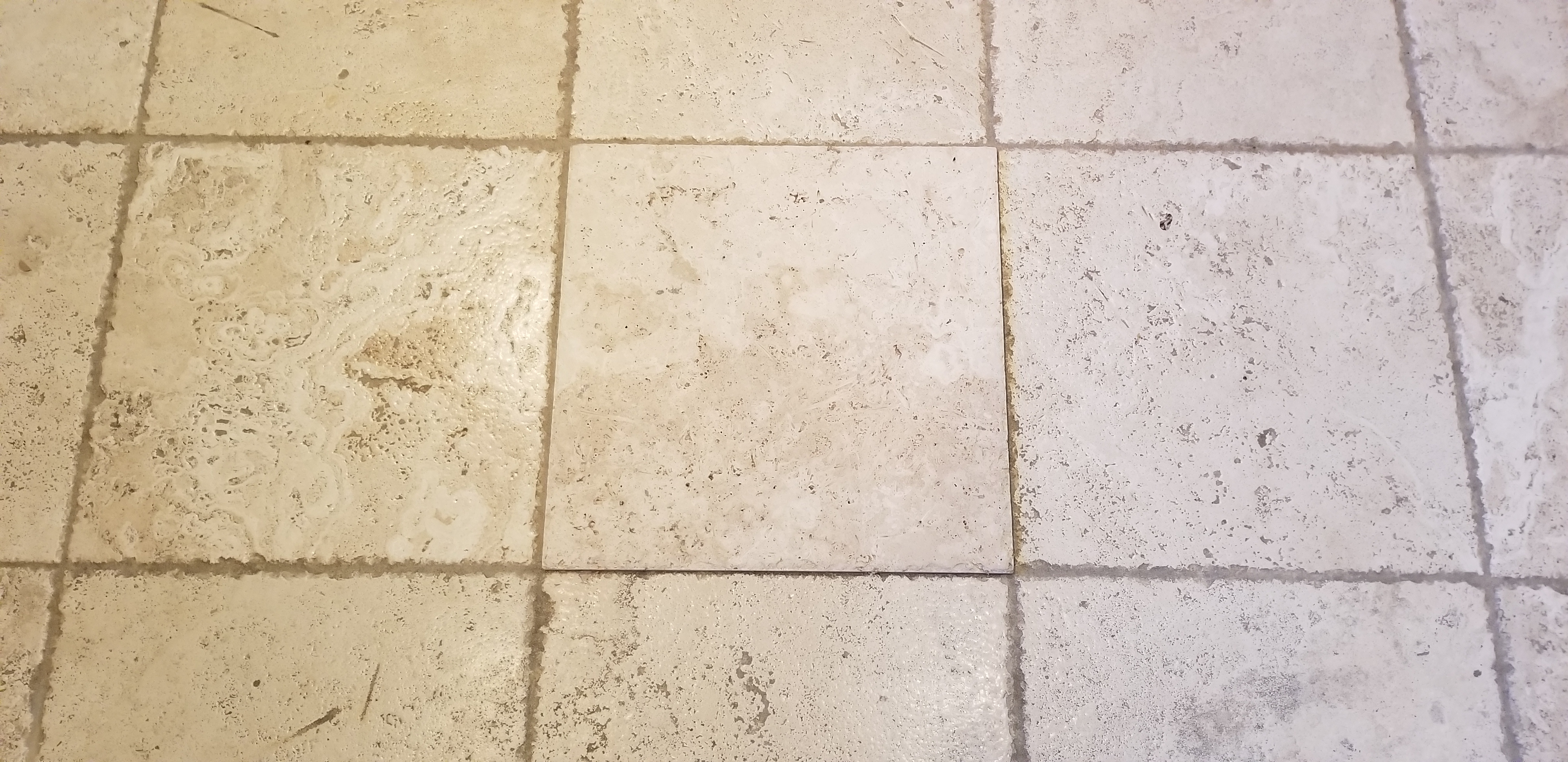

Had one travertine all streaked in even rows.
The previous homeowner had used a portable hard surface cleaning machine like a small homeowner hoover.
We are not sure what was used but anticipate vinegar water possibly.
Was a mess. They didn't want to spend money to fix it and I really didn't want to tackle trying to fix it.
116,351
I looked at this polished saw cut today.
Grout and fill was never sealed so I suggested Colorsealing for a perfect job.
Spare tile in center to compare polishes..
