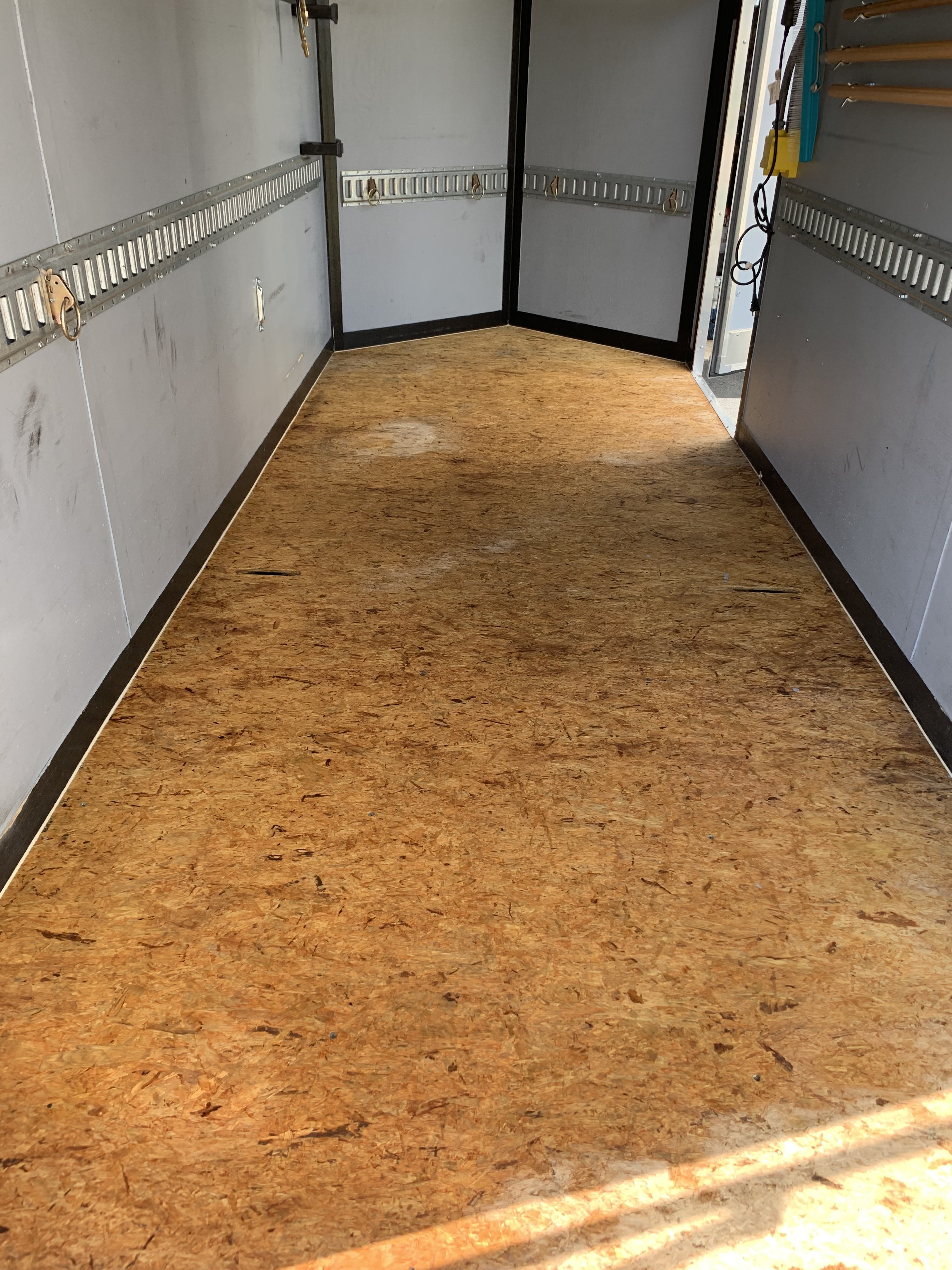

Good afternoon cleaners, I’m looking for some help. I’m mounting a truck mount in a 5x12 enclosed trailer. I can’t afford a van yet, so this is my option. My question is, what layout has worked best for you, and things you’d change. My machine will sit centered facing the rear. If you have pictures of your set up I’d be grateful. Thank you for the help.

Facing the rear is your first mistake. It wastes a huge amount of storage space. If you need more than 5' for the tm, consider moving the waste tank to the side of the tm instead of behind it. What kind of truck will be pulling it?
I had my tm in both the side and rear
14,632
And will you be painting the floor to protect it from moisture?
10,175
I actually have my unit facing the the side door but offset so my hose reel is directly in front of the door. The waste tank sets behind the unit and drains out the side door. My fresh water sets beside my unit sitting the width of trailer. The water sits in middle of trailer. So it’s all in the front of my 6/14 trailer so I could haul floor equipment if needed.

I’m pulling it with a Toyota 4Runner and I have painted the floor, that was an old pic. So It would be better to mount the machine coming out the side door and hoses out the back? The problem is that the door is pretty far forward and that will put a ton of tung weight.

Why not mount it just forward of you axle? But with the arse end over the axle to centralize the weight?
It's going to get pretty warm in there, do you have any plans for extra ventilation?
I'd also look at plumbing through the floor, as well as access for oil change if needed, via the floor.
With you solution & waste hoses, I'd be looking at small portholes that hoses can pass through, and locked on the inside when not in use.

Yeah, since you pulling it with a 4Runner, the only option is to mount it over the axle facing the rear. Put your chemical shelves in the front and try to squeeze a fuel tank outside on the front tongue right in front of the nose of the trailer box

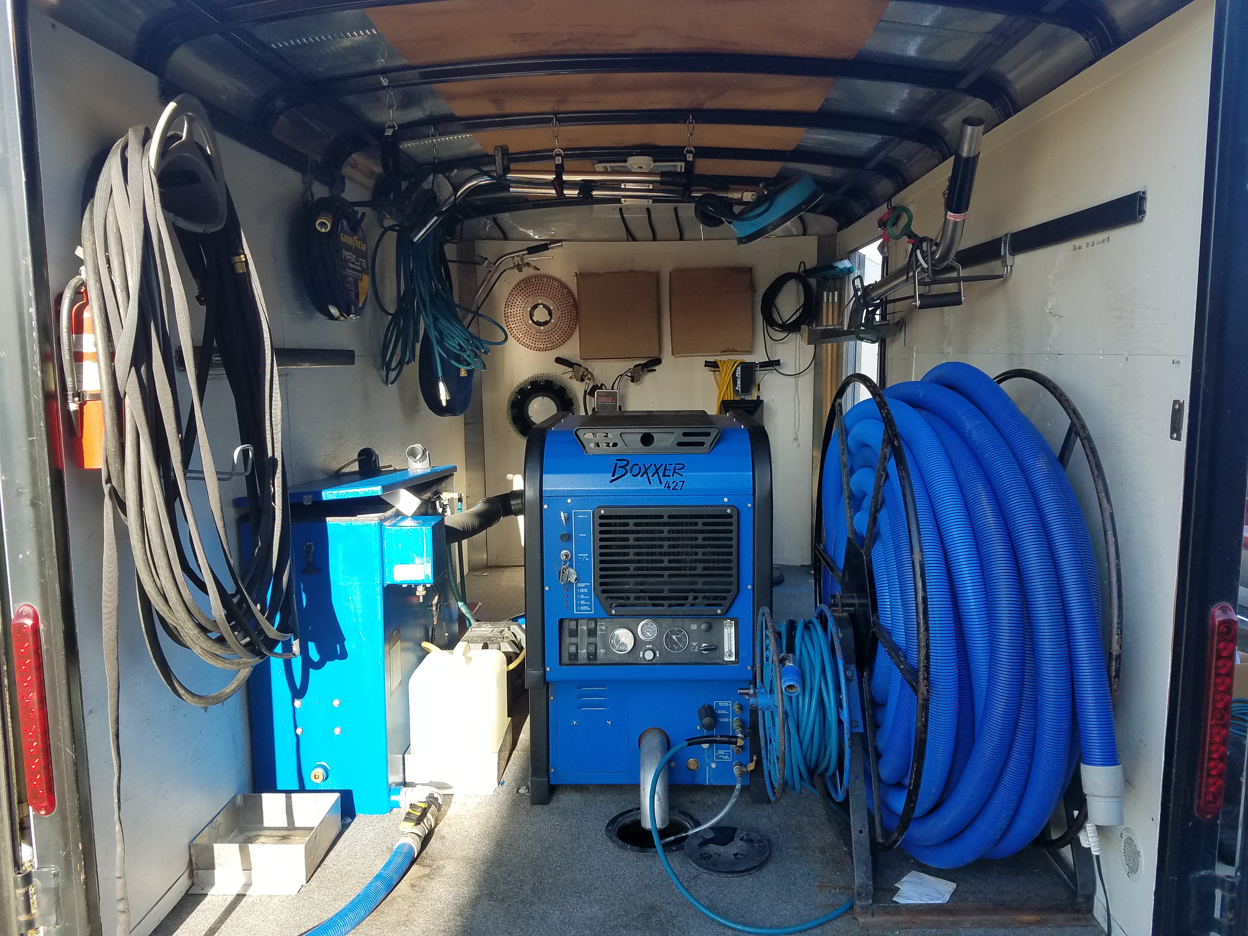

This is my trailer setup. I wish my machine was mounted out the side door and that I had a rear ramp instead of barn doors. Not sure what your climate is but insulate it if it's cold in your area. I also like this setup for my exhaust. I can leave it run with the doors closed if it's super cold but when I have it shut down I can just close up the exhaust hole and not worry about cold air going up the exhaust and freezing my heat exchanger. I hope this will give you some ideas! Nothing more exciting than finally pulling the trigger and getting your setup put together!
