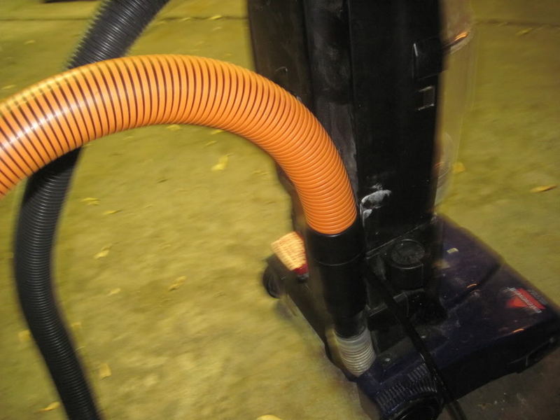

The OBVIOUS fix for two of the turbo problems (trash killing impellers, and TM vacuum turning it too fast) is to split the airstream.
Run NO recovered material thru the turbine. Run just enough air thru it to power it, and pull the remainder from the floor opening. A simple "governor" would keep its RPM in the safe range. Then the TM could rock and roll.

Sorry for the Crude Image but Lee is this what you were KINDA of invisioning??
