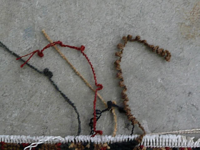

Harry Myers

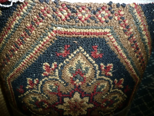

This is a frame in the Wilton notice the different colored yarn. This makes 5 different color making this Wilton a 5 frame Wilton.
Harry Myers
Oct 13, 2007
1,268
Harry Myers

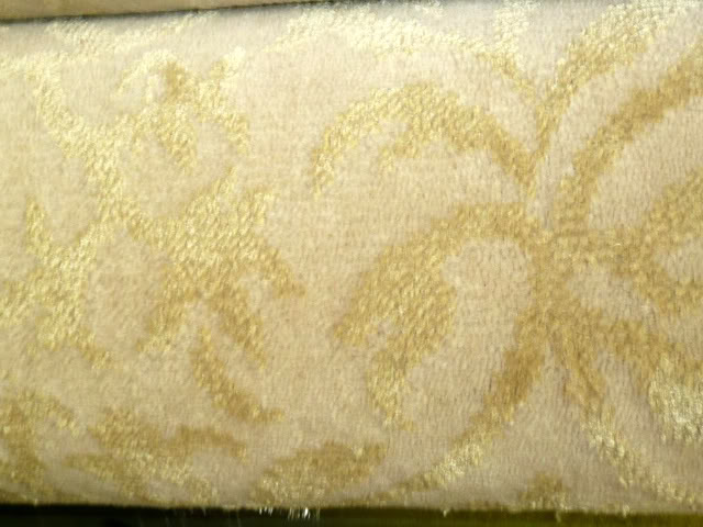

Cut pile wilton
Wool and linen material . It takes a Jacquard mechanism to produce this pattern. I would and should know just by looking at it this can not be a velvet construction.

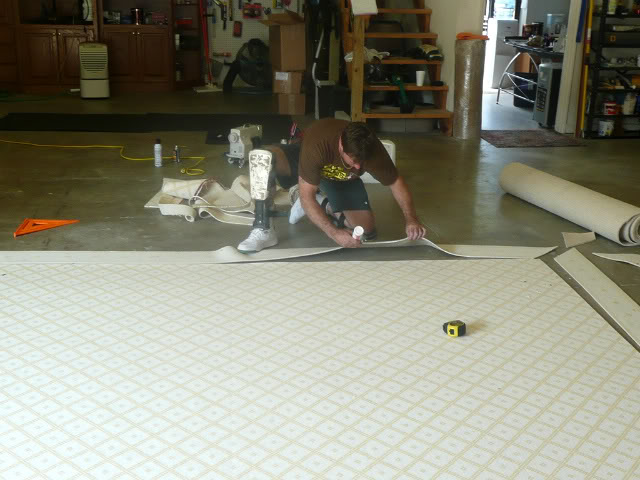

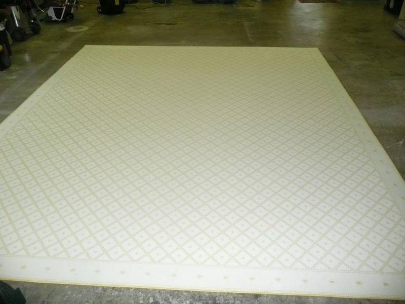

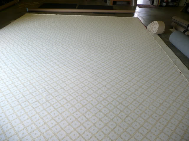

Wilton area rug in the making
Here is a Wilton are rug in the fabrication process . Just started late in the day. Will finish it tomorrow.
Harry Myers
Oct 13, 2007
1,268
Harry Myers
After laying out the border. Figuring on size. Visualization is most important on fabricating. You just don't want to have your cuts anywhere. Step 2 is preparing for your hand sewing. Sealing the seams.

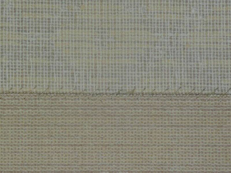

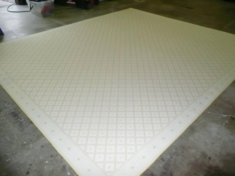

Harry Myers

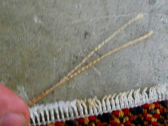

OK . I did finish the rug today. i have to seal it. and bind it. OK Gentleman and ladies. If so. When hand sewing the furthest point of entry is 1/2 on each insertion. So if there is a . So this means in every foot of sewing there is approx 24 stitches. So in the 12 ft span there are 288 stitches . 14 ft side equals 336 . So with the miters there are approx 1300 hand sewed stitches.

Harry Myers
OK the construction determines what we are working with notice to the lower left we see the 2 chain yarns. Also to the right we see 2 filler yarns. In the middle we see 5 different colors. This is the dead yarn or yarn fillers in the wilton . I siad it already material like this is hand sewed only. Never mind expensive as you know what. Question are welcome this is how we learn.
