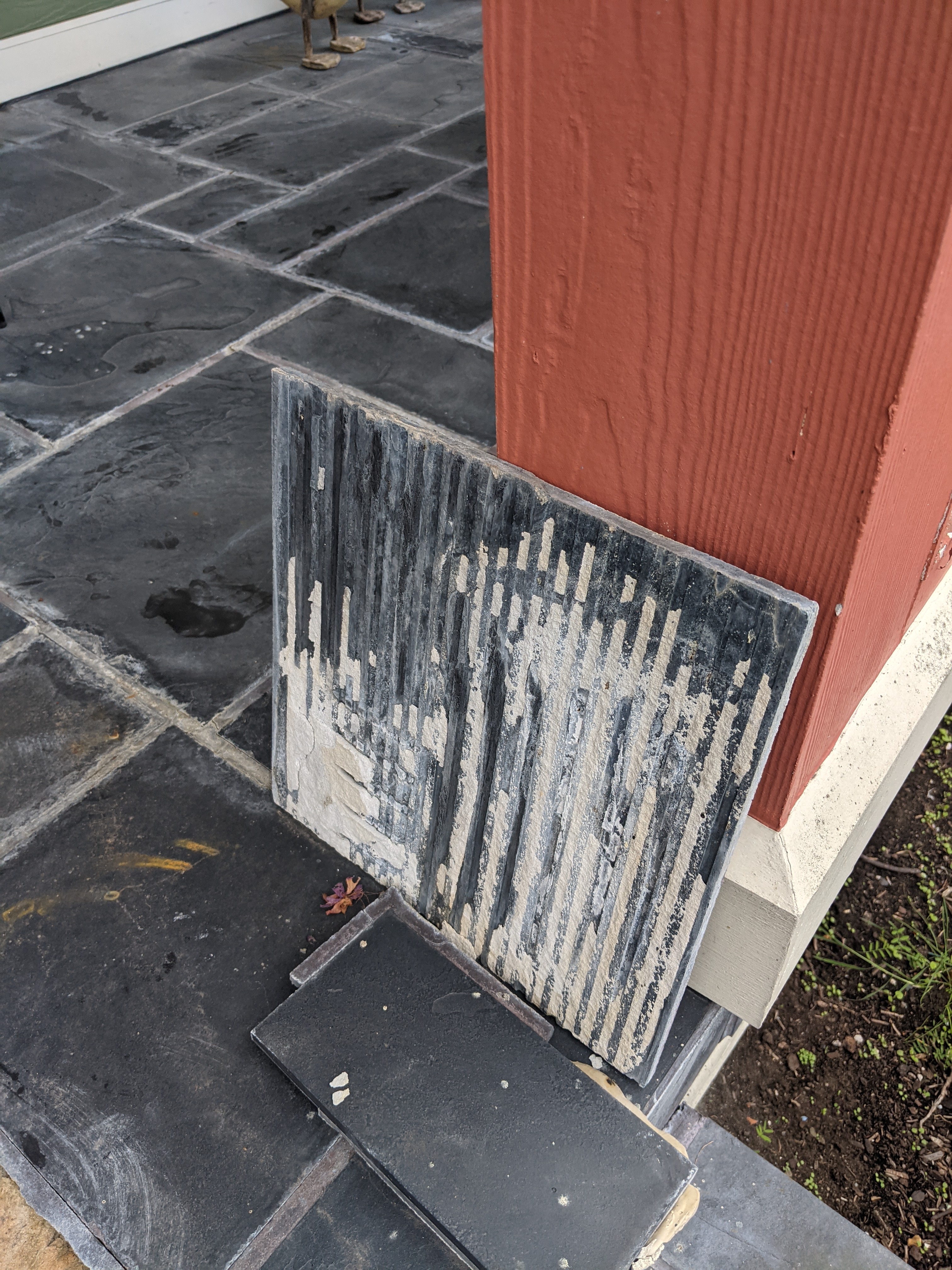

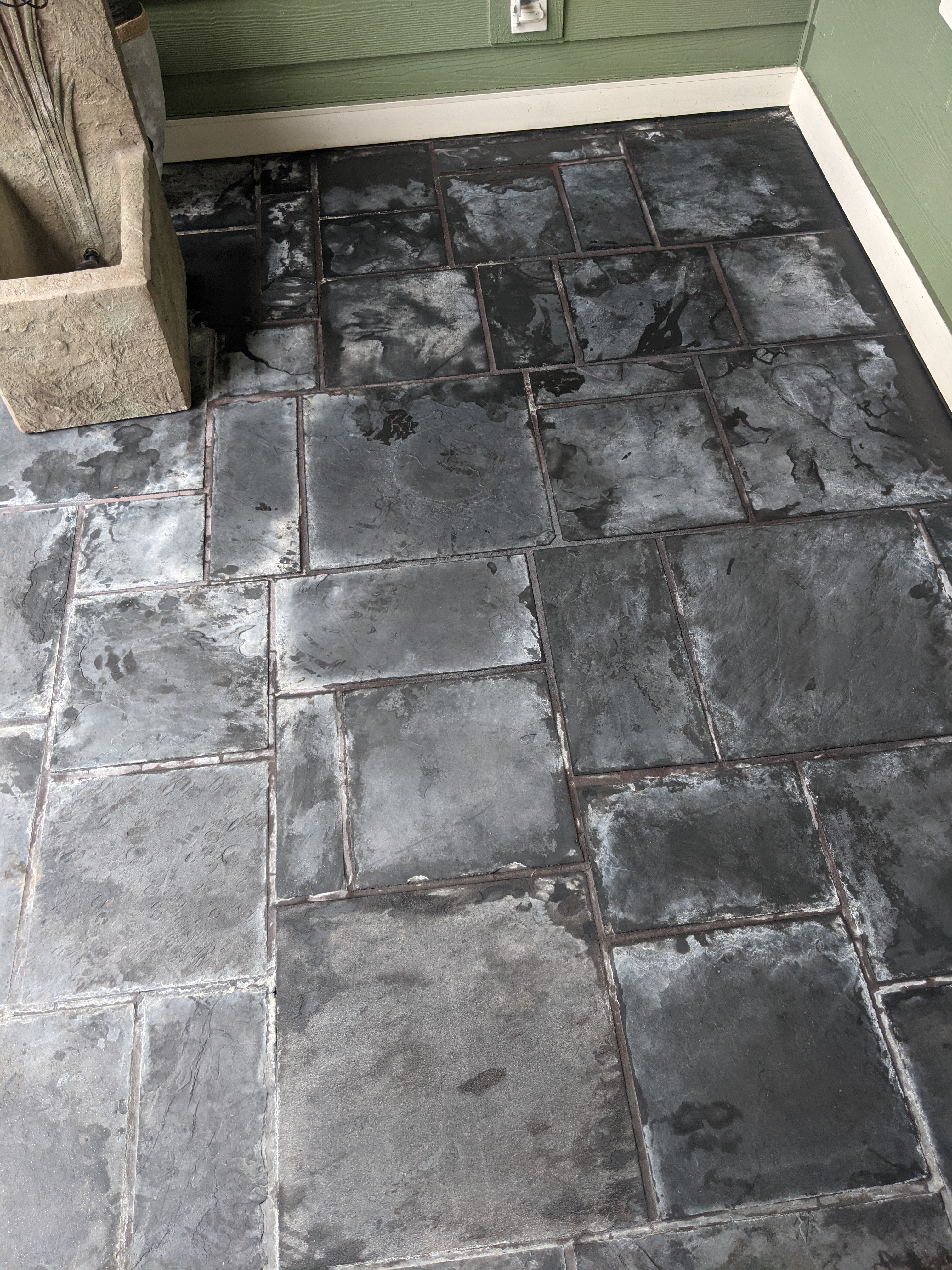

Well, I acquired and applied the F9 and it works better than Proschoice acid but the final results suck. 1. I either need more dwell time, but I left a puddle on one tile and it did not work. I am going to throw in the towel, except! 2. I think the thin-set is the culprit. How to cope with that is an unknown. Look at the images and tell me what you think. 3. Straight muriatic acid??

I told the customer I was going to apply straight muriatic acid. If that fails, I give up. I cannot believe an acid cannot erase this shit...unless it's the thin-set with adhesives engineered into it. Does anyone have any insight?

You're only going to make it worse, water creates the efflorescence, acidic or otherwise.
