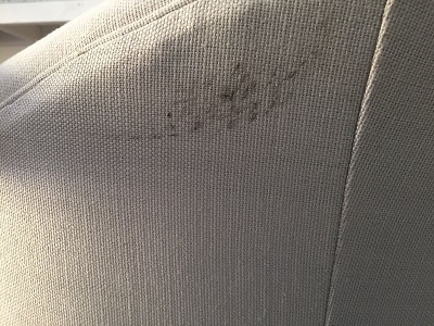

Furniture stores are a great source of referral business for fine fabricare upholstery cleaning services. However, its unlikely that they will take your information and daily share it with their prospects. Simply put, upholstery cleaning is not even on their radar on a daily basis.
A big problem that they do have is “delivery damage”.
Even the most careful delivery personnel can rub the furniture against the doorway of their truck or the home, and when that happens, soiling will be present, much like you'll see in this picture:
"This is a common problem that furniture retailers and movers experience"
This may look like a simple spot to remove, but unlike carpet, removing spots from upholstery can be very challenging, even risky!
What problems could a cleaner face when asked to remove this spot?

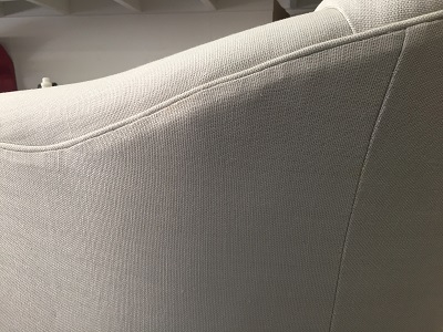

If this is a claim for a new item, perfection will be expected. Apply, blot, rinse, and dry until the spot has disappeared.
"This is how your work should look when you are done"
Practice this type of spotting on fabric samples that can be picked up at your local upholsterer, who should also be another source of referral business for you. Learning to remove spots from new fabric and not leave a trace of your work is a skill worth learning, and it will build your reputation as the fine fabric care expert in your market place.
