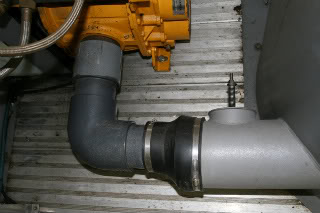

Greenie was correct...dirty it was..........this stuff was caked on....so it would not seat tight...
so I cleaned it up as good as it would come off...
I tested the spring with the new one and it seemed like the old one had a little less resistance..but not enough that I felt it would do any good to change it yet so I put the old one back on...
when I took it off some crap fell in the pipe and so I figured I would take the pipe and the elbow off and clean it out...the elbow that went down was not even seated into the rubber boot..you can see the white marks where they sanded it down to fit the rubber sleeve and that was all that was attached........
I don't know why it was like this ( might explain the tape that was on it ) and I have never noticed it really giving me a problem...but it looked like from the air marks on the inside it has been leaking....
they had the rubber sleeve all the way down on the nipple ...........but there way plenty of room that it could of been lifted so the elbow could of sat in the right way..
so I lifted and adjusted it and sat the elbow all the way down so it was tight on the rubber sleeve....
started it all up and sat the RPM's at 1500 and capped off both vac ports and the HG's shot up to 15.5
vac relief is nice and steady again and it even sounds smother.... so I probably had 2 problem not just one...
the vacuum relief and the elbow not sat the right way....

It was really not that hard...but take the whole assembly out because you will need to clean the bottom of where the plunger seats not just the plunger.........I measured the distance from the top of the plunger to the top of the nut for distance.....and after I was done and ran the truck I turned it a few turns tighter.....and that pretty much bottomed out the threads........
