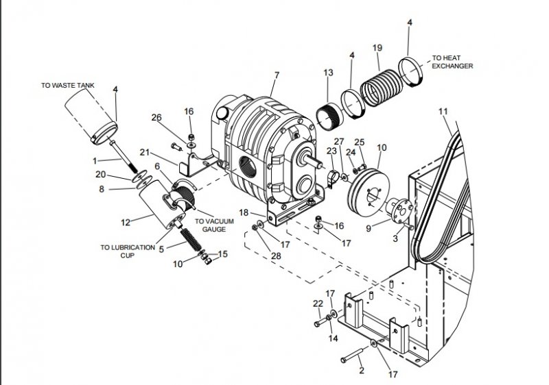

Example: On this prochem legend you can see the relief is directly on the inlet side of the blower....the blower is protected from clogs anywhere else in the system
Many, if not most, are not done this way but it is still the most correct way to do it as it provides the most protection to the blower
27,898

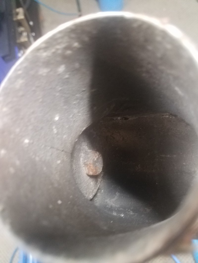

Lee is right in saying if the blower filter gets fully clogged, there is no vac relief protection for the blower. At the same time, looking at the common configuration above, if a piece ever comes apart on the vac relief it will destroy your blower. I prefer to have the vac relief on my waste tank and I clean my filter regularly. I was looking at several truck mounts that came up for auction a few years ago from a company that went out of business. On 1 machine, the pre filter lint basket was clean but the blower filter appeared never to have been cleaned and had collapsed in on it self.
Able 1
Apr 12, 2008
6,469
Wi
Keith
Actually it would be close to impossible on a prochem.. Just a bolt and a washer.. Unless you think the head of that big ass bolt is going to snap off at 15hg..
